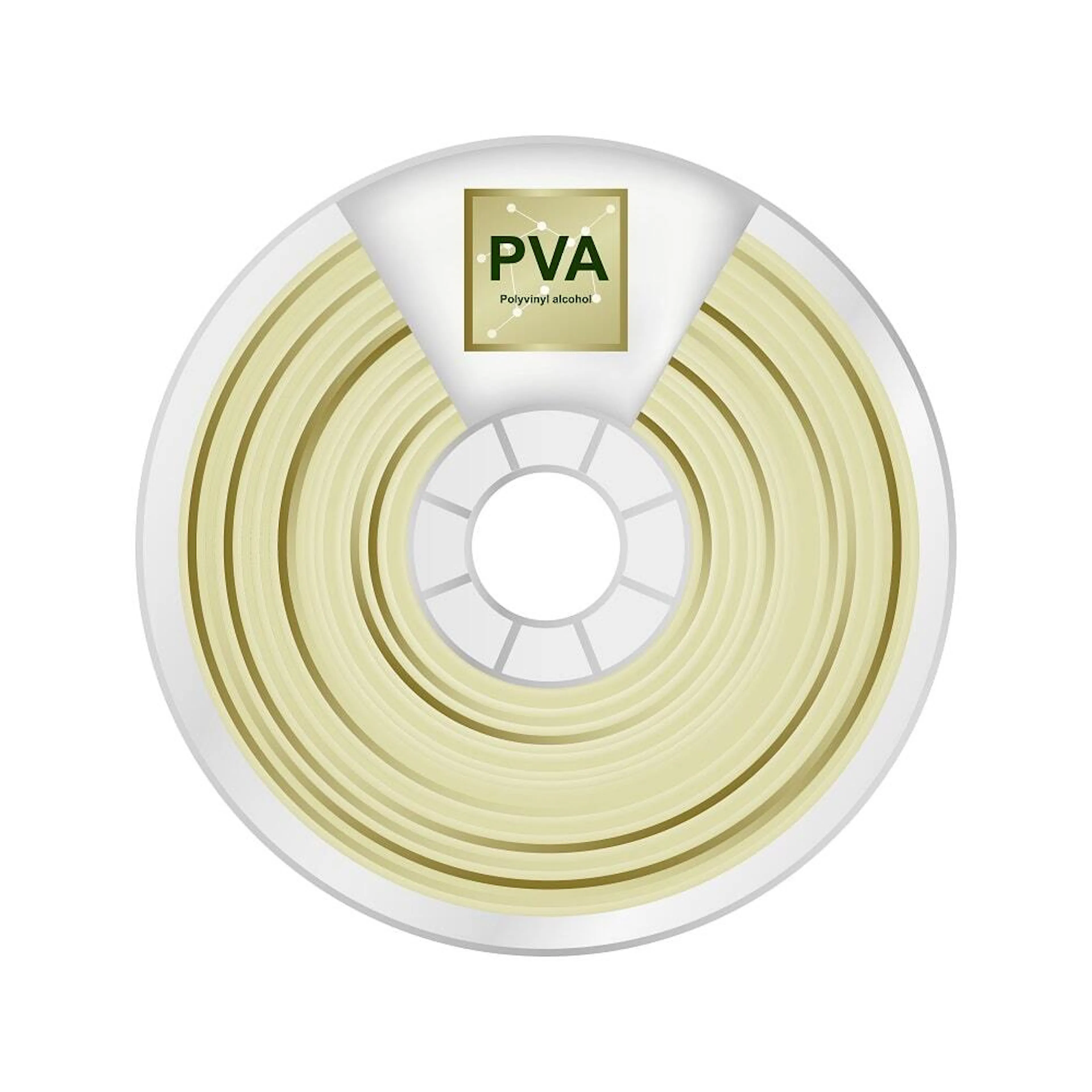

In the 3D print sector, PVA 3D filament (polyvinyl alcohol) is a critically important family of materials. Its water solubility is very valuable because it allows support scaffolds to be printed on dual/multi extruder machines and later removed with ease. PVA offers several useful characteristics that make it almost perfect as a support material. These include: high water solubility, high stickiness in the melted state, and a print temperature range of 180-210°C.
PVA was first produced by Fritz Klatte and patented in Germany in 1912. Initial commercialization occurred in Japan in the late 1930s, with the Kuraray company producing low-cost Vinylon and Kuralon fibers. These came in various levels of insolubility and each fit a different application. Some of the PVA fibers were made to: modify concrete, reinforce rubber, or enable fiberglass to better resist shock and shrinkage.
PVA’s basic form is powder. The 3D print filament is formed by melting and extruding that basic material. This filament is very uniform in its properties and is sold in packaging that prevents exposure to atmospheric moisture. Such exposure would degrade the material and make the filament rolls congeal into a softened mass. This article will further discuss PVA 3D printing filament and examine its composition, properties, and recommended 3D printer settings.
