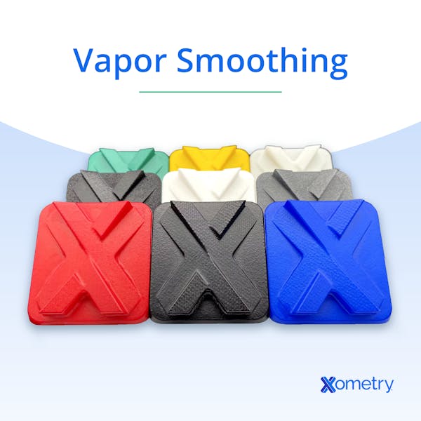

A photograph of vapor smoothed nylon, a material available at Xometry.
