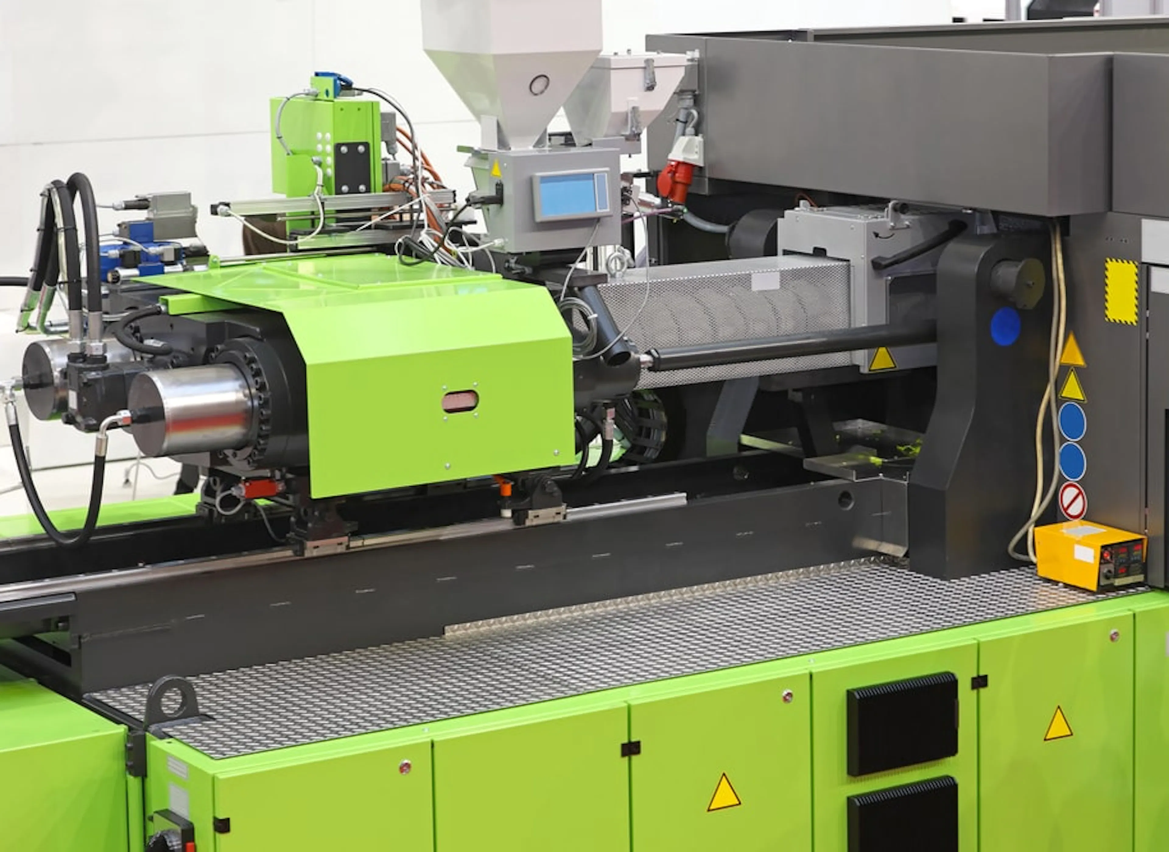

An injection molding machine. Image Credit: Baloncici/Shutterstock.com
Injection molding is only possible thanks to the plastic injection molding machine. Plastic injection molding machines combine material feeding, melting, injection, and ejection in one condensed space, and allows for the mass production of products. This article will discuss what are the different types of molding machines, what are the major components of injection molding machines, and what are the common uses of injection molding machines, where to buy injection molding machines, as well as the expense of plastic injection molding, and whether it's easy to maintain plastic injection molding machines.

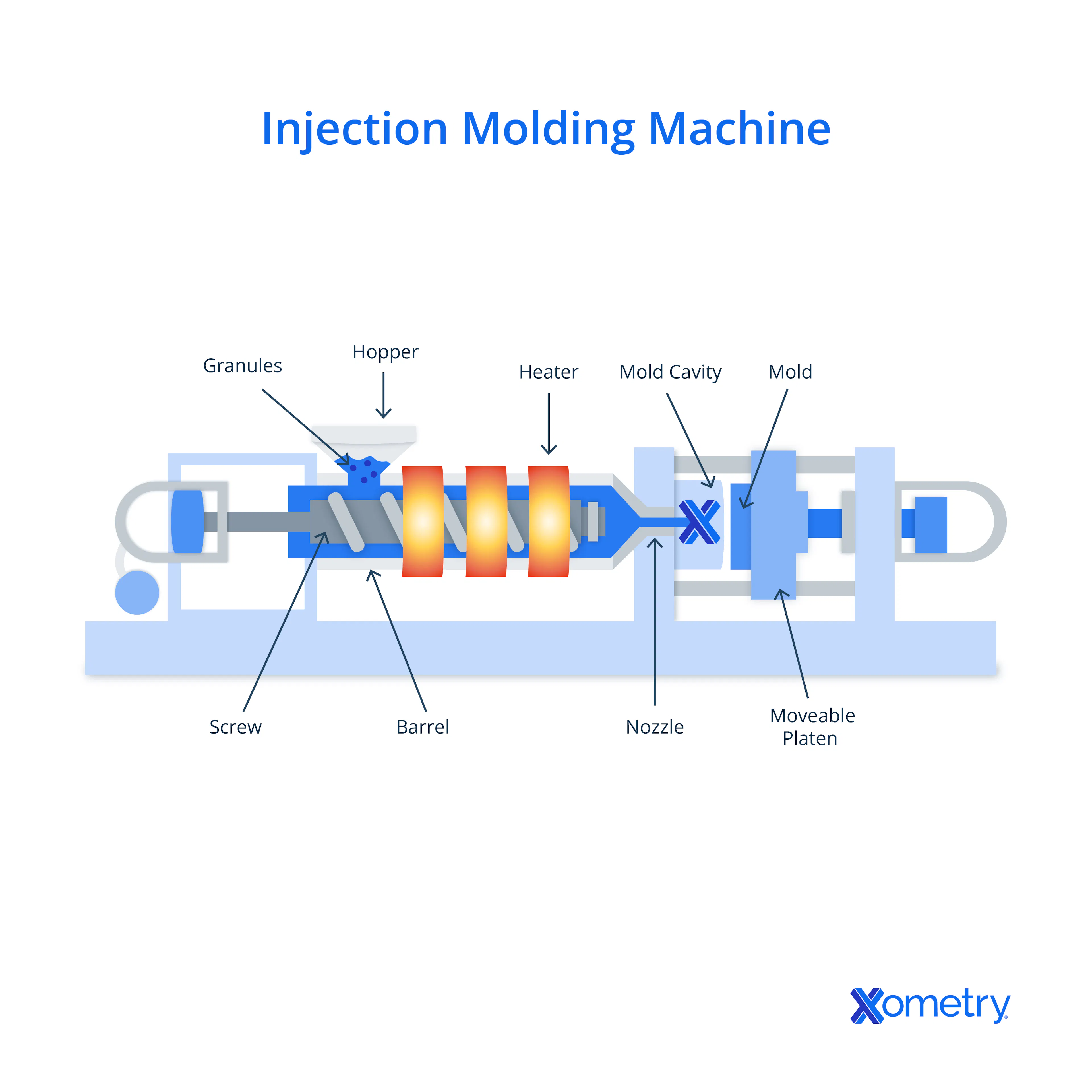

What Are the Major Components of Plastic Injection Molding Machines?
Regardless of the type of injection molding machine, they all contain some basic components that are used to produce high volumes of plastic parts.
Below is a brief list of the different parts found in the typical injection molding machine. Note that model-specific parts will not be highlighted to provide the most inclusive summary for injection molding machines.
  • Hopper: The hopper is essentially s large funnel that accepts stock material and feeds it into the machine.
  • Barrel: The barrel contains the reciprocating screw and is the outer housing of the machine. The barrel is wrapped in heater bands and is tasked with both containing the material and the heating portion of the cycle.
  • Reciprocating screw: This is the corkscrew component that moves back and forth with every cycle (powered by either an electrical or hydraulic drive system), conveying material through the heating sections, through the nozzle, and ultimately into the injection mold.
  • Heaters: The heaters supply thermal energy through the barrel, converting solid plastic pellets into molten plastic as they are pushed by the reciprocating screw. Heaters allow for precise temperature control and are usually staggered in temperature for gradual heating.
  • Nozzle: The nozzle dispenses molten plastic from the barrel and into the mold cavity. The nozzle usually sits within a depression in the mold known as the injection mold bushing and is heated to ensure that the plastic does not lose temperature before entering the mold.
  • Mold: The mold contains the mold cavity and additional supporting features like ejector pins, runner channels, cooling channels, vents, etc. Molds are commonly separated into two halves: the stationary side (closer to the barrel) and the mold core (on the moving platen), but can also come in more sections depending on the specific machine being considered.
  • Mold Cavity: The mold cavity is a negative of the desired part shape plus supports, gates, runners, sprues, etc., and it will be the location where molten plastic fills, cools, and is ejected from.
  • Movable Platen: The platen is part of the clamping unit and clamps the mold together and releases the mold core when revealing the finished part. This component is either hydraulically or electrically driven and ensures that no material escapes the mold when injection occurs.
