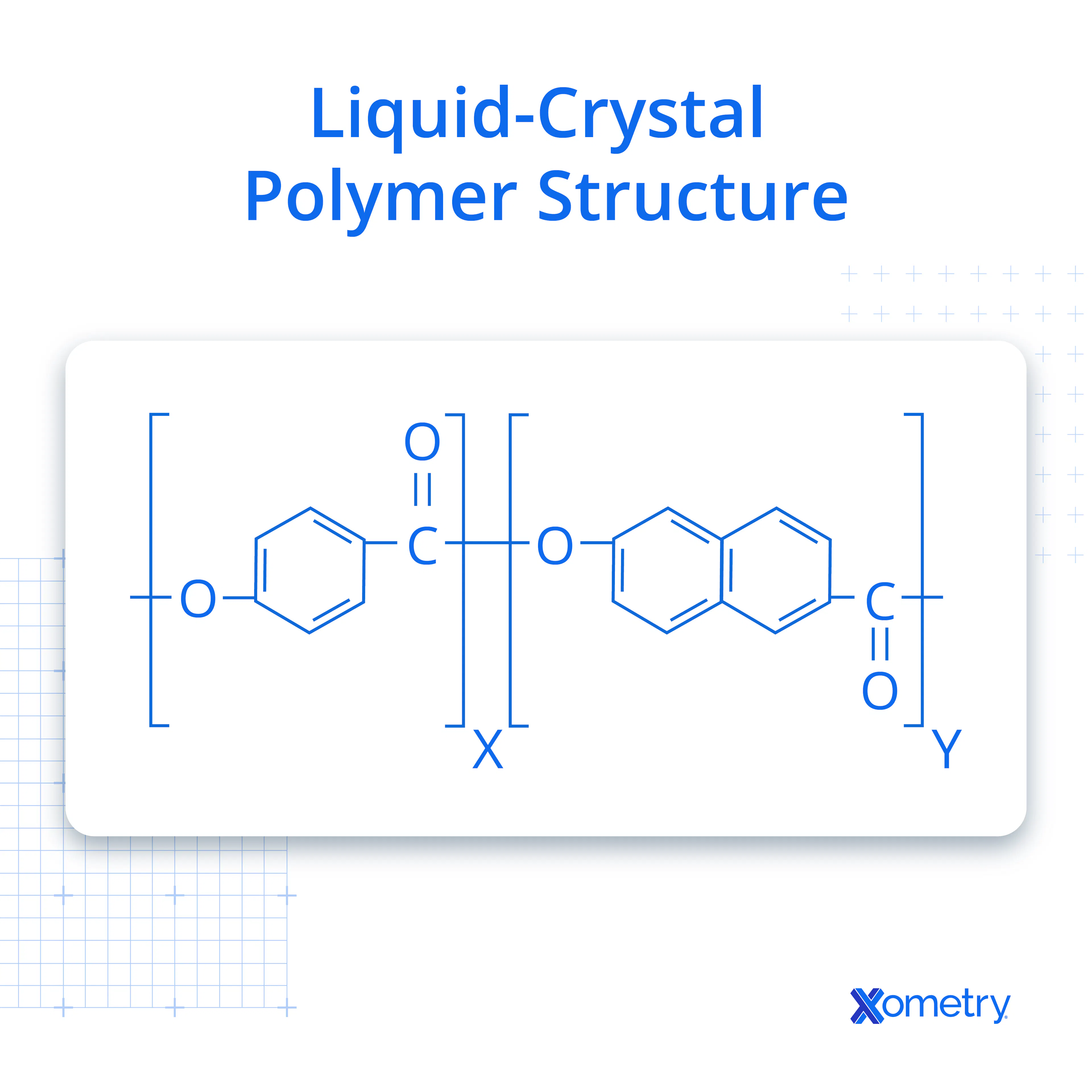

A liquid-crystal polymer is a polymer in which the various mesogen molecules link to form long polymeric chains.
How is Liquid-Crystal Polymer Made?
Most commercial LCPs incorporate p-hydroxybenzoic acid as one of the monomers that build molecular chains through various condensation methods. Monomers such as hydroquinone or 2,6-naphthalene dicarboxylic acid are commonly used alongside p-HBA to adjust processing temperatures and mechanical properties. In addition to these monomers, fillers can be added to the material to further enhance its properties. These fillers can include glass fiber or carbon fiber, enhancing mechanical and thermal properties.
An illustration of liquid-crystal polymer structure
