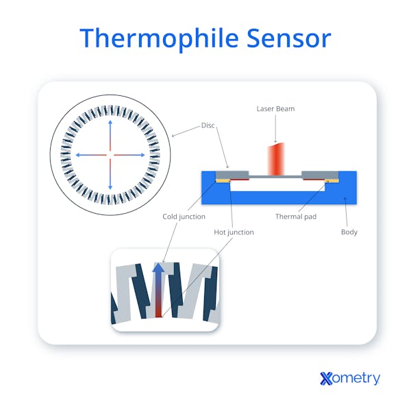

3. Thermopile Sensors (Thermal Method)
Thermopile sensors are versatile and work with many laser types. They can handle CW lasers, pulsed lasers, and long-pulse energy integration across a wide power range. These sensors absorb the laser radiation and convert it into heat, which is then transferred to a heat sink maintained at ambient temperature through convection cooling or water cooling. The temperature difference between the absorber and the heat sink is converted into an electrical signal using a thermocouple junction.
Thermopiles can handle a wide range of input powers without saturation, unlike photodiode-based sensors. The spectral range depends on the coating applied to absorb the laser power. A broadband thermopile coating typically provides a relatively flat spectral response from the near-UV (~200 nm) through the mid-infrared (~10 µm). The response time of thermopile sensors varies from several seconds for low-power sensors to up to one minute for kilowatt sensors. Some systems use signal processing algorithms to estimate final power readings more quickly, improving perceived response time to just a few seconds.
If you need to measure the power output of a CW laser ranging from tens of milliwatts to kilowatts or in the infrared region beyond 1800 nm (where germanium photodiode sensors have limited sensitivity), a thermopile sensor is likely the most suitable choice.
One unique capability of thermopile sensors is the ability to evaluate the power of a single "long" laser pulse, typically ranging from 1 millisecond to several seconds, over the pulse duration. The meter analyzes the thermopile output and applies an integration algorithm to display a measurement in Joules. This feature is particularly useful for long-pulse medical or industrial lasers.

What Are the Main Parts of the Thermopile Sensor?
A thermopile sensor is made up of a few parts. Some of the main components are discussed below.
1. Hot Junction
The hot junction is part of the thermocouple network within the thermopile that is exposed to the heated absorber. As the absorber heats up from laser radiation, it causes a temperature rise at the hot junction, which contributes to the generation of a voltage signal.
2. Cold Junction
The cold junction is the reference point or portion of the thermopile that remains at a constant temperature. It serves as a baseline for temperature measurements, allowing accurate calculation of the temperature difference across the thermopile element.
3. Thermocouple Output
The thermocouple output refers to the voltage signal generated by the thermopile element. The temperature difference between the hot and cold junctions induces a thermoelectric voltage across the thermocouples. This voltage is proportional to the laser power being measured.
