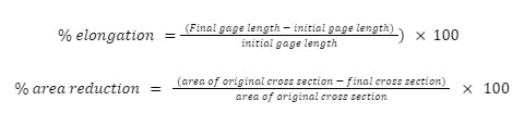

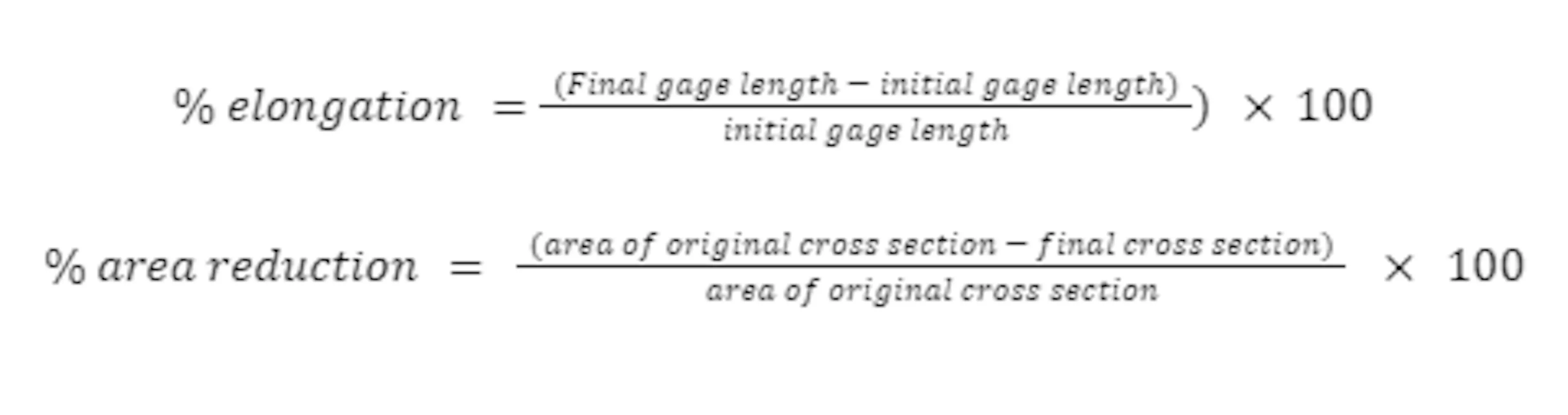

Ductility is reported as a percentage of elongation (seen in Figure 1 below) or sometimes as a percentage of area reduction. The following equations can be used to calculate ductility:
Ductility formula.
Both percentages of elongation and percentage reduction in area are measures that indicate the ductility of a material. The percentage of elongation is not an absolute measure on its own. The elongation is not uniform and will be the most extreme at the fracture location. The percentage reduction in area, which is measured at the narrowest cross-section, is a better measure of ductility.
