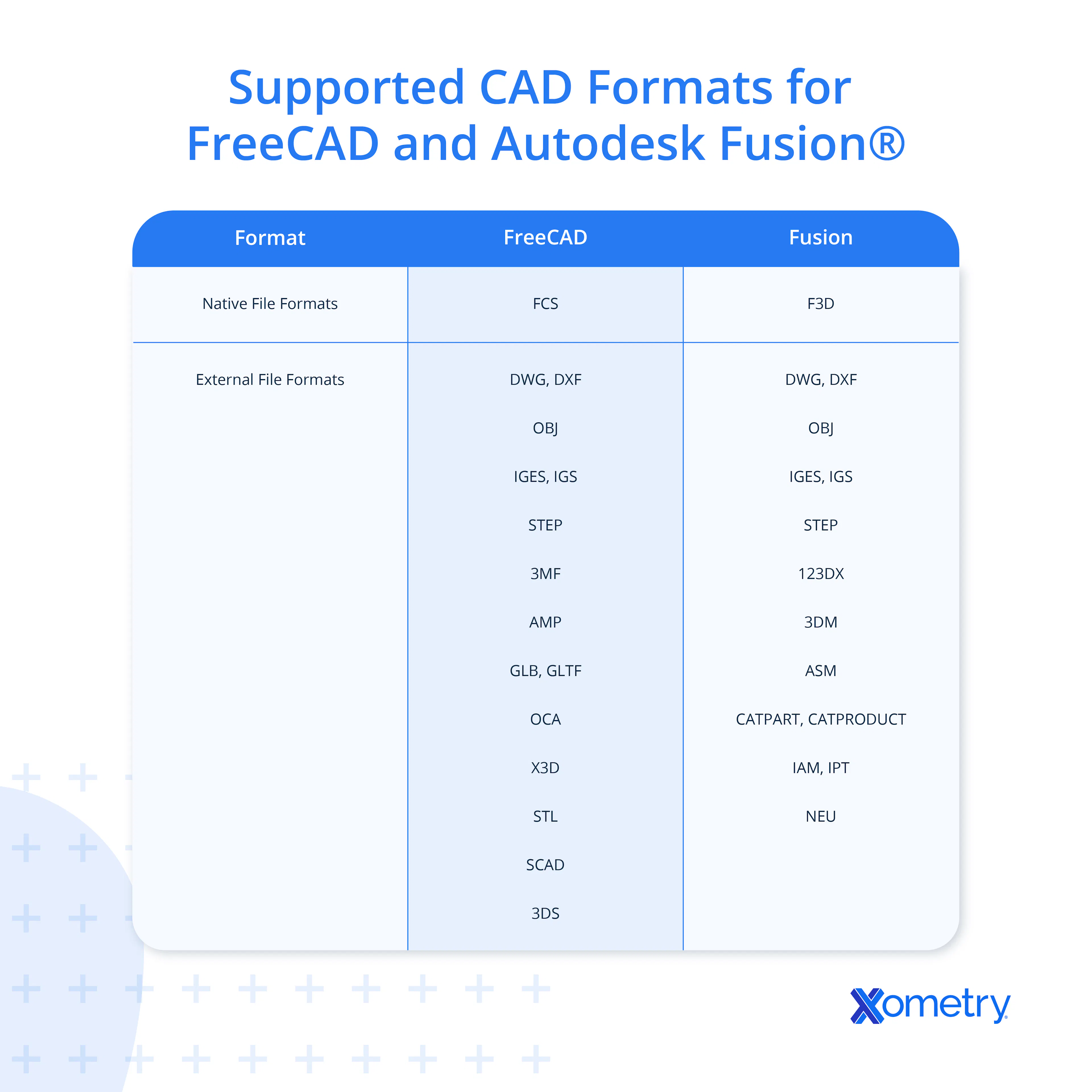

What File Formats do FreeCAD and Fusion 360 Support?
The below infographic shows the different CAD formats supported by FreeCAD and Fusion.
Supported CAD formats for FreeCAD and Fusion
