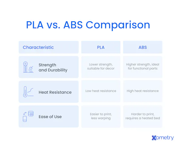

PLA and ABS are two of the commonly used 3D printing filaments, but they differ in key areas (strength, ease of use, and heat resistance). Acrylonitrile Butadiene Styrene (ABS) is stronger and more impact-resistant than Polylactic acid (PLA). ABS is ideal for parts exposed to mechanical stress (automotive or tool components) in terms of strength and durability. PLA is more suited for decorative or non-functional items where strength is not a priority in terms of heat resistance. ABS has a higher glass transition temperature, allowing it to withstand higher temperatures without warping. PLA has lower heat resistance and deforms under heat, making it unsuitable for high-temperature applications.
PLA is easier to print than ABS because it does not require a heated print bed and is less prone to warping. ABS needs a heated bed and shrink, leading to potential print failures if not appropriately managed. The cost differences stem from the materials' properties. PLA is cheaper to produce, making it more cost-effective for users focused on aesthetics or non-functional prints. ABS, with its higher strength and heat resistance, comes at a slightly higher cost due to its greater durability and applications in more demanding environments.
