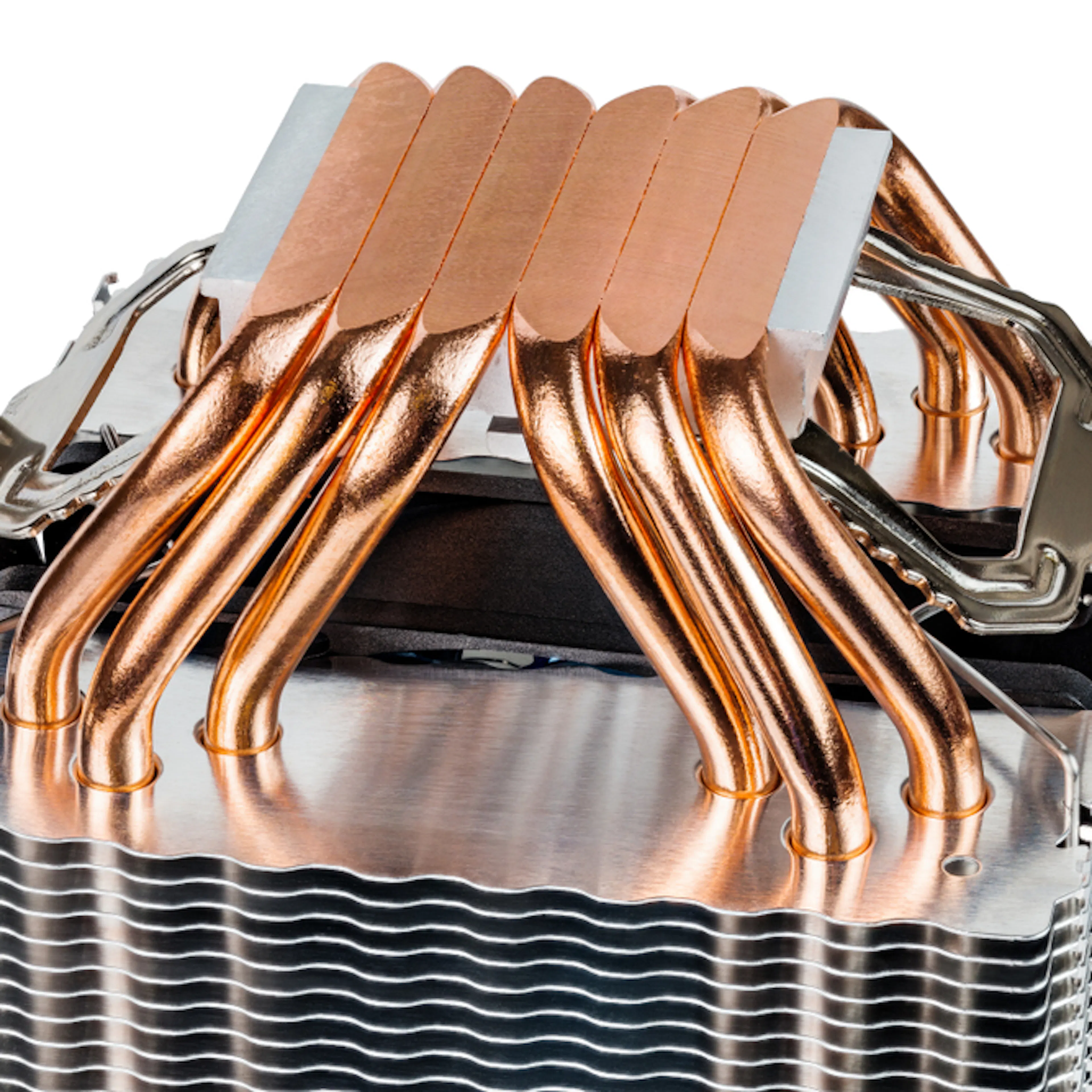

Heat radiator with copper heat pipes. Image Credit: Shutterstock.com/teh_z1b

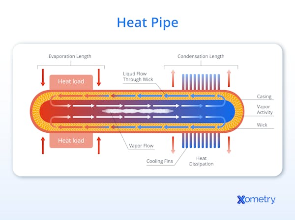

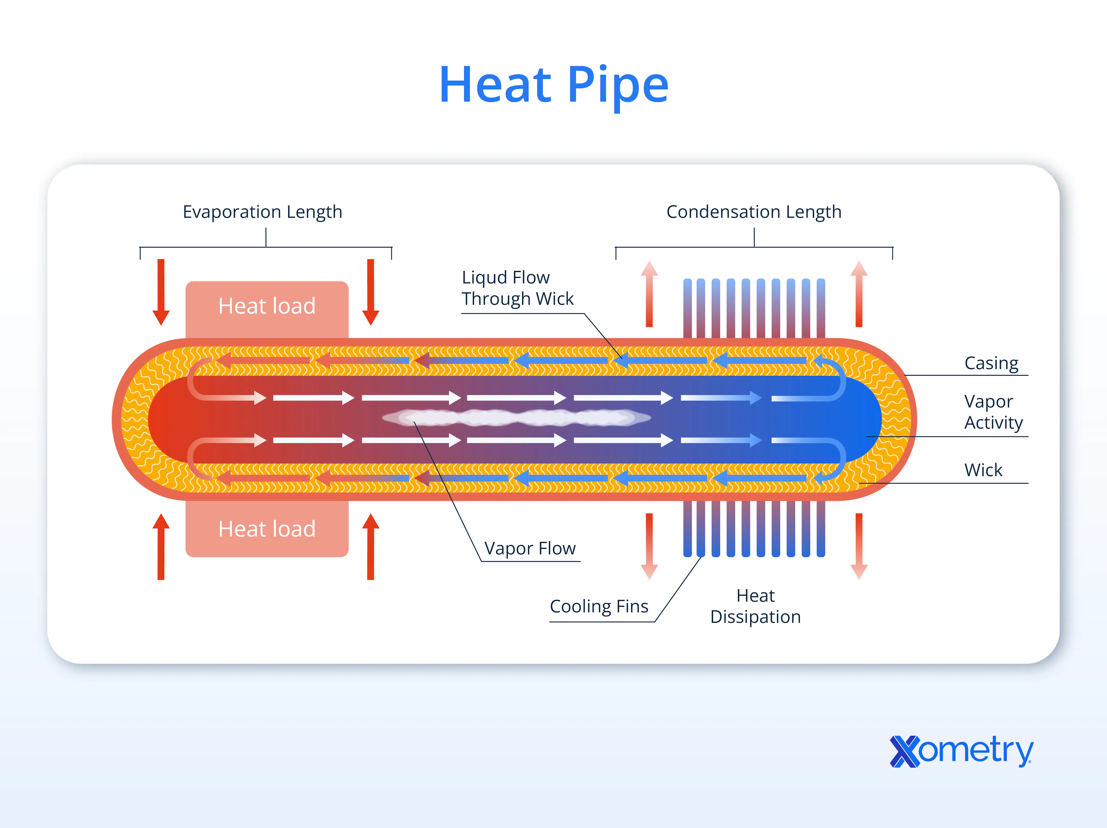

How Do Heat Pipes Work?
Every heat pipe needs a working fluid — usually water or a refrigerant. The fluid absorbs heat, vaporizes, and then moves to the cooler end of the pipe, where it releases heat by condensing back into a liquid. This ongoing cycle enables it to transfer heat over considerable distances. Systems for electronic cooling and heat recovery tend to utilize heat pipes.
An illustration showing how a heat pipe works.
