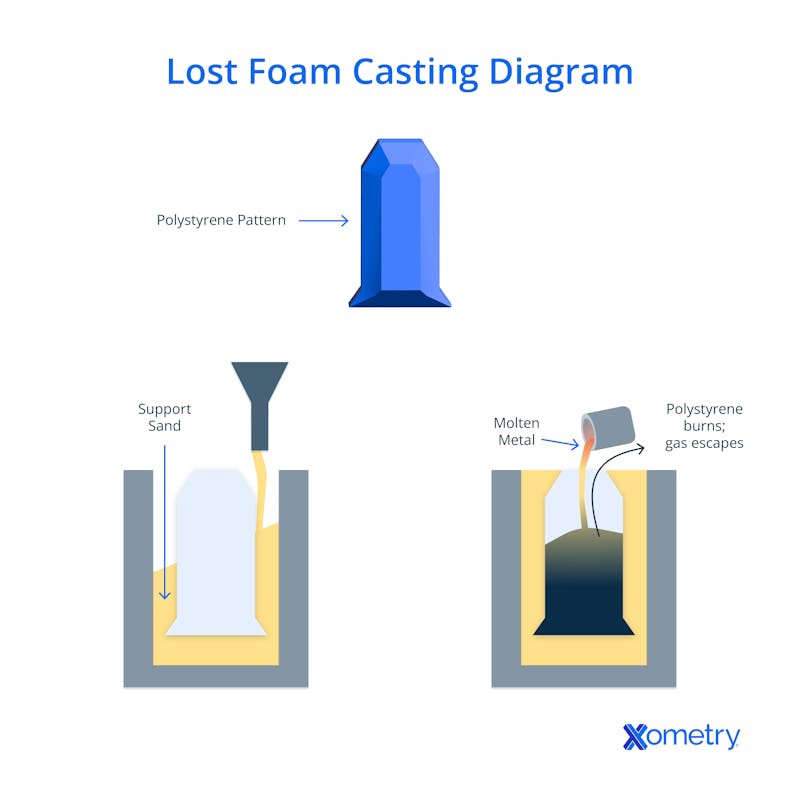

7. Lost-Foam Casting
Foam and molten metal don’t sound like they could mix, but this relatively newer process shows it’s possible to a certain extent. With lost-foam casting, you’ll inject molten metal into a foam mold that’s surrounded with support sand. The polystyrene foam will burn away and gas will disperse through the sand, leading to a cooled, formed shape. It’s a fantastic option if you need thin-walled products or items that are more intricately shaped. You’re not limited by industry, as this method works for creating all kinds of things like art sculptures, automotive parts, and circuit boards.
To learn more, see our article on Lost-Foam Casting.
Lost foam casting diagram
