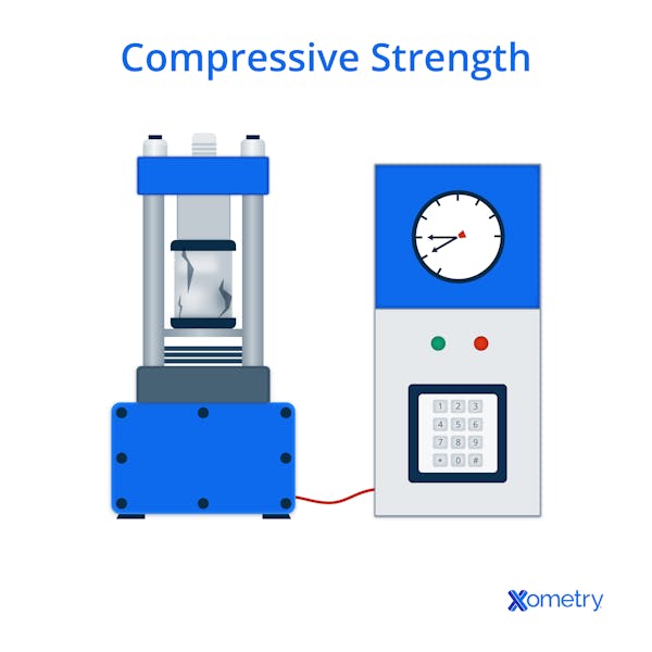

What Is Concrete Cylinder Testing?
The concrete cylinder compression test is a common process for determining the compressive strength of concrete. During this test, concrete specimens shaped like cylinders are subjected to progressively higher compressive loads until they break. The results can help engineers and builders verify that the concrete satisfies certain requirements for durability and structural integrity by providing valuable insights into the strength of the material. In addition to enhancing overall safety and the lifespan of structures, this ensures that concrete used in construction projects can handle the demands made on it.
“ASTM C39 testing establishes a reliable benchmark for structural concrete by standardizing the conditions under which compressive strength is measured. Consistent curing, geometry, and load application ensure that results are meaningful across different mixes and job sites. The process verifies the integrity of the mix, not just the strength of a single batch.”

An illustration of compressive strength testing.
