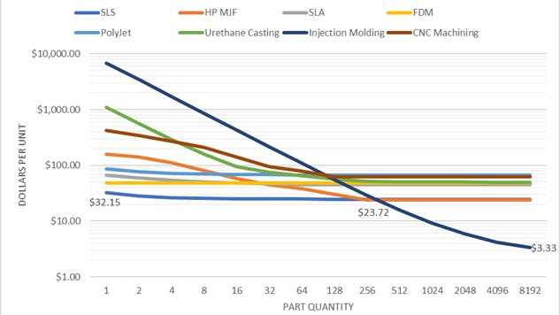

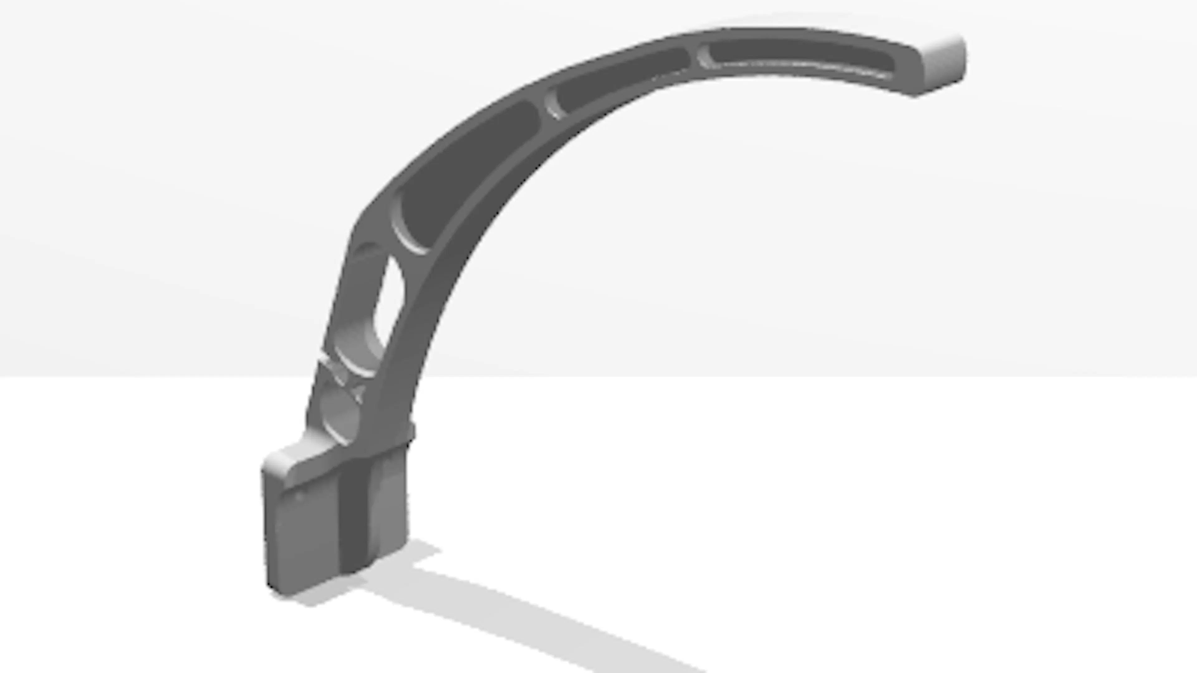

Pricing the Drone Leg
Our example drone leg has a bounding box of 146.69mm x 139.57mm x 33.00mm (5.775in x 5.495in x 1.299in). A bounding box is an imaginary box around an object that shows its dimensions in image processing.
The drone leg's geometry prices out the least expensive in selective laser sintered (SLS) nylon from quantities of one ($32) to roughly 250 ($24). Around this range, another 3D printing process called HP Multi Jet Fusion (HP MJF) became slightly less expensive per part. Still, at the same time, the price per unit in injection molding hit its break-even point and quickly shows its scaling benefit. The results are clear; at around a quantity of 250, it makes sense to start considering injection molding for a project with this geometry, with scaling that quickly goes to dollars a unit. This becomes roughly $3 per piece at quantities over 8000, including the cost of tooling. Given the curve, it is clear that the pricing would amortize even further as quantities increase.
Data results for the per-unit price of the drone leg are shown below, showing doubling quantities from 1 to 8,192 pieces.
Data results for the per-unit price of the Drone Leg

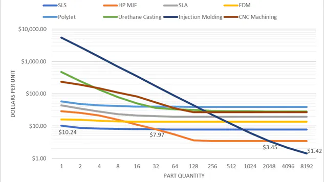

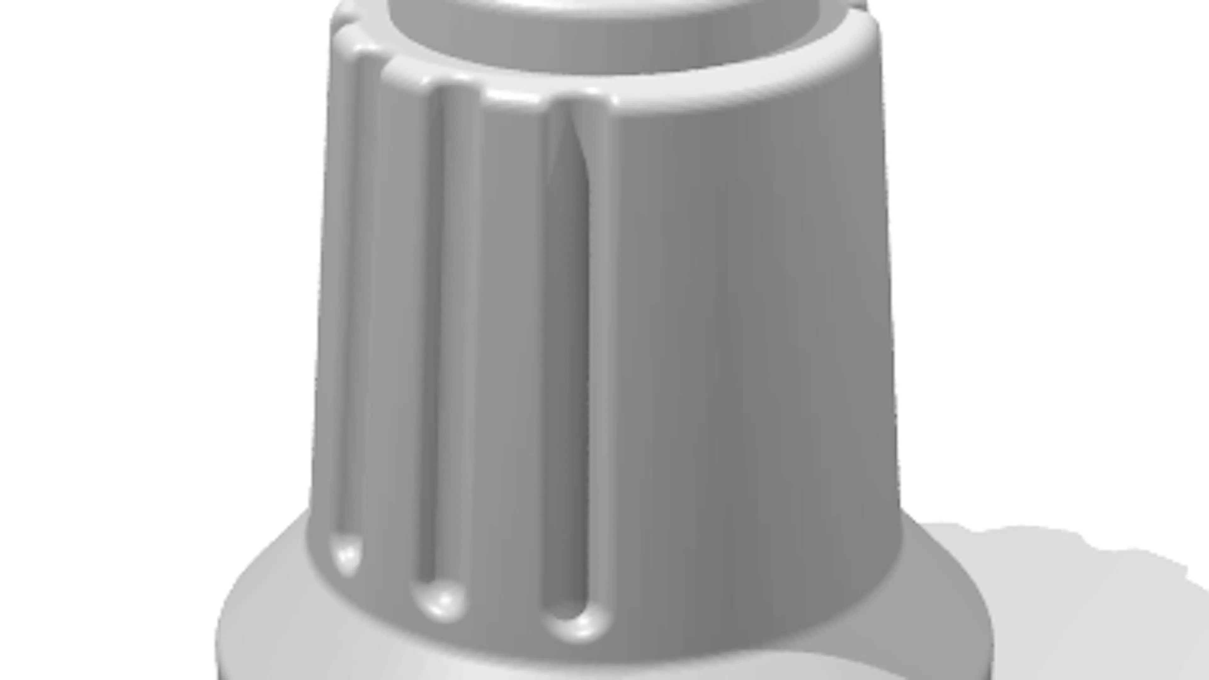

Pricing the Potentiometer Knob
The potentiometer knob has a bounding box of 16.81mm x 15.20mm x 15.20mm (0.662in x 0.598in x 0.598in). It is about the same size as a thimble.
The potentiometer knob tells a different story than the drone leg. Because of its small size (about the size of a thimble), it remains cost competitive using 3D printing for quantities up to 2000 units before the break-even hit to injection molding. Note that around a quantity of 30, it is more economical to move from SLS 3D printing to HP MJF 3D printing. At $3.45 per unit, HP MJF is an excellent solution to keep small batch inventory on hand using just-in-time (JIT) methodology. However, if over 2000 are needed, then injection molding can save you thousands of dollars throughout the product's lifetime. In fact, the per-unit price without tooling amortized was less than $0.80. Savings could be even higher if a multi-cavity mold tool is chosen.
Data results for the per-unit price of the potentiometer knob are below, showing doubling quantities from 1 to 8,192 pieces.
Data results for the per-unit price of the Potentiometer Knob

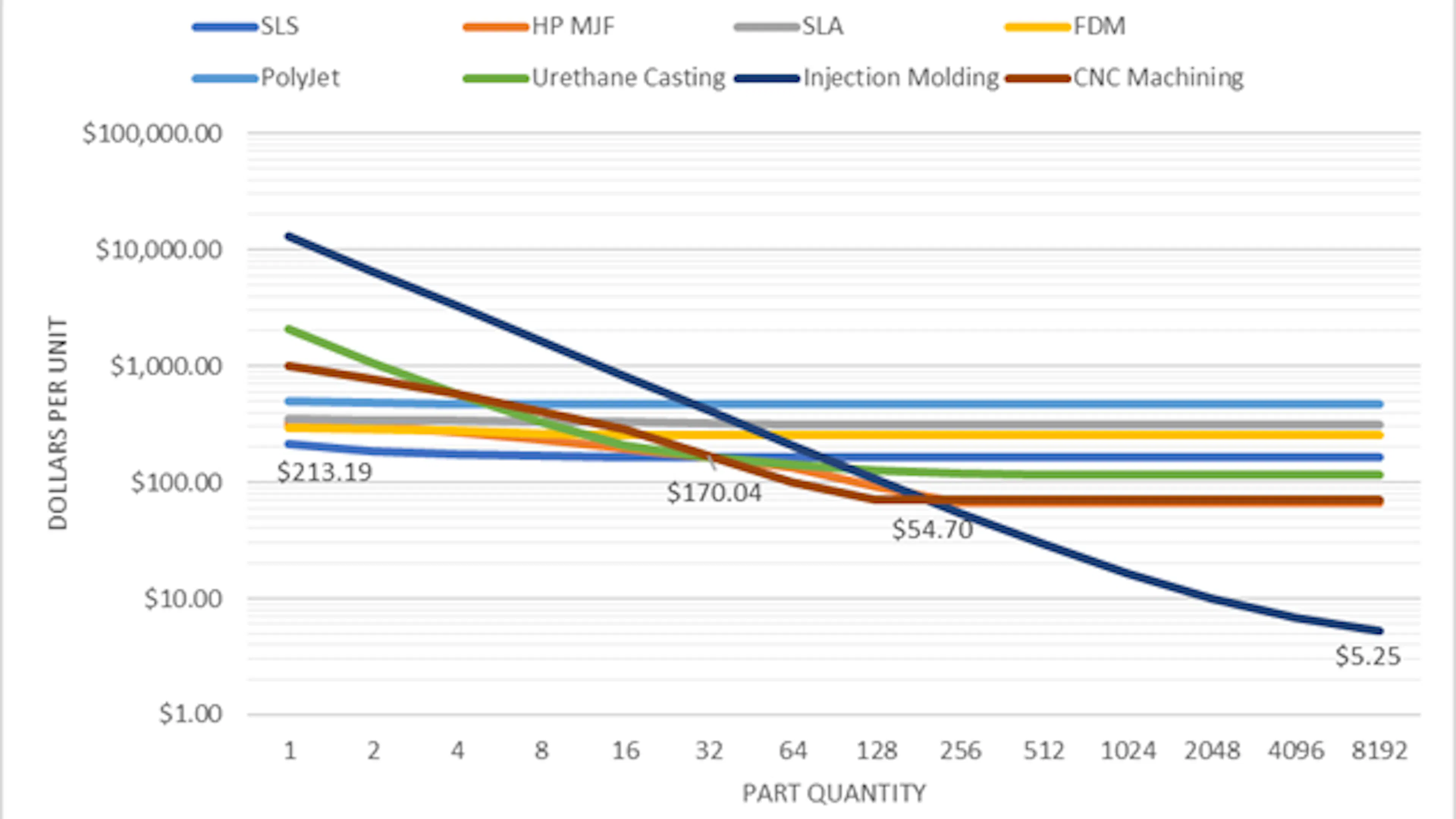

Pricing the Junction Housing
The junction housing has a bounding box of 215.84mm x 172.44mm x 68.18mm (8.498in x 6.789in x 2.684in). This would be considered larger on many 3D printing platforms.
The junction housing is an interesting case because it is typically considered a “larger part” on 3D printing platforms. This gives it a higher per-unit price from the get-go, and also very little discount over quantity for these processes. SLS nylon still is the cheapest at quantity one, being just above $200. Around 30 units, there is actually better pricing if the part is CNC machined. Even urethane casting and HP MJF tend to be more competitive than SLS between quantities 30 and 250. Like the other parts in this study, injection molding is ultimately the clear choice for production manufacturing. The upfront tooling to mold this piece is over $10,000, but the per-unit price is so low that at 250 units it becomes dramatically more economical, by an order of magnitude, to move to injection molding tooling.
Data results for the per-unit price of the junction housing are shown below, with doubling quantities from 1 to 8,192 pieces.
