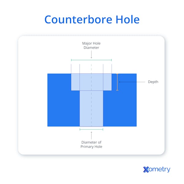

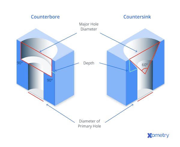

How To Drill a Counterbore Hole
In CNC machining of metals and plastics, the counterbore operation is generally performed by a non-specialist cutter of a larger diameter in a secondary operation. The CNC machine obviates the need for a mechanical depth limit, as this is machine-controlled. Automation also makes centering of the counterbore a function of machine programming rather than it being a hit-or-miss process, so there is no requirement for the counterbore operation to physically locate the initial hole for a fully centered start. Counterbores can precede hole drilling in these circumstances, which may reduce the need for tool changes or traverses, speeding up operations.
An illustration of a counterbore hole.

Counterbore Holes vs. Countersink Holes
A counterbore hole serves the purpose of concealing fastener heads that have flat lower faces and applies to:
  1. All types of heads for drives used for rotating threaded fasteners such as: external hex, internal hex, Phillips, crosshead, Torx, pin Torx, and slot.
  2. All flat-bottomed threaded fastener head types such as: pan, button, cap, hex, and washer hex.
  3. Wide variety of knock-down joint fasteners that are not threaded, such as quarter-turn locks and push nuts.
  4. Various rivet types such as pop, peened, and push rivets.
Countersunk holes apply to much the same range of fastener types. They are used for the same purpose: to make flush or below-flush finish fasteners for cosmetic or technical reasons. The difference is that countersinking requires a conical rather than cylindrical recess, angle, and diameter to match the underside of the intended fastener head.
countersink vs. counterbore holes
An illustration of both counterbore and countersink holes.
