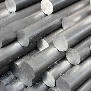

What’s 6061-T6511?
6061-T6511 is an extruded bar or rod that undergoes the same heat treatment process as T6. It also receives a stress relief operation and may also be straightened. Typically, extrusions produced to T6511 temper will also be certed by the mill to T6 temper via a material certification or mill test report. T6511 is typically a less expensive stock compared to T651.

6061-T6511:
  • Extruded bar or rod stock.
  • Most formable/workable of the different 6061 alloy tempers.
  • Useful for turned aluminum goods and general machining if the hardness, size availability, and stability of T651 are not necessary.
  • Beyond 1 " thick, the available width of T6511 is more limited. The maximum width is typically less than 15”.
