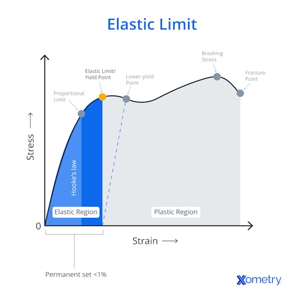

The elastic limit refers to the point where the material transitions from the elastic deformation region to the plastic deformation region, as shown in the stress-strain curve of Figure 1 below
An illustration of a graph showing Elastic Limit.
This is the point at which permanent deformation or even failure (in brittle materials) initiates.
