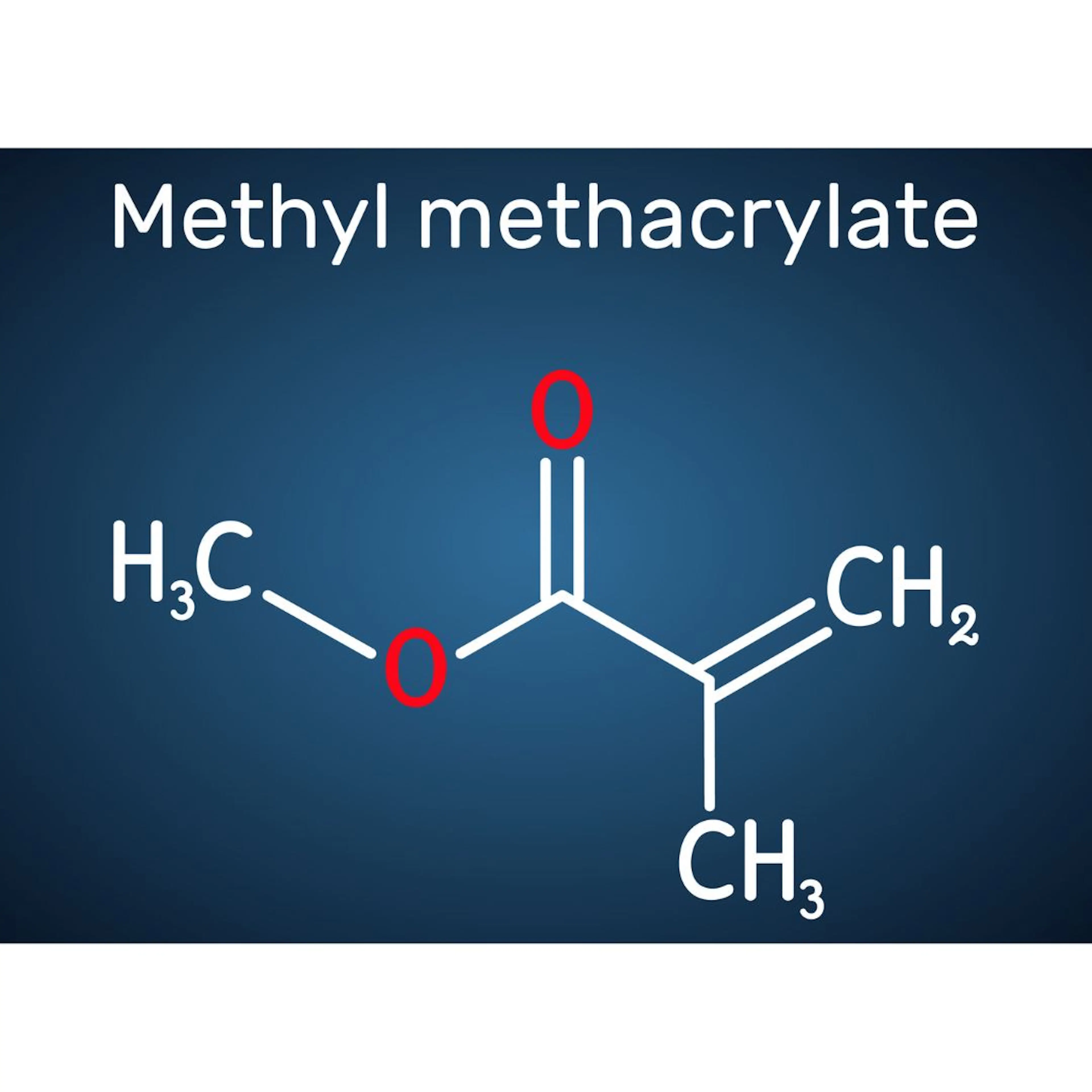

Methyl methacrylate molecule. Image Credit: Shutterstock.com/Bacsica

Methyl methacrylate (MMA), also known as methacrylic acid methyl ester, is an organic compound with the chemical formula C5H8O2. It is a colorless liquid with a pungent, fruity odor. It features a polymerizable methacrylate group and a reactive ester group, making it highly versatile for polymerization and copolymerization. MMA is slightly miscible with water, soluble in most organic solvents, and has relatively low volatility. It is used primarily to produce polymethyl methacrylate (PMMA), a plastic known for its clarity, durability, resistance to UV light and weathering, and its versatility as a building block in polymer chemistry. Additionally, MMA is used in making various coatings, adhesives, paints, and medical devices, due to its ability to impart properties such as: impact strength, weather resistance, and chemical resistance to the polymers it forms. MMA's ability to cure quickly also makes it valuable in the production of surgical cements and dental prostheses, for which rapid setting is required.
