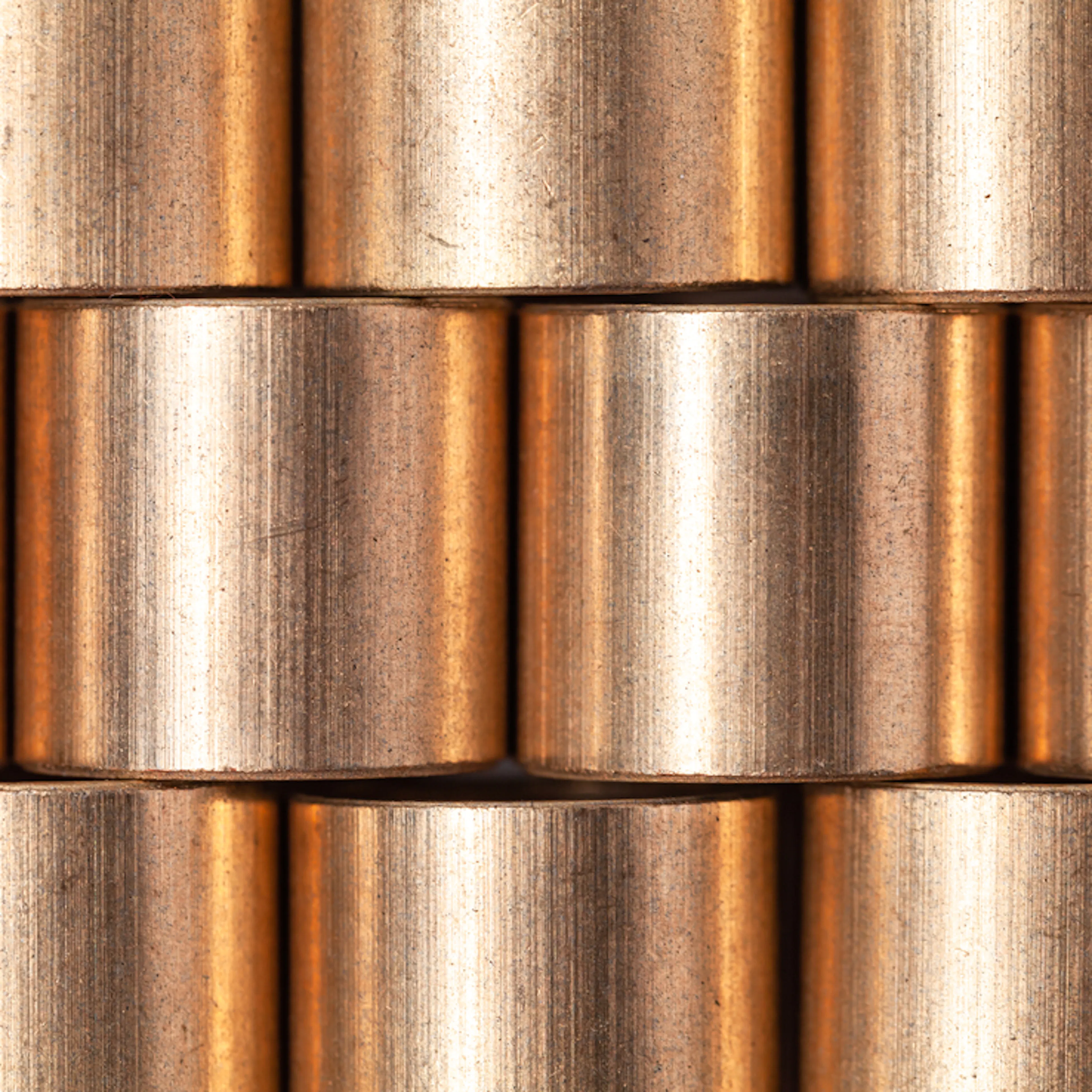

Bronze bearings. Image Credit: Shutterstock.com/Evannovostro
