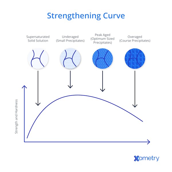

3. Hardening
Hardening involves heating the steel to its austenitizing temperature (above the critical point) and then rapidly cooling it in a quenching medium such as oil, water, or polymer solutions. This rapid cooling locks the steel's microstructure in a hardened state, increasing both hardness and strength. However, it also makes the steel more brittle, so tempering is often performed afterward to restore some toughness.
Strengthening curve
An illustration showing the strengthening curve of steel.

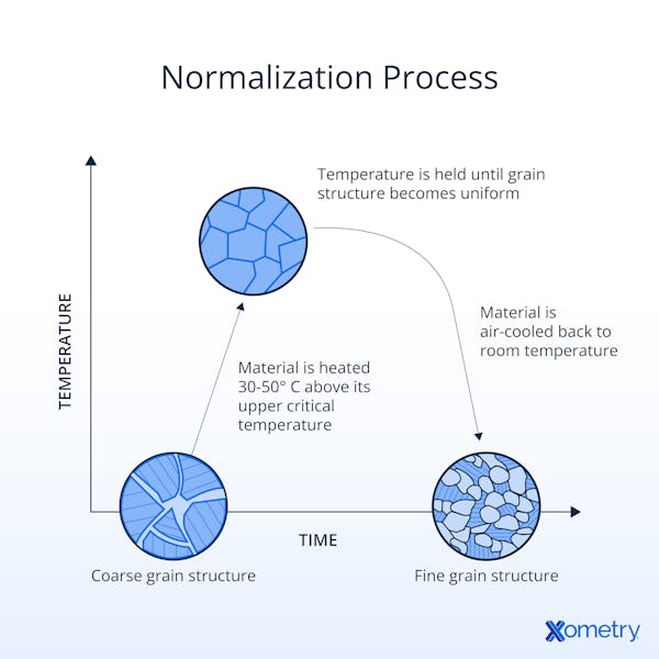

4. Normalizing
Normalizing is a heat treatment used to refine the grain structure of the steel and improve its mechanical properties. It involves heating the steel to a temperature slightly above its critical point and then allowing it to cool in still air. Normalizing eliminates internal stresses, improves machinability, and enhances the steel's uniformity and strength.
Normalization process
An illustration showing the normalization process.
