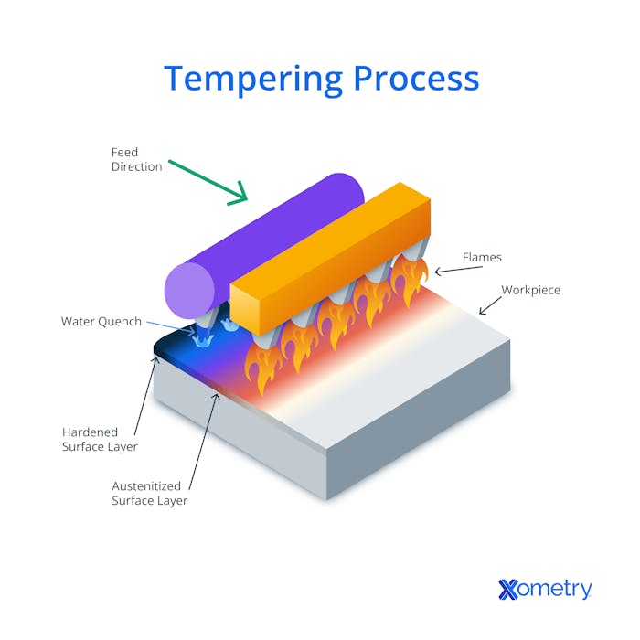

tempering process
Tempering process

At What Temperature Is Tempering Done?
The tempering temperature of metals varies with the material/alloy composition, the degree of temper required, and the desired mechanical properties. However, tempering temperatures for steel and similar alloys generally fall within the range of 300–700 °C.
Low-temperature tempering takes place at 150–350 °C. This results in increased toughness and the retention of relatively high hardness. Medium-temperature tempering occurs at 350–500 °C. This balances hardness and toughness for general-purpose applications. High-temperature tempering takes place at 500–700 °C. This primarily enhances toughness, sacrificing hardness in the process.
