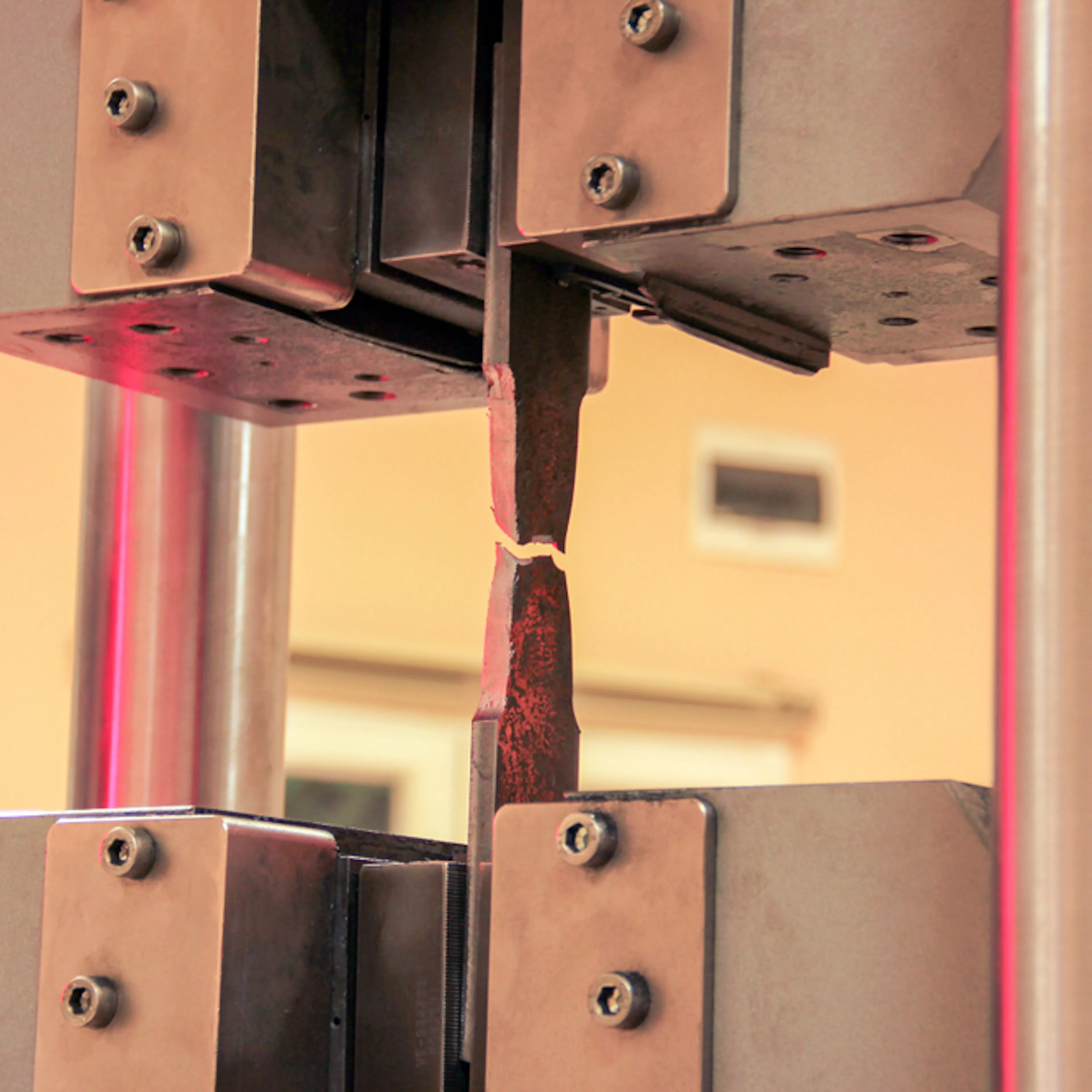

A tensile test is a destructive testing method carried out with the use of a tensile testing machine. A tensile strength tester works by holding a specimen in a pair of grips and then applying an increasing tensile load until the specimen breaks. If the original cross-section of the specimen is known as well as the rate of elongation (the rate of change in length), then the tensile strength can be calculated. Tensile testing can be performed using an electromechanical or hydraulic universal test machine. The machine consists of specimen grips to hold the test piece, a crosshead to move and apply loading, and a data acquisition system to record the test parameters. This article will further discuss tensile testing machines, how they work, the types and components, and provide examples.
What Is a Tensile Testing Machine?
A tensile testing machine is a device that measures the mechanical properties of a material. A tensile test machine uses either an electromechanical or hydraulic system to apply a tensile load to a test piece until failure. During the test, the tensile strength machine will record the rate of elongation, change in length, and the load applied which can be used to determine the material properties of the specimen.
How Does a Tensile Testing Machine Work?
A tensile tester works by gripping a specimen of a known cross-section and then pulling it apart at a predetermined speed until failure. The tensile test result can be interpreted to find the tensile strength, elongation, and stiffness. Many tensile testers can also perform compression. For a compressive test, the setup is the same but acts in reverse and uses different grips to hold the material.

How To Use Tensile Testing Machine?
To perform a tensile test, an operator will load a specimen into the two specimen grips of the machine. After loading the specimen, the operator selects the correct rate of movement for the material type. The tester then pulls the specimen apart until failure. The extensometer will record the distance moved and plot the movement on a graph electronically. Once completed, the graphic results are interpreted to understand the properties and behavior of the material.
How To Prepare Materials for Tensile Testing Machines?
To prepare a material ready for testing, the material is shaped to resemble a “dumbbell” or “dog bone.” Preparing the material in this way gives the grips a pair of “shoulders” to hold onto to pull apart the specimen. Shaping the specimen in a “dumbbell” shape guarantees that the sample will fail in the narrow section.
