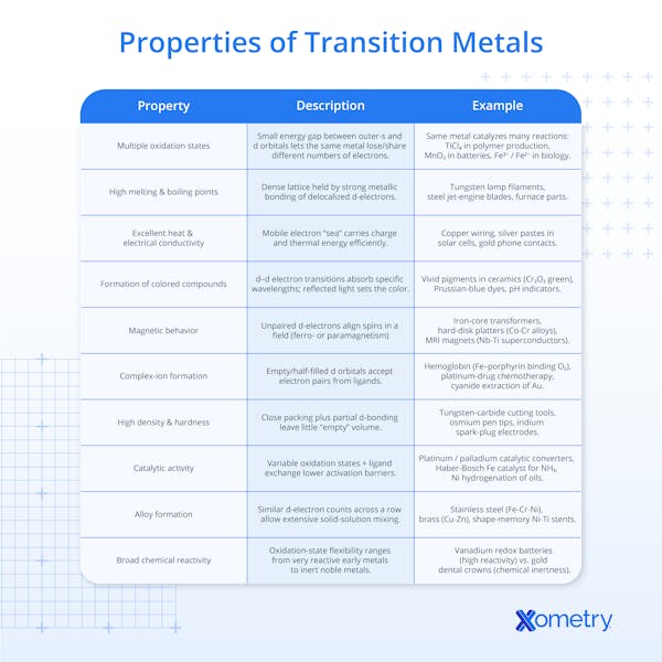

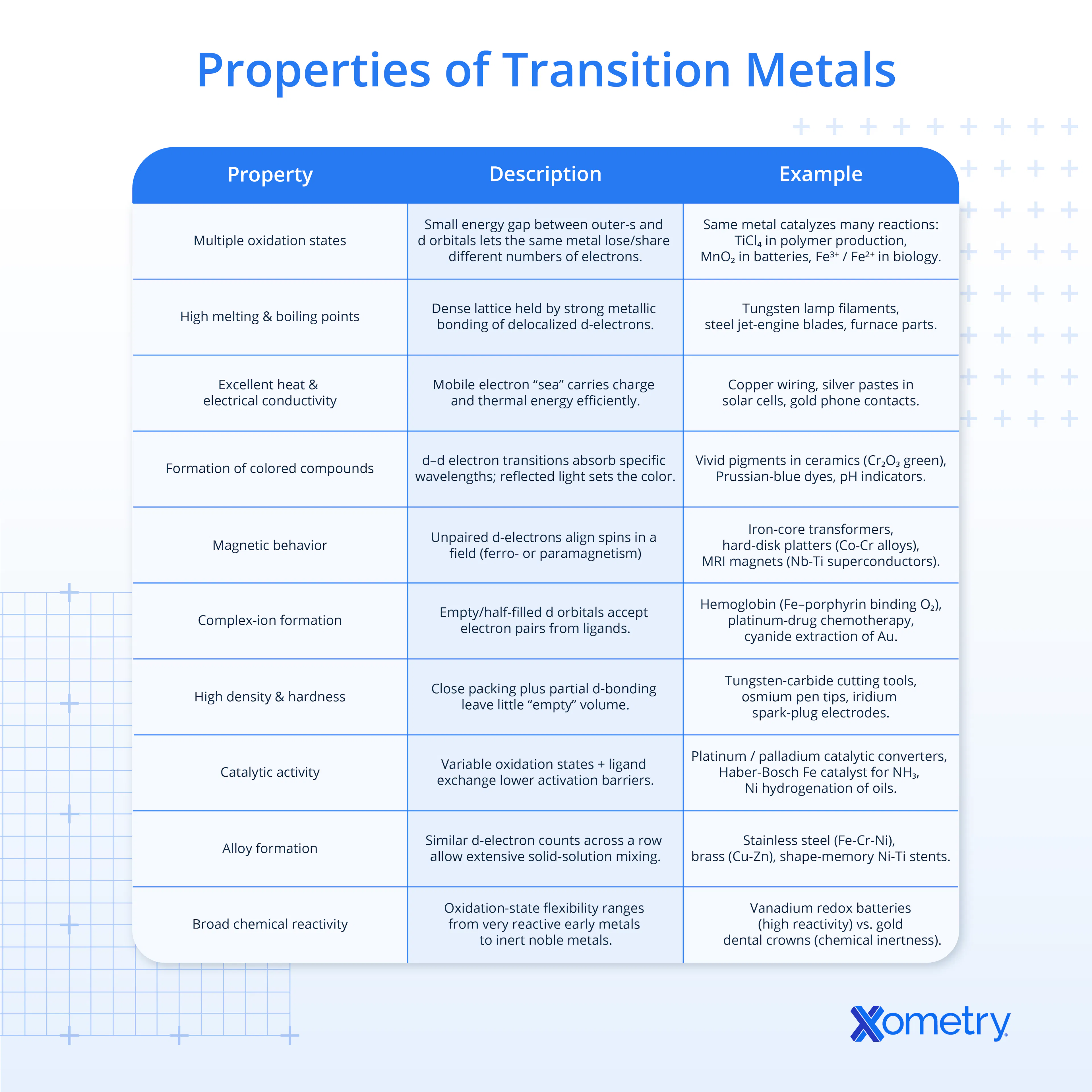

Transition metals show typical metallic behavior. The general properties of transition metals are as follows:
A table showing the different properties of transition metals and examples of each property.
1. Multiple Oxidation States
Transition metals are known for exhibiting a variety of oxidation states in their compounds. This is due to the relatively low energy difference between their outer s orbitals and the d orbitals where the valence electrons reside. As electrons can be added to or removed from both the s and d orbitals, transition metals can participate in a range of redox reactions, enabling them to act as versatile catalysts and reactants. For instance, early in the transition series, metals like titanium can lose electrons from both their 3d and 4s orbitals, leading to a range of stable oxidation states. The variability of oxidation states is further influenced by the metal's position in the periodic table, with elements in the middle of the series typically displaying a wider range of states.
2. High Melting and Boiling Points
Most transition metals have high melting and boiling points. This is attributed to the strong metallic bonds formed by the delocalized d electrons. These electrons move freely throughout the metal lattice, creating a strong bond between the positively charged metal ions. The dense electron cloud resulting from the overlap of d orbitals contributes to the strength of these metallic bonds.
3. Good Conductivity of Heat and Electricity
The free movement of electrons in the electron cloud of transition metals facilitates the efficient conduction of heat and electricity. This property makes them ideal materials for electrical wiring and components that must efficiently dissipate heat.
4. Formation of Colored Compounds
The d-d electron transitions within transition metal compounds are responsible for their vivid colors. When light hits these compounds, electrons are excited from one d orbital to another, absorbing specific wavelengths of light. The wavelengths that are not absorbed are reflected, giving the compounds their characteristic colors. This property is utilized in dyes, pigments, and indicators.
5. Magnetic Behavior
Certain transition metals (e.g., iron, cobalt, and nickel) and their compounds can exhibit paramagnetism when they have unpaired d electrons. The spin of these unpaired electrons can align under the influence of an external magnetic field, making the material magnetic.
6. Formation of Complex Ions With Ligands
Transition metals can form complex ions by coordinating with ligands — molecules or ions that donate pairs of electrons to the metal. This ability to form coordination complexes is fundamental to many biological processes (e.g., oxygen transport by hemoglobin) and industrial applications (e.g., catalysis and the purification of metals).
7. High Density and Hardness
The closely packed crystal lattice and the presence of d electrons contribute to the high density and hardness of transition metals compared to s-block elements. This makes them suitable for structural applications and tools.
8. Catalysts in Chemical Reactions
Transition metals and their compounds serve as excellent catalysts due to their ability to adopt multiple oxidation states and form complexes. They can facilitate chemical reactions without being consumed in the process, thereby significantly increasing the reaction rate. Catalysts like platinum and palladium, for example, are crucial in automotive catalytic converters for the reduction of harmful emissions.
9. Ability To Form Alloys
Transition metals can easily mix with other metals to form alloys, materials with enhanced properties, such as greater strength, corrosion resistance, or electrical conductivity. Steel, brass, and bronze are some examples of popular alloys.
10. Wide Range of Chemical Reactivity
Due to their varied oxidation states and the formation of complexes, transition metals exhibit a broad spectrum of chemical reactivity, from highly reactive metals like scandium and titanium to relatively inert metals like gold, silver, and platinum, often referred to as noble metals. Noble metals exhibit low reactivity due to their high ionization energies and low hydration enthalpies.
