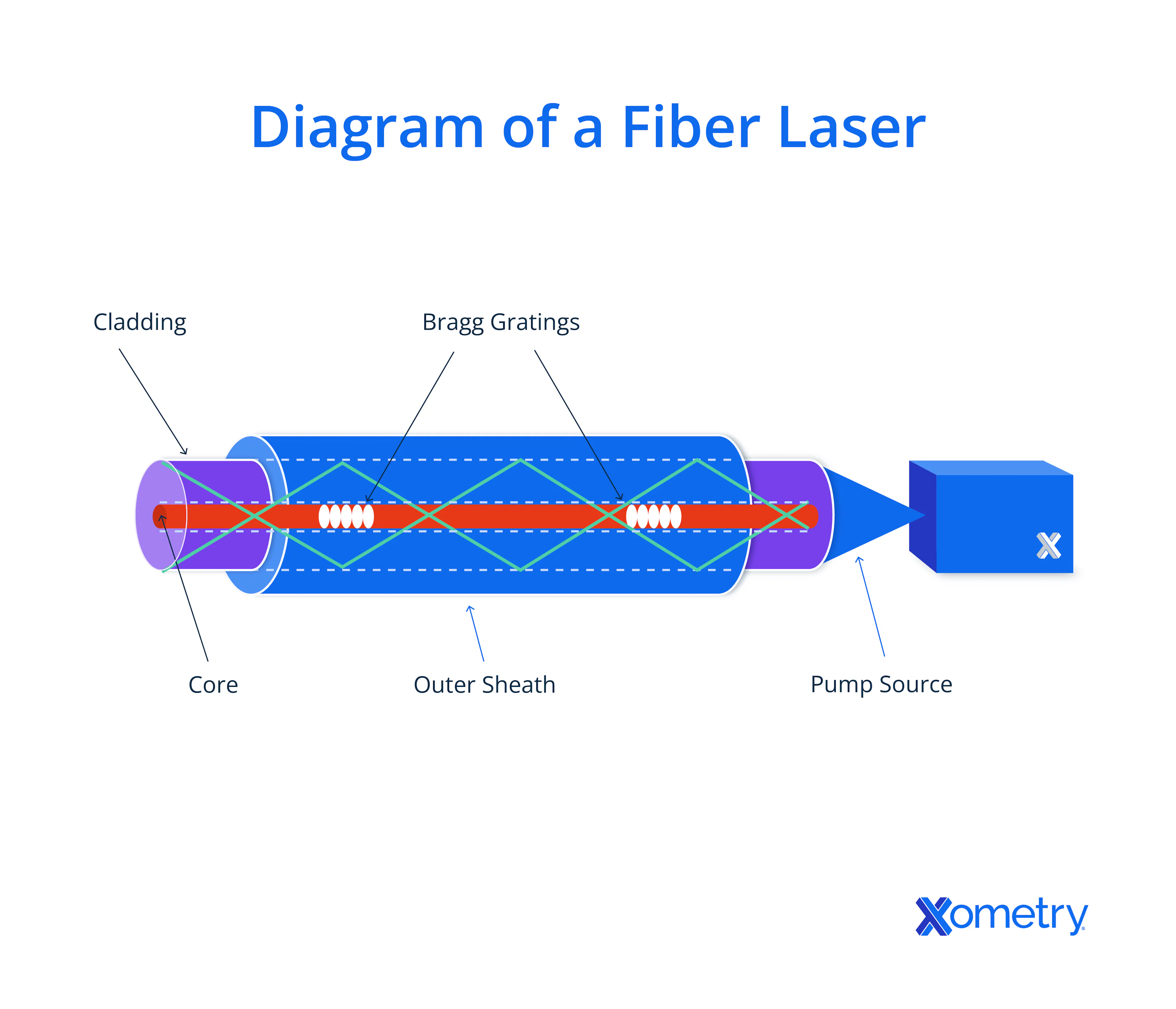

  • Fiber Lasers: Unlike CO2 lasers, which use electric current, a gas mixture, and a series of mirrors to create the laser beam, fiber lasers create the laser beam by using special glass fibers that get energy from pump diodes. Fiber lasers are the most expensive of the three types of lasers. They require little maintenance and can be used for up to 25,000 operating hours. These lasers are most suitable for metal and thermoplastic engraving but can work on any material, metallic or non-metallic.
Diagram of a fiber laser
