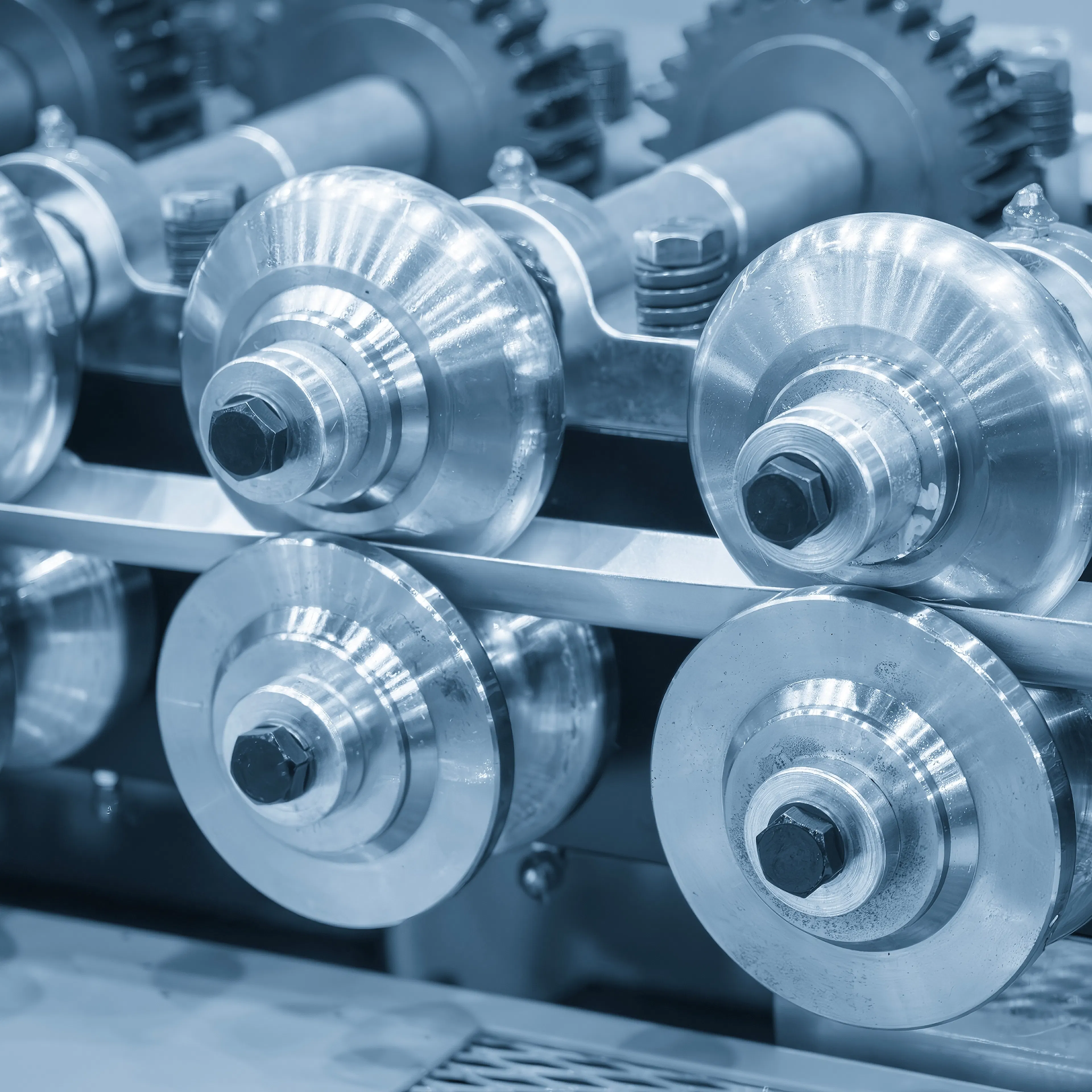

What Components Make Up a Roll Forming Machine System?
The components that make up a roll forming machine system are listed below.
  • Uncoiler: The uncoiler holds the metal coil and controls the release rate of the strip as it feeds into the forming line. Motorized uncoilers maintain consistent back-tension on the strip, preventing slack accumulation that causes misalignment at the entry rollers. Coil capacity on industrial uncoilers ranges from 5,000 kg to 30,000 kg, depending on production requirements.
  • Guiding System: Entry guides, edge guides, and straightening rolls position the strip accurately along the centerline of the forming line before it reaches the first roller station. Lateral adjustment of the guides accommodates different strip widths without retooling the roller stations. Proper guide alignment at the entry stage directly determines tracking accuracy across the full forming sequence.
  • Roller Stations: Paired upper and lower roller dies at each station apply a defined incremental deformation to the strip cross-section as the material passes through under driven force. Each station is mounted on a fixed stand with adjustable shaft spacing to set the vertical gap between rollers according to material thickness. A standard forming line contains from 6 to 24 stations, with complex profiles requiring the higher count.
  • Cutting Unit: The flying cutoff press or rotary shear severs the continuous formed profile to the specified part length without stopping the line. Flying die cutoff systems synchronize with the strip speed to maintain dimensional accuracy at the cut face. Cutting tolerances on standard systems range from ±0.5 mm to ±1.5 mm, depending on machine type and line speed.
  • Control System: The programmable logic controller (PLC) or CNC control panel governs line speed, roller gap settings, cutoff length, and production count. Automated control systems allow rapid changeover from stored profile programs, reducing setup time from hours to minutes. Data logging functions on modern control systems record production parameters for quality traceability.
What Role Do Roller Stations Play in Profile Accuracy?
Roller stations are the primary determinants of profile accuracy in roll forming because each station contributes a defined angular increment to the cross-section, with the cumulative geometry of all stations producing the finished profile shape. The contour of each roller die is machined to a precise radius and angle that corresponds to the required deformation at that stage of the forming sequence. Deviation in roller geometry, shaft alignment, or bearing clearance at any station propagates as a dimensional error through all subsequent stages, compounding into measurable angular or width variation in the finished profile.
Incremental shaping across sequential stations distributes the total bending strain across a longer forming path, reducing localized stress concentration and minimizing the risk of material fracture or surface marking. Stations positioned early in the sequence apply low-angle bends to establish the general profile orientation, while later stations refine the geometry and close tight radii. The final stations function as sizing or calibration passes that correct minor angular deviation introduced by springback in the preceding stages. Dimensional stabilization at the exit of the forming line depends on the precision of the final roller contour and the consistency of the material's mechanical properties across the full coil width.
