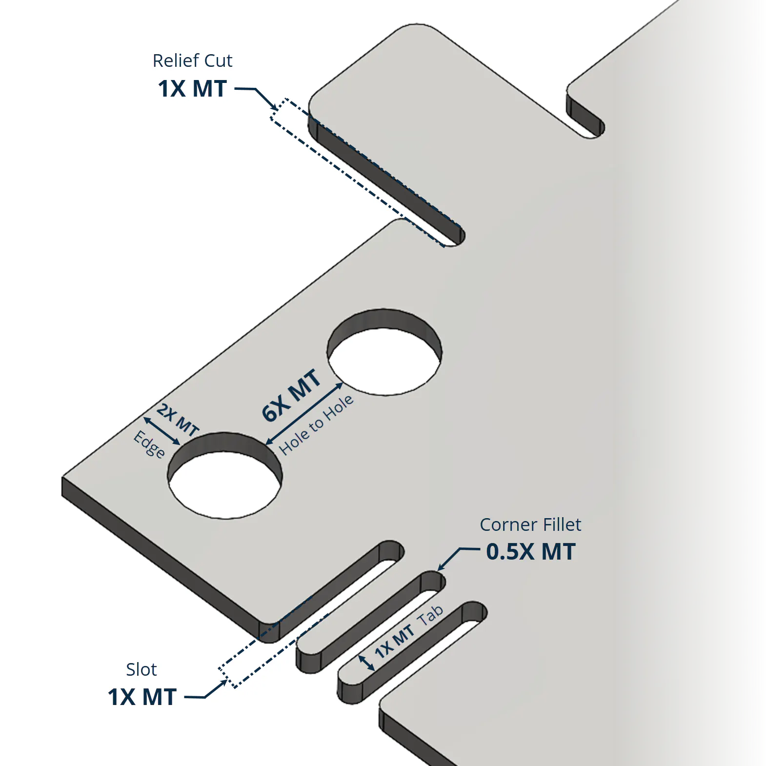

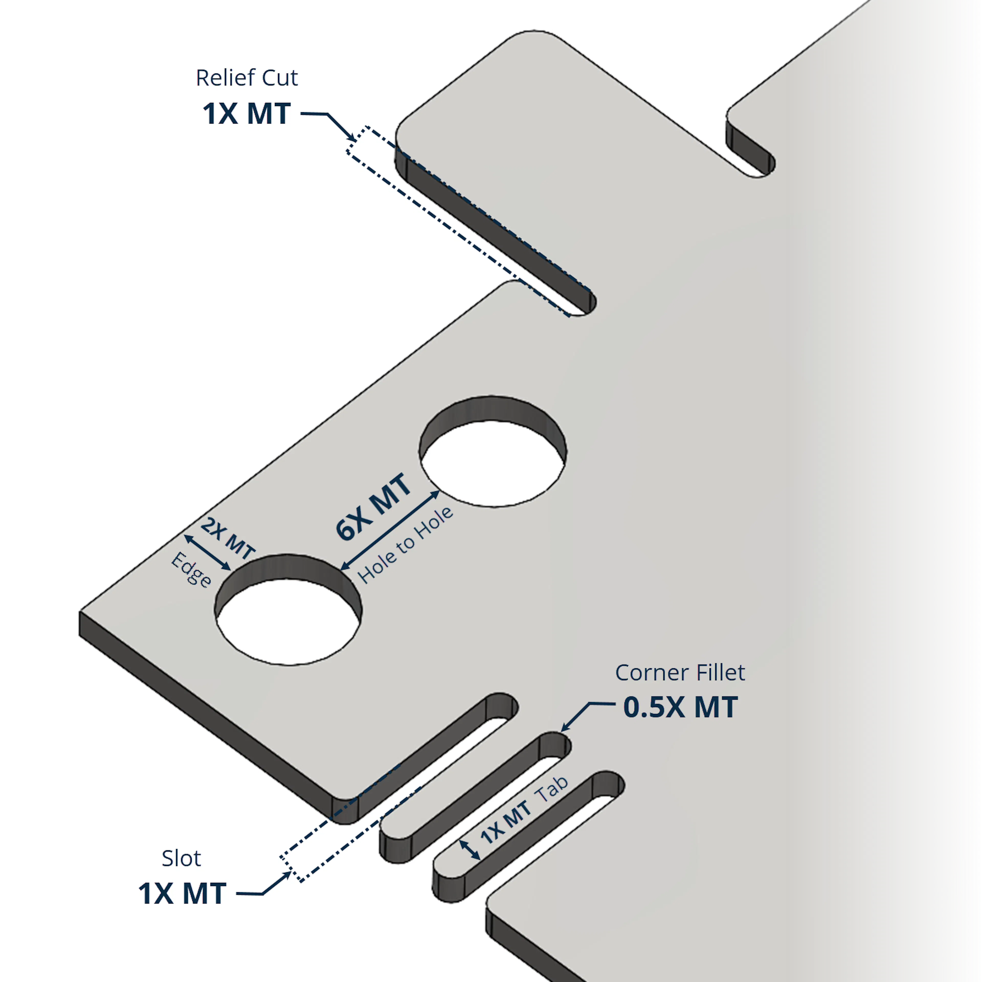

Minimum Feature-to-Feature Distances for Laser and Waterjet Cutting
A minimum distance between features should be maintained to ensure the integrity of the cut.
The guidelines below will ensure reliable results, no matter the cutting method.
  • Minimum Hole to Edge Distance = 2X MT or 0.125”, whichever is smaller
  • Minimum Hole to Hole Distance = 6X MT or 0.125”, whichever is smaller
  • Minimum Relief Cuts = 0.010” or 1X MT, whichever is greater
  • Minimum Corner Fillets = 0.5X MT or 0.125”, whichever is smaller
  • Minimum Tab Thickness = 0.063” or 1X MT, whichever is greater
  • Minimum Slot Thickness = 0.040” or 1X MT, whichever is greater

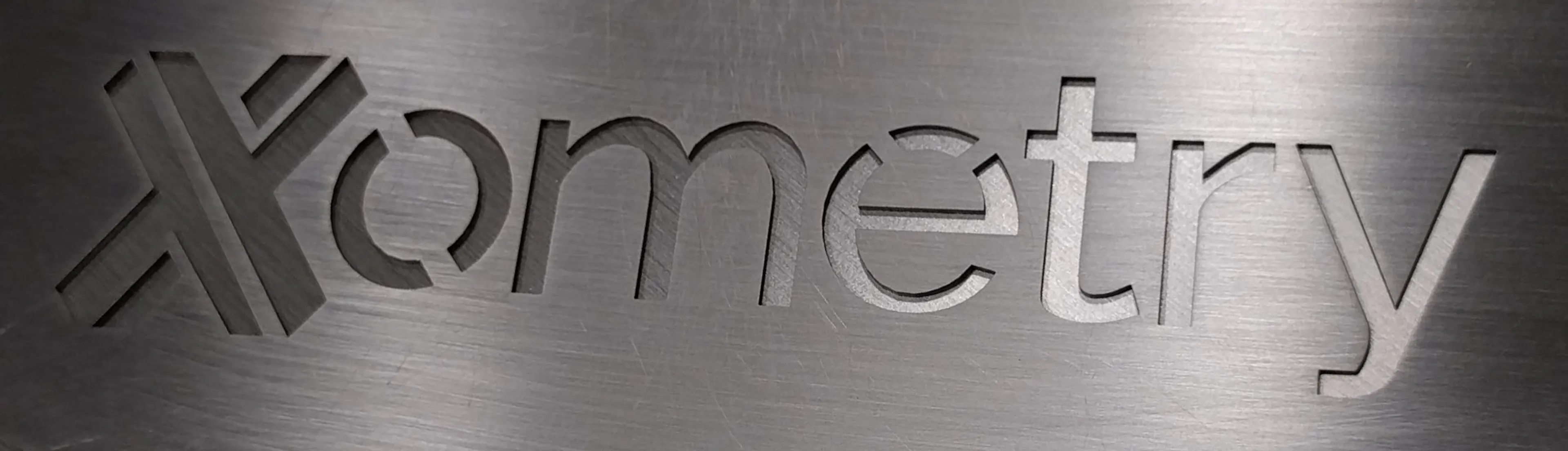

Explode Your Text
When text is added to a design, it may be in an active state, meaning that although the text is visible on the screen, it may not actually be outlined for laser or waterjet cutting. Make sure to convert text to a shape with an outline or “explode” the text so it can be cut on the model.
An example of "stencilized" text on a sheet cut part.
It is also important to add joining or “stencil-like” bridges on free-floating text features like the holes in D, O, P, Q, or other closed-loop characters. Otherwise, the letters will just be a letter-shaped hole! The 3D viewer on Xometry's quoting page will show you what features are registered. Learn more about preparing your DXF files.

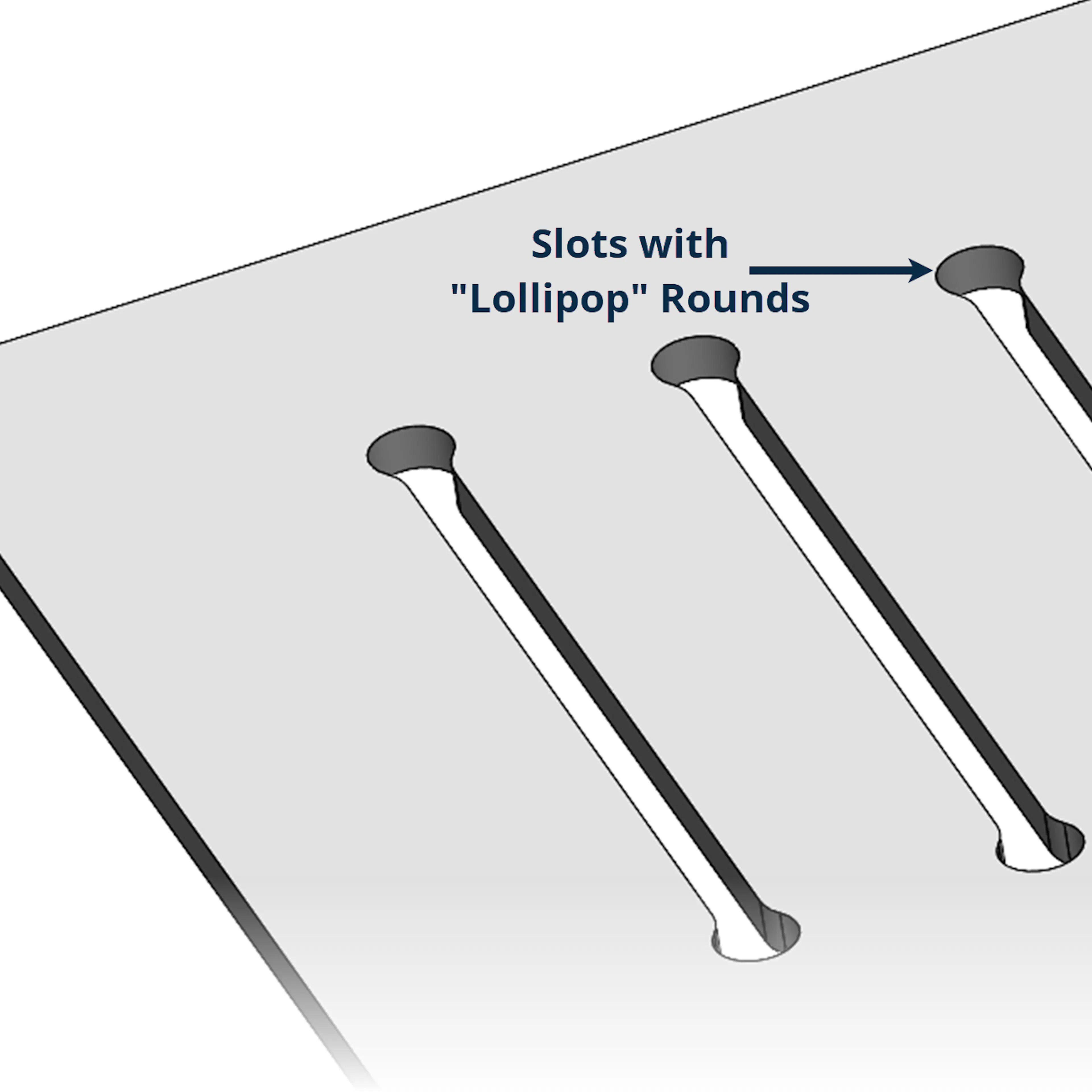

Notches and Slots
Notches and slots must be designed in the file, even if they are at the kerf thickness of the sheet cutting process. For example, a notch or slot of 0.040” should be designed to that width. It is recommended for slot features to have exaggerated “lollipop” rounds on at least one side to help compensate for the pierce hole, which will be larger than the cutting thickness (kerf).
