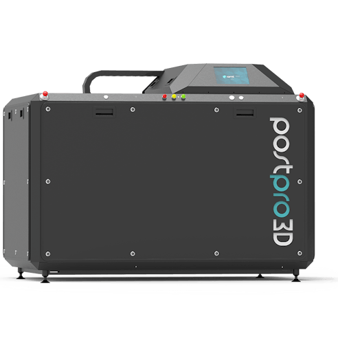

    Xometry has adopted AMT’s PostPro3D chemical vapor smoothing technology. Unlike physical smoothing processes such as sanding or media tumbling, vapor smoothing does not remove material on the workpiece. Instead, a vapor finishing agent (FA 326) is introduced into a sealed processing chamber with the parts. Although the finishing agent is the same, different processing parameters are used for different materials and geometric features. Parts are racked, or hung, in a 600 x 400 x 400 mm chamber to maximize the surface exposure to the vapor. The vapor clings to the part surface where it creates a controlled chemical melt. This melt reduces the surface peaks and valleys by liquifying and redistributing material and evening the surface. The melt also has the effect of enhancing shine.
    Once the parts are finished, the chamber is heated to evacuate the finishing agent to a collection vat. No residue is left on the parts. Smoothed parts are then ready for shipping or another secondary process such as dyeing.
      AMT PostPro3D vapor smoothing machine

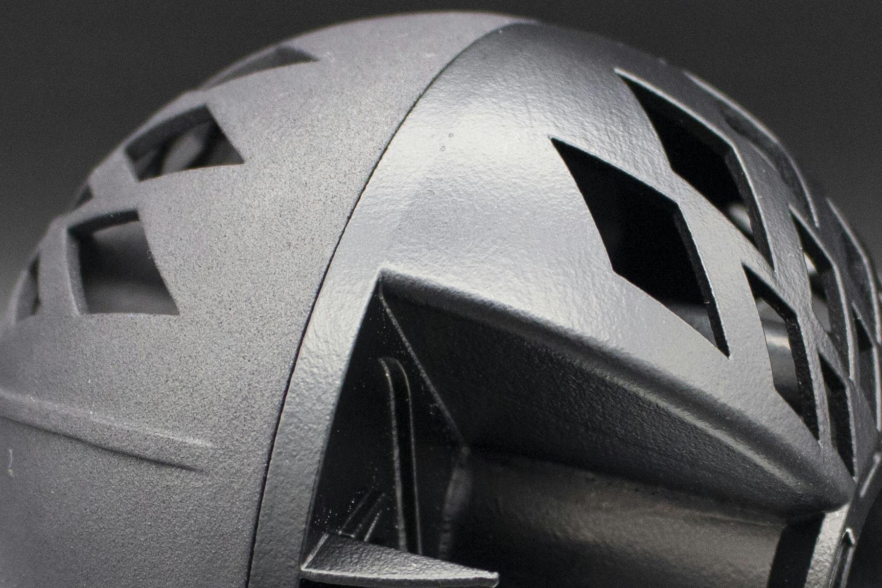

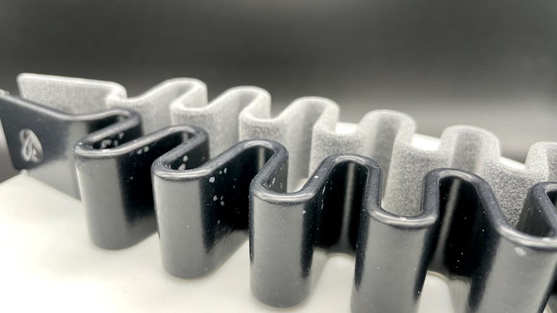

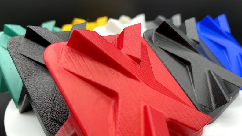

        Vapor smoothed parts have improved cosmetics and are comparable to injection molding surface finishes. Standard SLS parts typically have a surface roughness greater than 250uin Ra, but with chemical vapor polishing can improve to below 125uin Ra and as low as 40uin Ra. In some studies, chemical vapor smoothing improved material surfaces by 800%-1000%. It is important to note that chemical vapor smoothing re-distributes surface material to provide a sealed, smooth surface but it does not create a polished surface. There will still be visible surface topology and minimal layer lines.

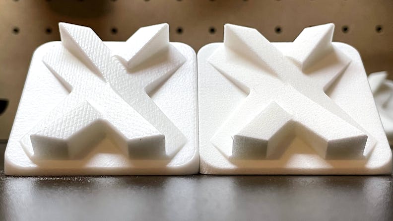

        Comparing a vapor smoothed and standard finish SLS nylon 12 part
        3d printed X's
        Xometry logo in nylon 12
        Vapor smoothing
        Vapor smoothed SLS versus unsmoothed SLS

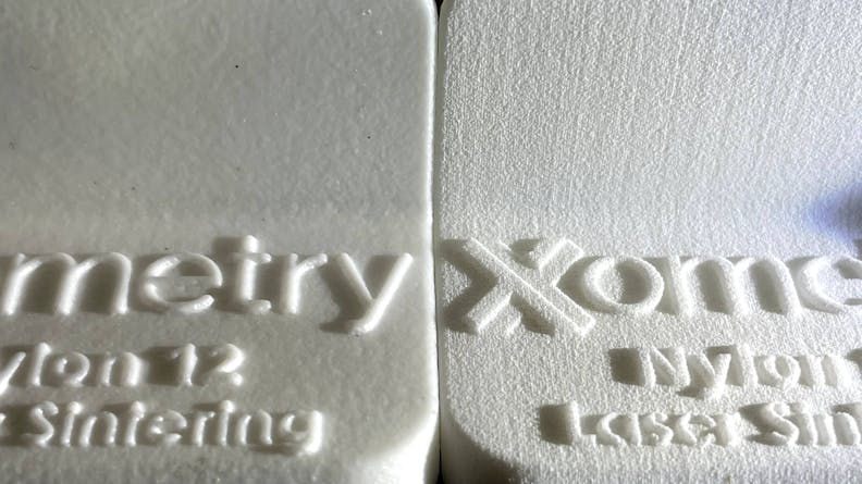

        Surface roughness of chemical vapor smoothed SLS part (left) next to a standard finish part (right)
