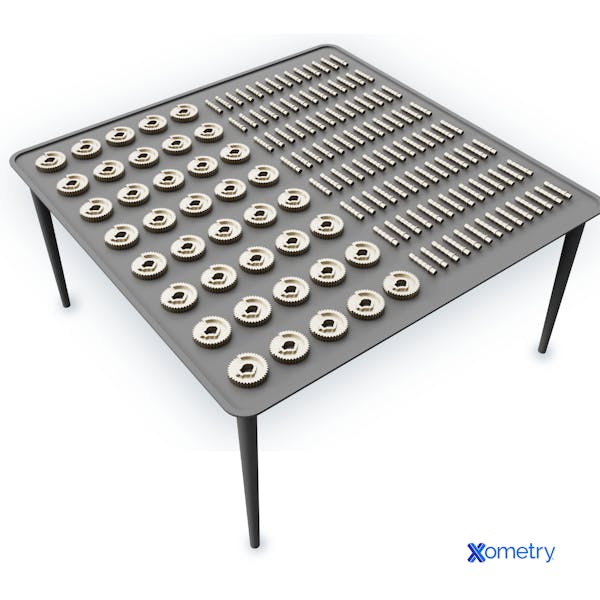

Parts made with metal injection molding
MIM is a great way of making parts that are small and rather complex in terms of features. It also doesn’t require a molten metal feedstock like other methods do. That’s because it only really uses high temperatures during the sintering process. That’s also good because you can use materials with really high melting points without having to worry about processing and handling them in their molten form. A few potential drawbacks with MIM include the fact that these machines and their tools tend to be expensive. The molds don’t last too long because of the abrasive nature of the metal powder, and the parts need quite a bit of post-processing, which also bumps up the cost. Also, as mentioned, the parts shrink quite a lot. So you’ll need to take this into account beforehand to make sure parts meet your size requirements.
