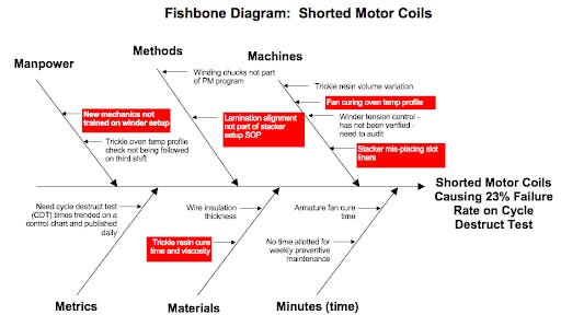

2. Fishbone Diagram
A fishbone diagram is a visual tool that graphically represents the potential root causes. The illustration consists of 2 key elements: the head represents the effect or failure, and each “bone” represents a category of potential causes. They are as listed:
  • Machines
  • Methods
  • Materials
  • Manpower
  • Metrics
  • Minutes (time).
Each of these categories will make up one bone of the diagram.
Once filled out, the diagram determines the root cause by identifying repeated causes or the frequency where they appear. Alternatively, the team reaches a common consensus on the root cause based on new insights gained through the process. One disadvantage, however, is the potential of trying to solve every problem identified instead of those directly contributing to the ultimate failure.

An example of a fishbone diagram
Source: Fishbone Diagram
