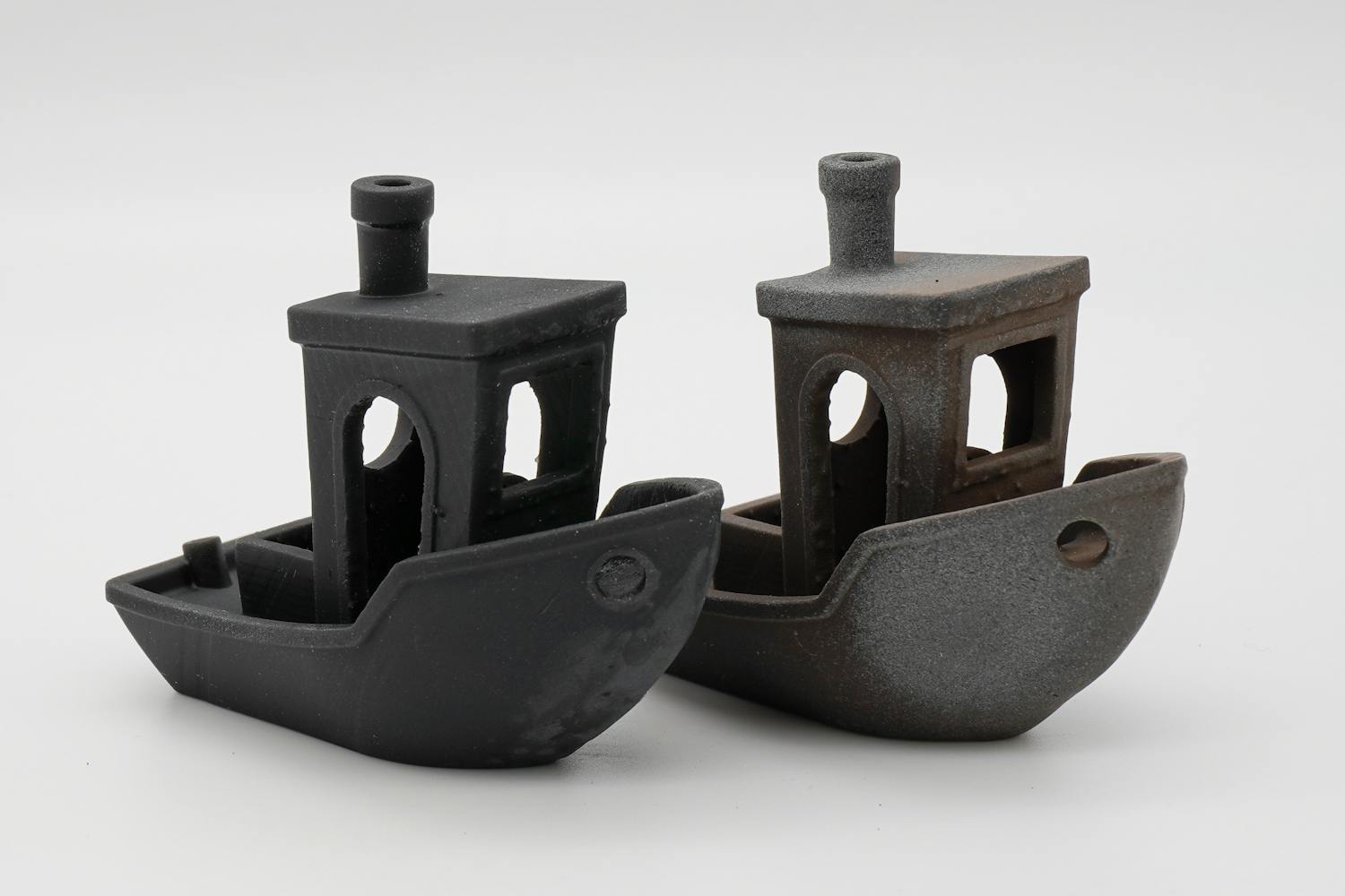

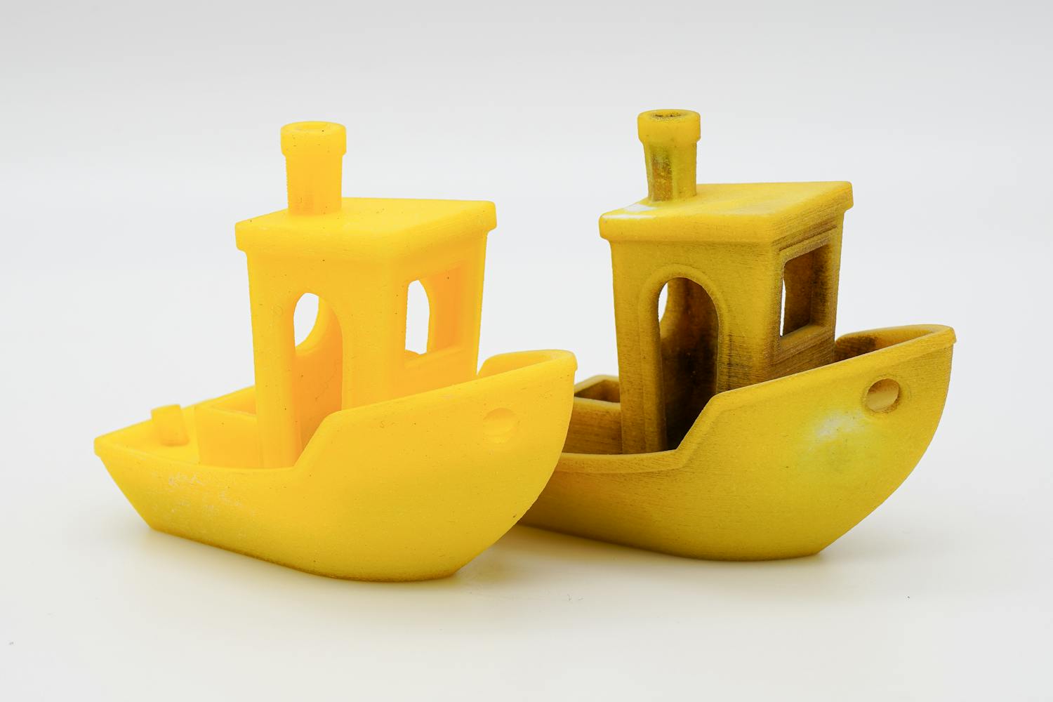

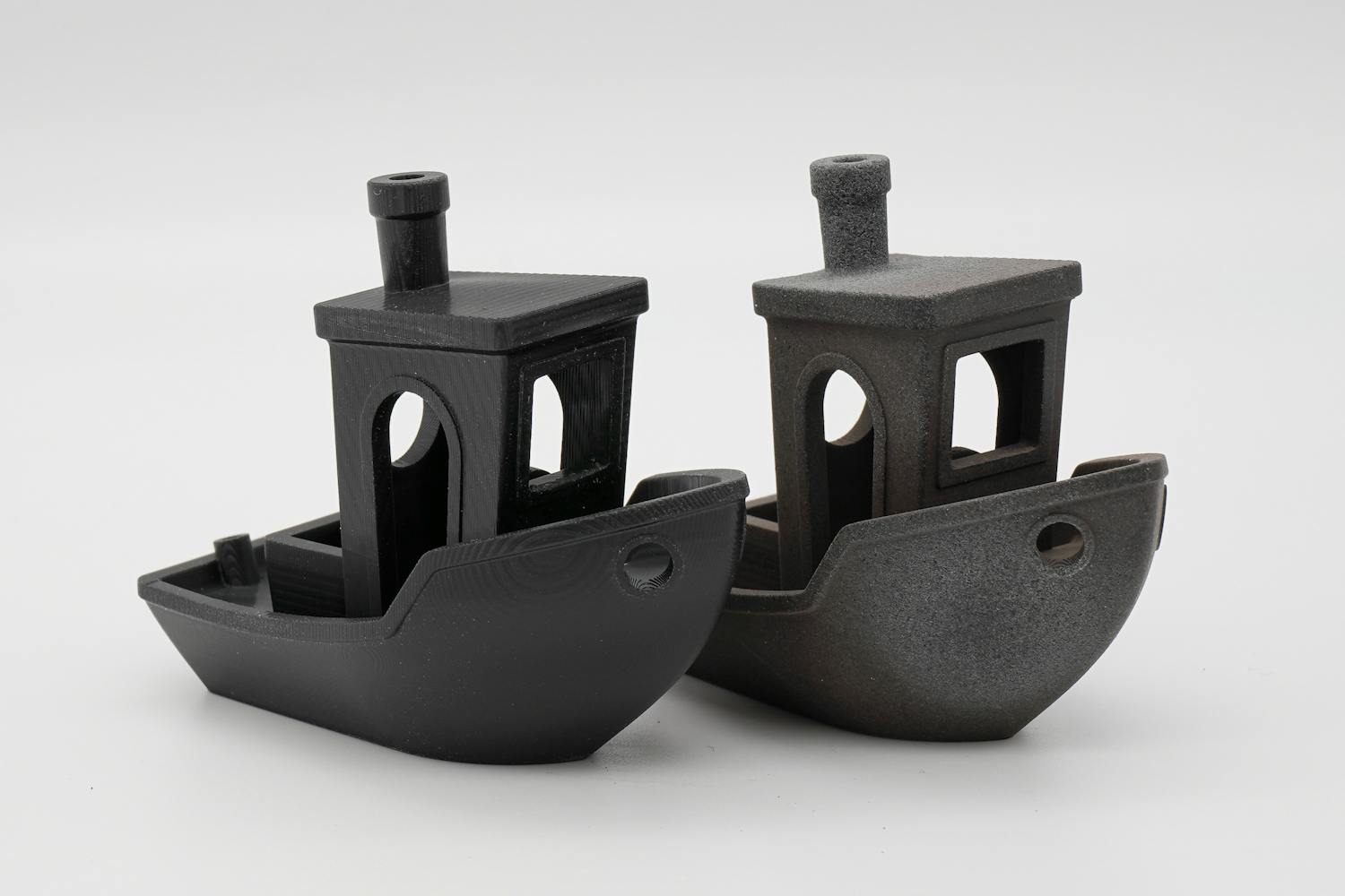

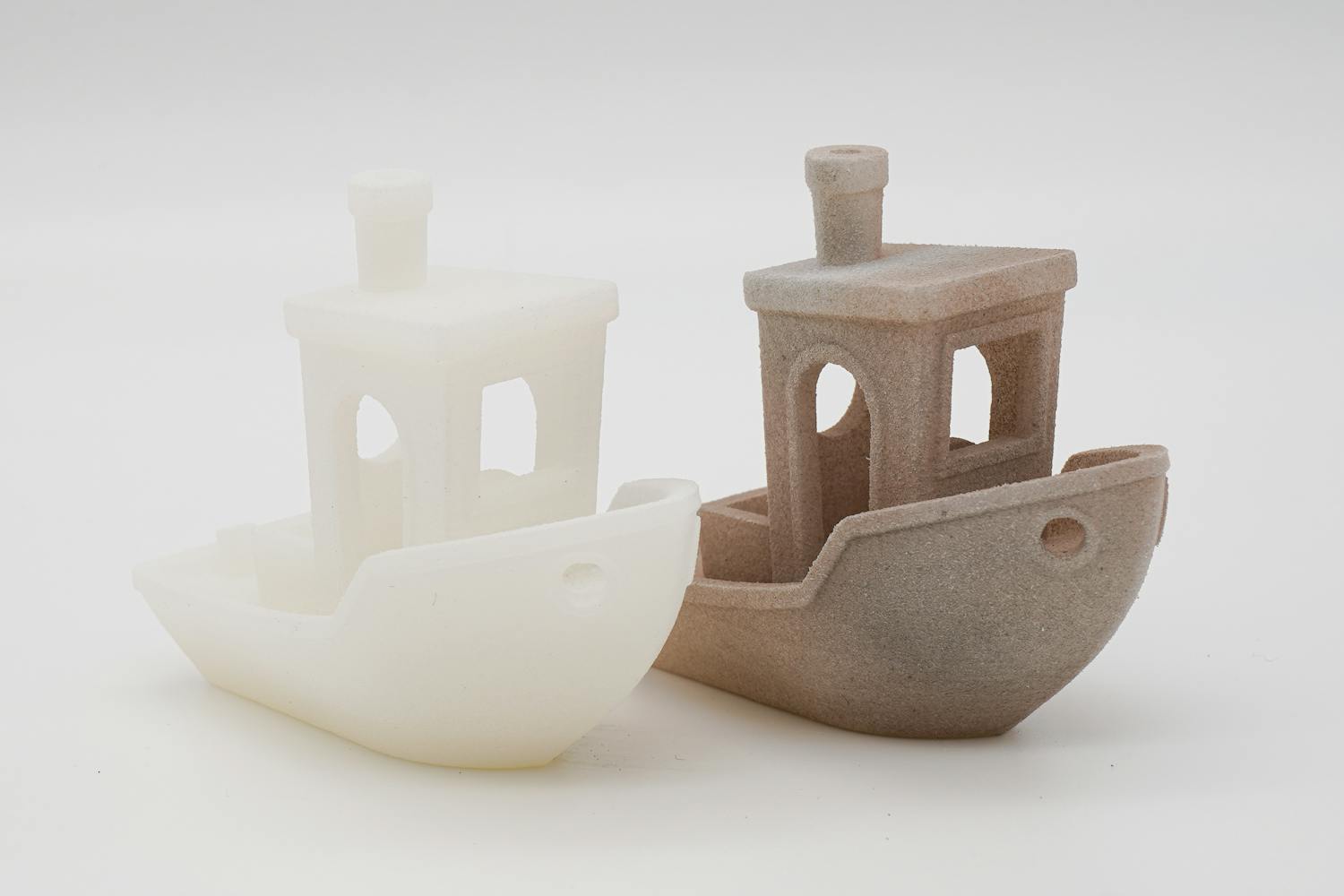

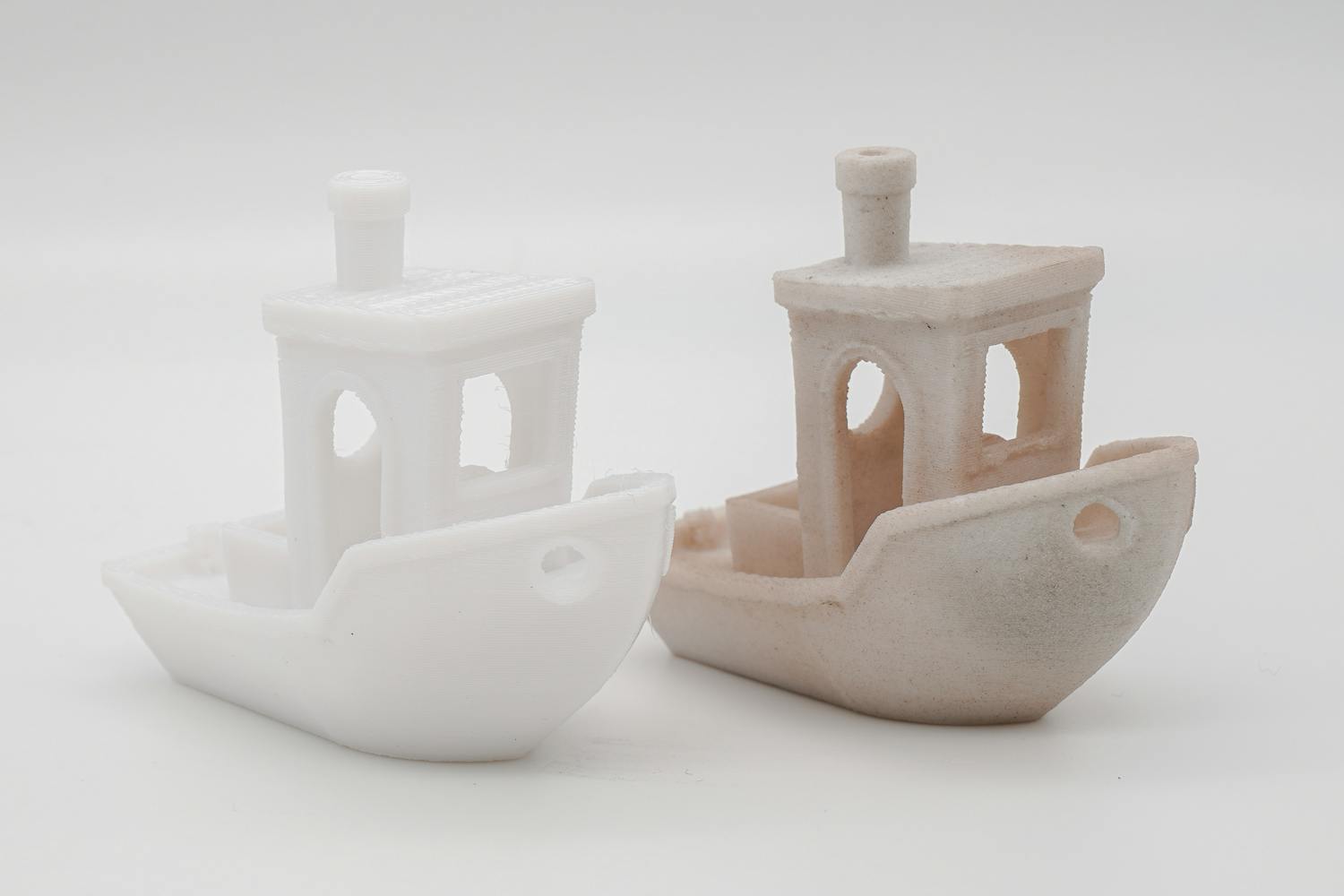

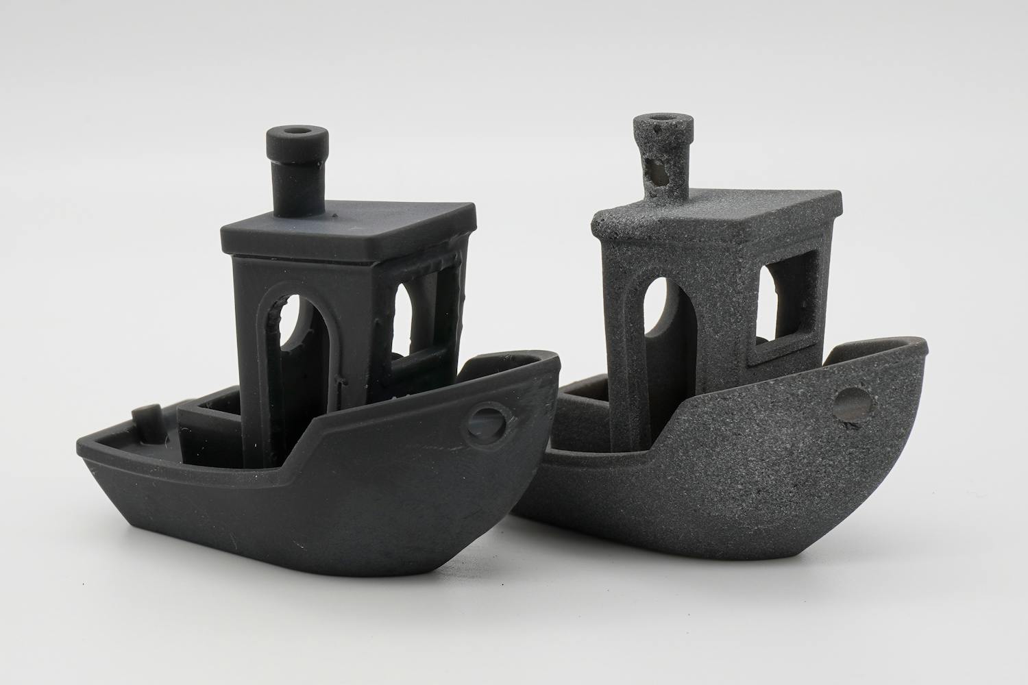

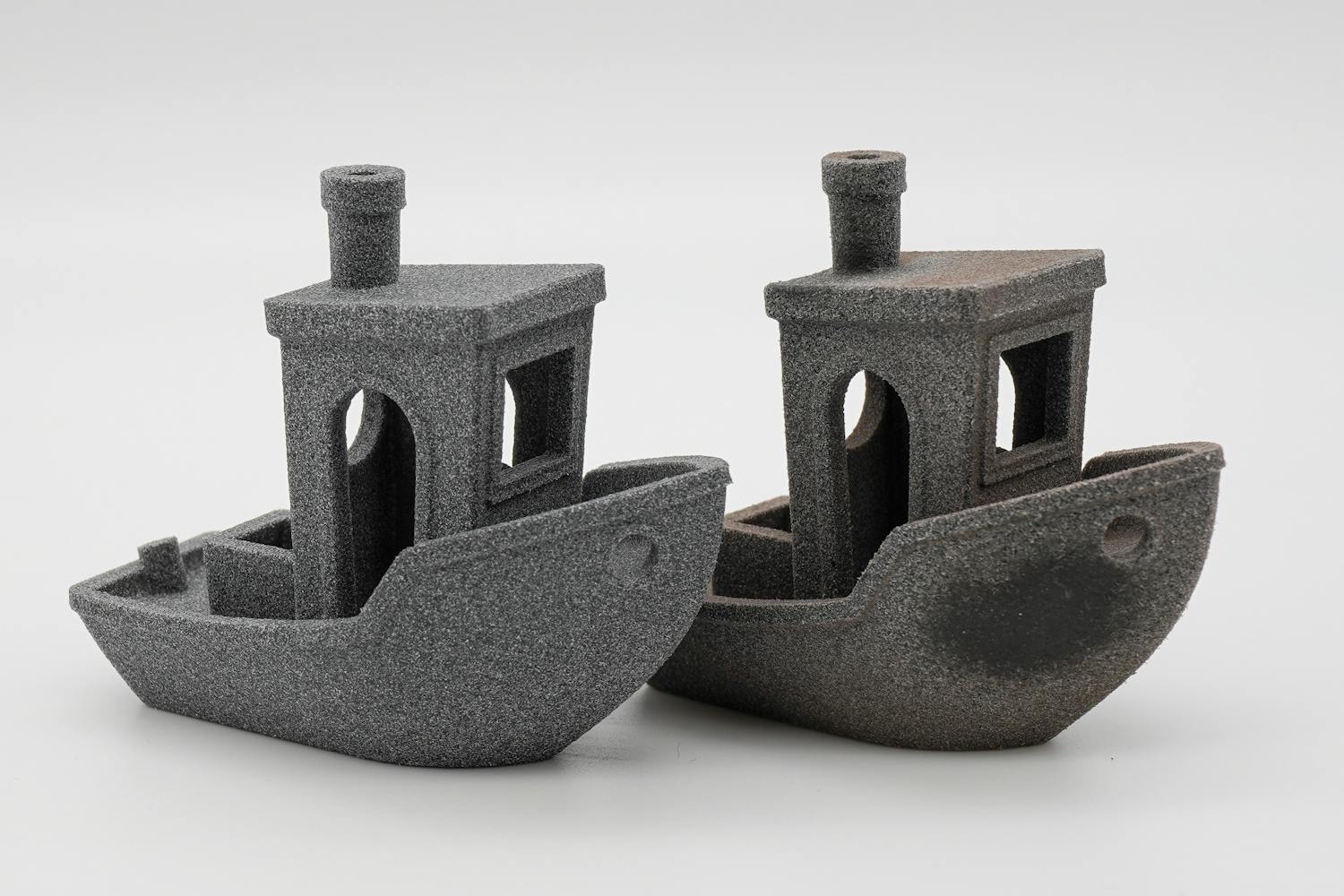

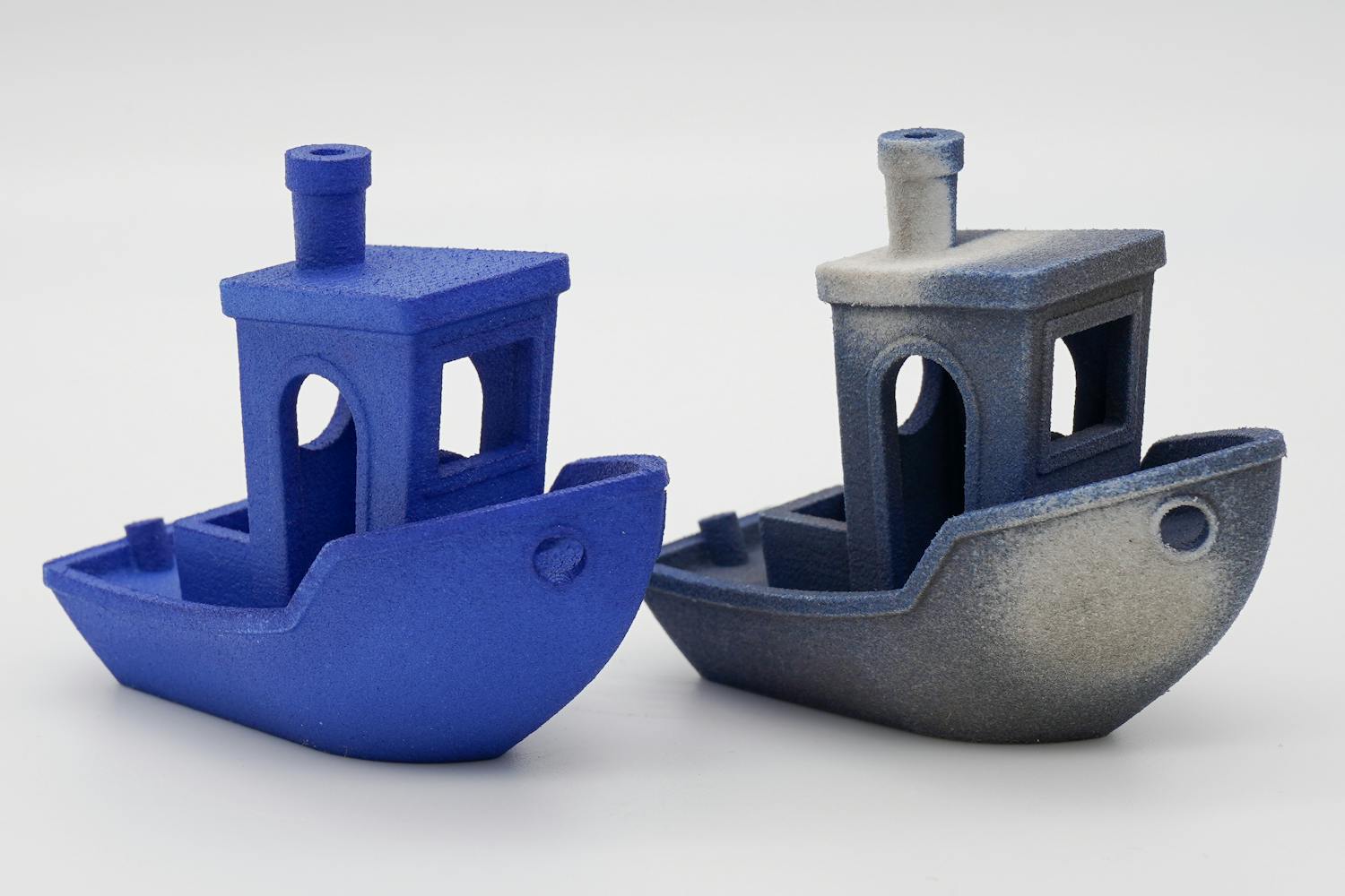

We performed this test with the popular "3D Benchy", a 3D model specifically designed for testing and benchmarking 3D printers. In this first part of the series, we tested the abrasion resistance of various materials ranging from thermoplastics to photopolymer resins by media blasting them with an aggressive aluminum-oxide media. Here is a list of the processes and materials we tested:

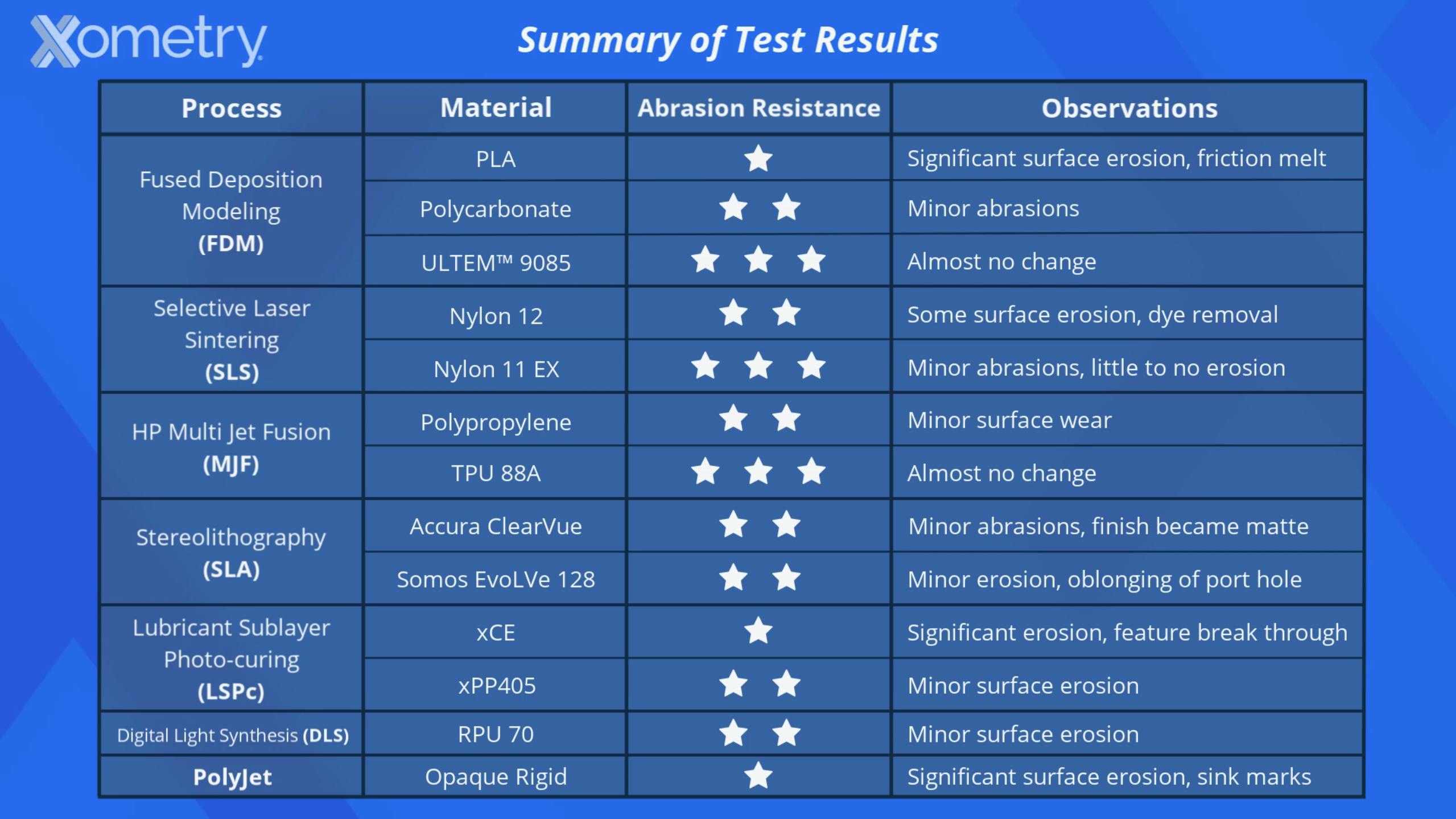

At the conclusion of the media blasting abrasion tests, we assigned an abrasion resistance ranking to each material based on how it performed. 1-star rated materials exhibited poor abrasion resistance, exemplified by issues such as surface erosion, feature loss, abrasions, etc. In contrast, 3-star rated materials had excellent abrasion resistance and held up significantly better.
You can see the results from the test in the chart below:
Slide 1 of 1
Results summary from media blast abrasion test

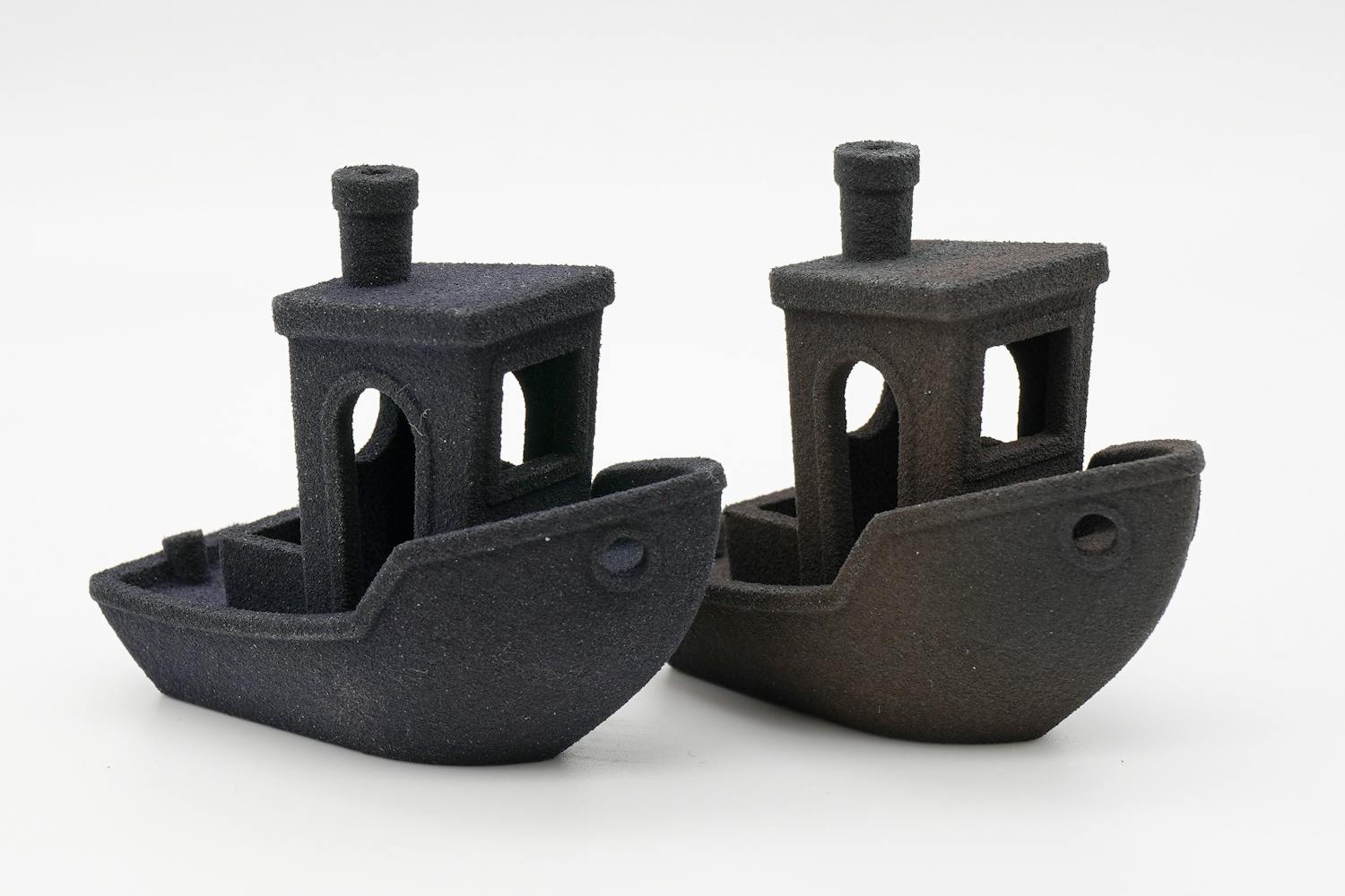

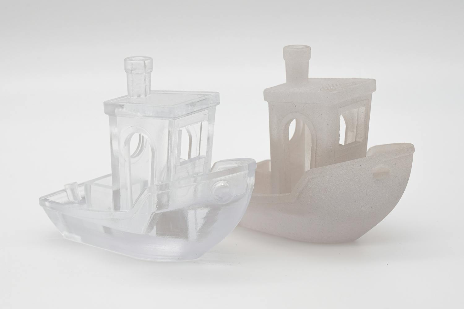

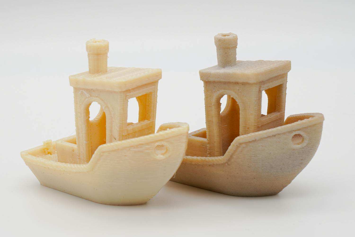

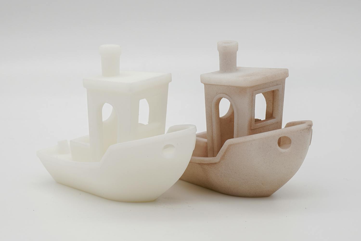

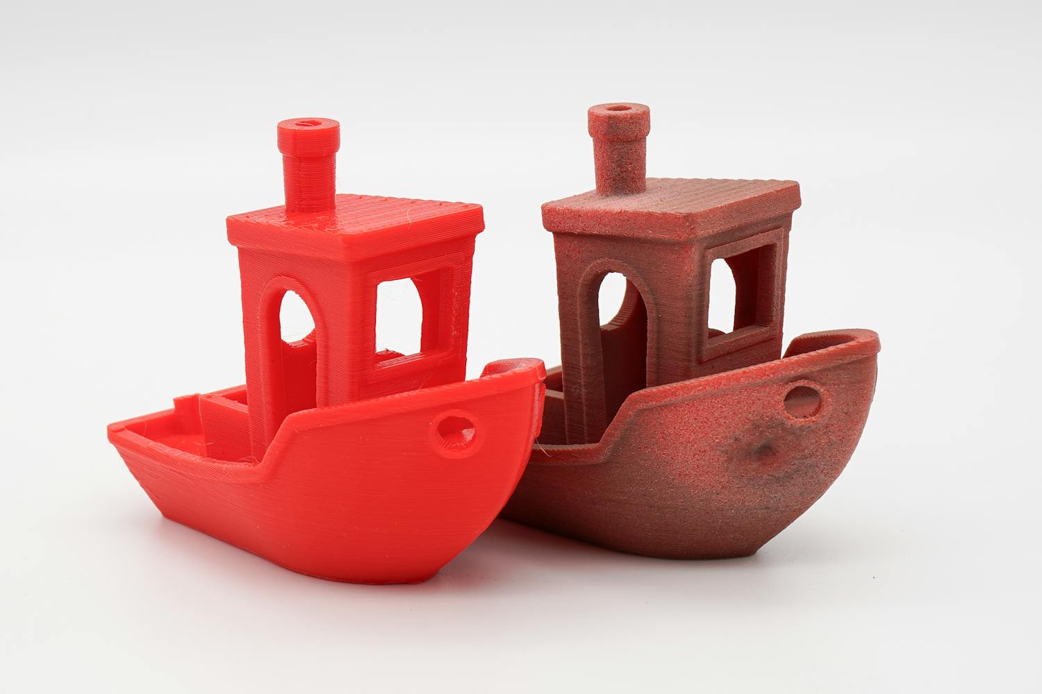

Before & After Photos
In the image gallery below, you can closely examine how each tested part changed by the end of the experiment. On the left side of each photo you will see what the Benchy looked like before testing, and on the right what it looked like after testing.

FDM - Red PLA

FDM - Tan ULTEM 9085
SLS - Nylon 12 (dyed blue)
SLS - Nylon 11 EX

SLA- Accura ClearVue (quick-clear finish)
SLA- Somos EvoLVe 128

MJF - Polypropylene
MJF - Polypropylene
