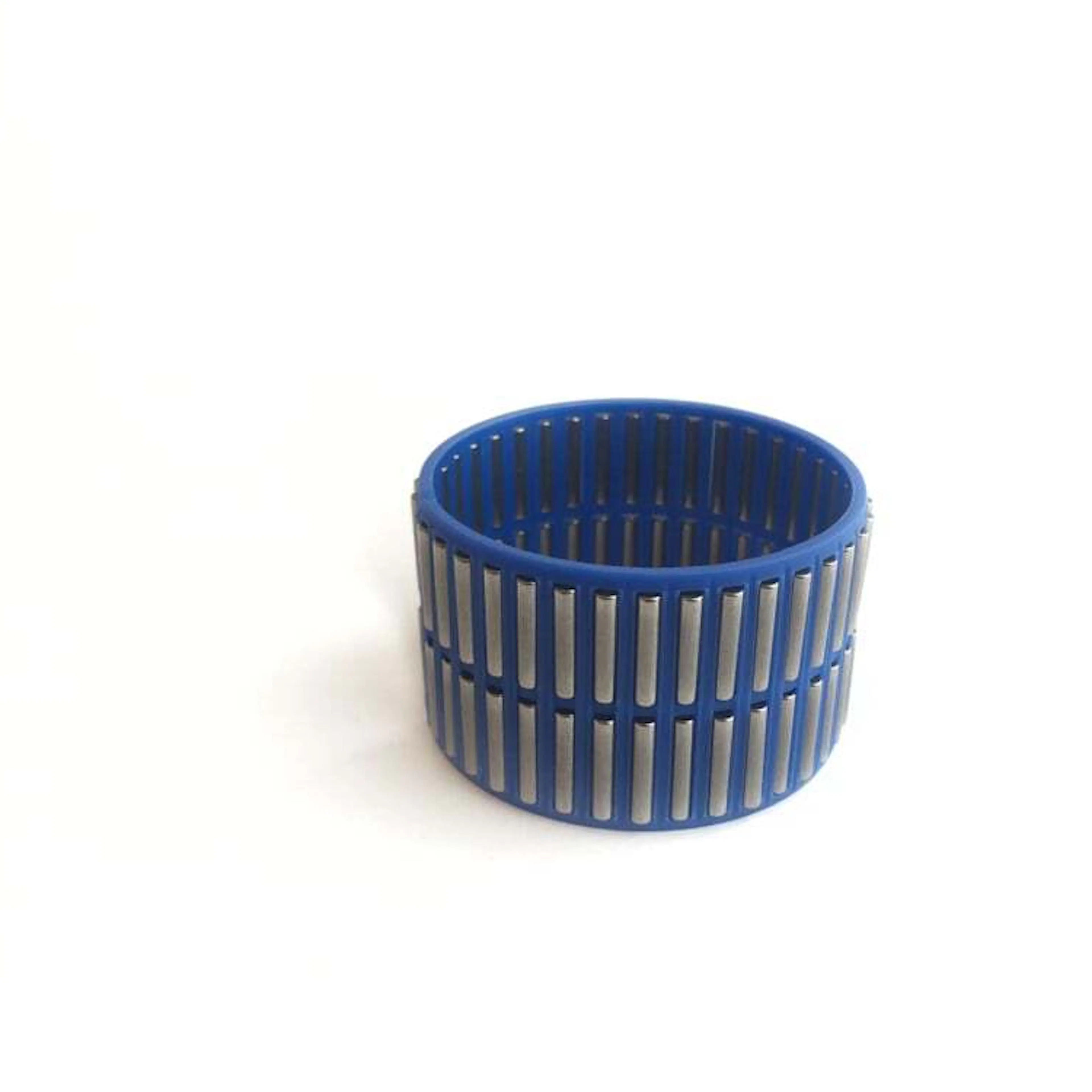

Needle bearing in a plastic separator. Image Credit: ALESHKIN VIACHESLAV/Shutterstock.com
