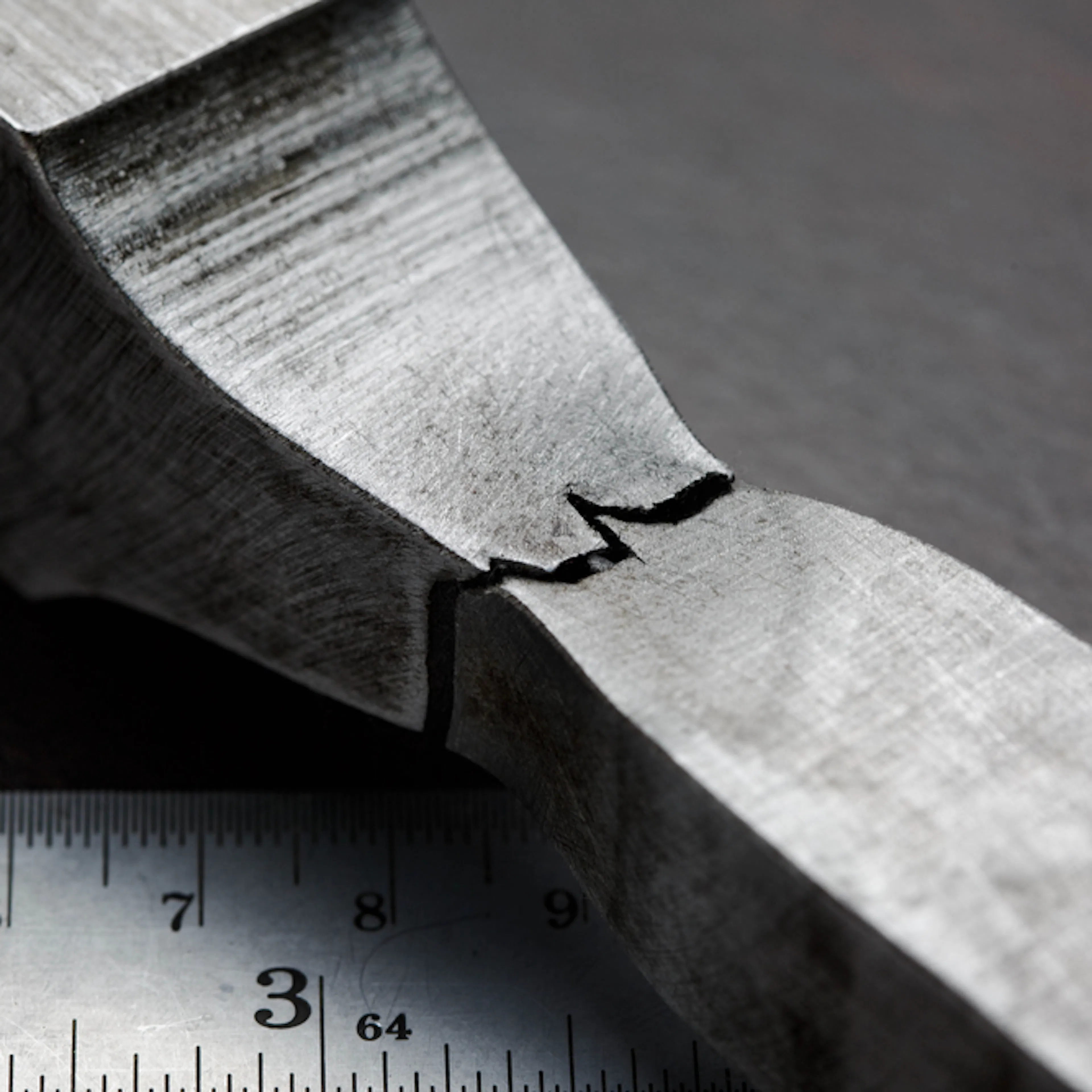

Tensile test. Image Credit: Shutterstock.com/Kimtaro

Ultimate tensile strength is a measure of the load that can be applied to a material before it fails. The tensile strength of a material is measured using a tensile testing machine which applies a pulling load to a test specimen until it breaks. The rate of elongation and load of the force applied can be used to calculate the material properties. The ultimate tensile strength of a material can be found by dividing the force required to break a material by its original cross-sectional area. This article will define ultimate tensile strength, how it works, its calculations, and give some examples.

A tensile test is performed to calculate the ultimate tensile strength. First, a test specimen is prepared into a “dumbbell” shape to ensure the part breaks in the middle. The specimen’s cross-section is then measured and recorded. After that, the part is loaded into the tensile test machine. The machine will apply a load until the test piece fails. Most modern tensile testers can record the force applied and use the cross-section to display the tensile strength automatically once the test is complete. If not, the force and cross-sectional area can be put in the formula:
