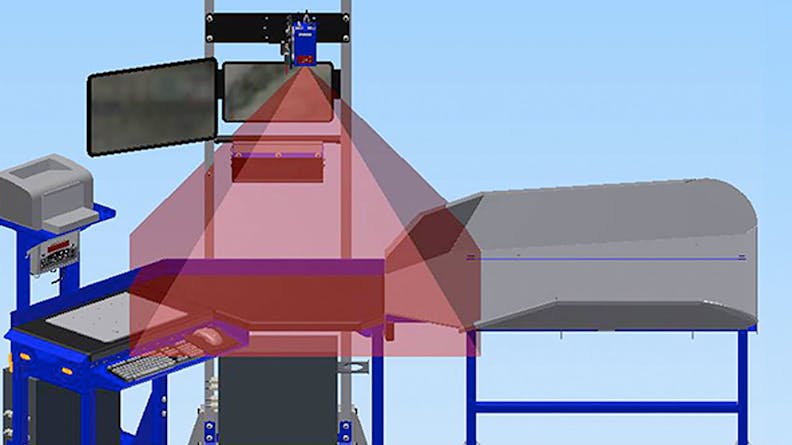

The finished product. This POST-IS assembly includes a sophisticated camera that can accurately count and route packages. (Source: POST-IS).
