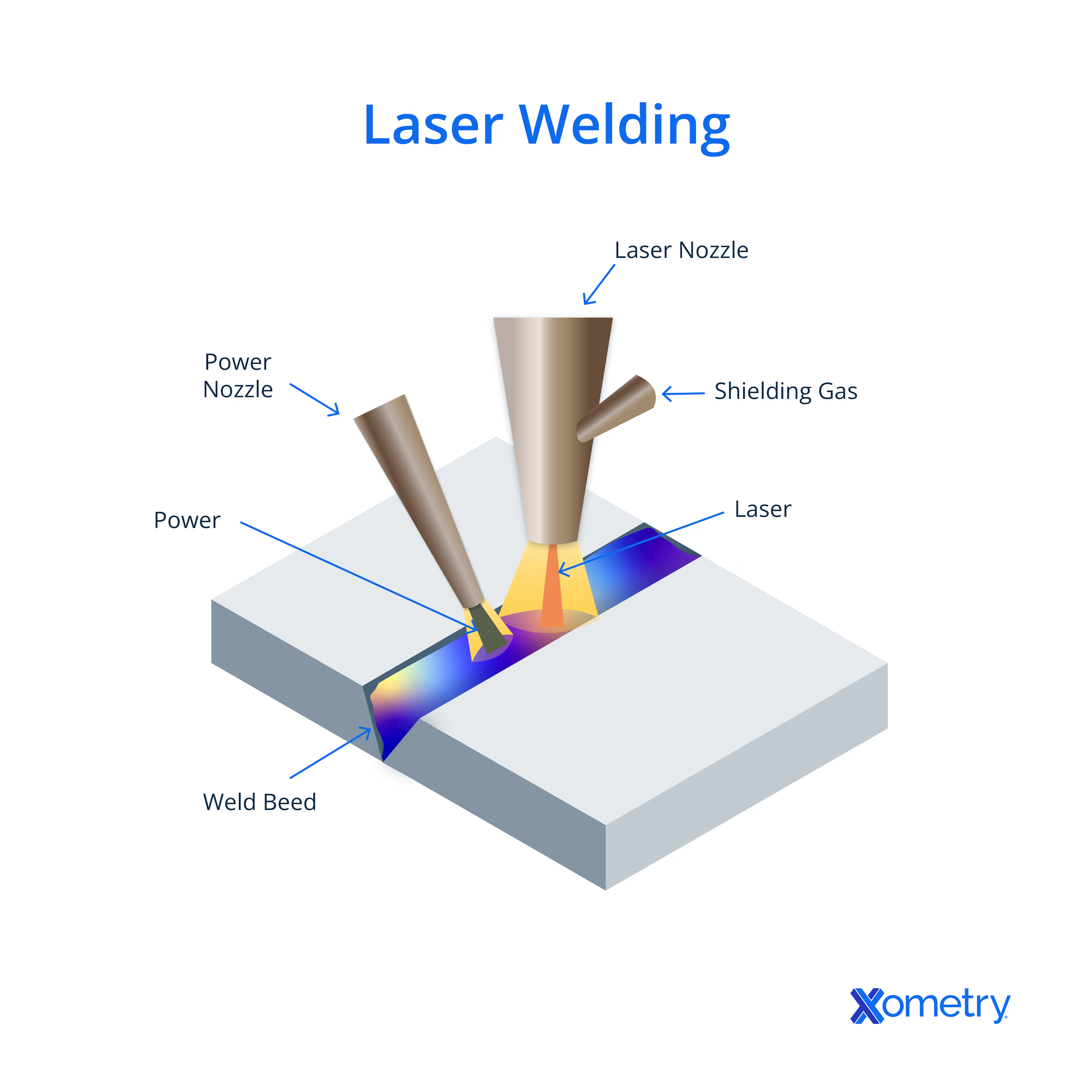

Laser welding is an advanced fabrication process that is used in industries including automotive, medical, aerospace, electronics, jewelry, and tool and die manufacturing. The laser welding process uses an intense laser to apply heat to the seam which fuses the two materials. Laser welding’s main advantage over traditional techniques is that it is cooler, resulting in fewer internal stresses in the joint. This process achieves a strong bond in applications in which the weld only penetrates less than 1 mm deep.

In comparison to traditional welding methods, laser welding is much more efficient and the output is of a much higher quality. Laser welding functions as a beam of light that provides a concentrated heat source to melt materials, which then fuse upon cooling. Therefore, the application of laser welding requires less heat than conventional welding methods as the heat-affected zone (HAZ) is much smaller and more concentrated. As there is less heat required, this also translates to a lower risk of distortions and deflections in the final output, making it much higher quality. The processing speed of laser welding is much greater than traditional welding methods, making it far more efficient.  For more information, see our guide on What is Laser Welding?
