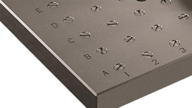

Pictured above is a typical Fixture Plate. Some things to note about it:
  • There’s a grid of threaded holes there.  They’re protected from chips by set screws that you remove when you’re ready to use a particular hole.
  • Engraved letters and numbers create a coordinate system to uniquely identify each hole.

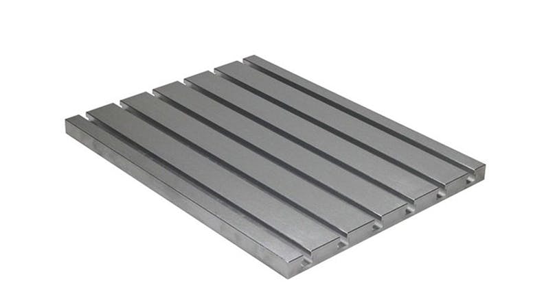

Install a Fixture plate on your CNC Mill’s table.  Most CNC mills have T-Slot tables like this one:
t-slot table
Secure Workholding devices such as fixtures and vises to the machine’s table using bolts and T-Slot nuts as seen below. The nuts slide along the T-Slot until positioned where you want them. With a fixture plate, bolt fixtures on using the threaded holes in the plate.

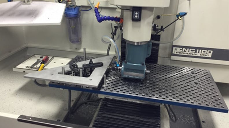

Tosa Tool Fixture Plate
Note that some of the stand-offs for this right angle drilling rig are off the table.  Handy to have a larger fixture plate!
It still fits fine in the PCNC 1100 enclosure.  Plus, the larger size means there is room for fixture related stuff to sit outside the work envelope.  That can be important when trying to use the full envelope.

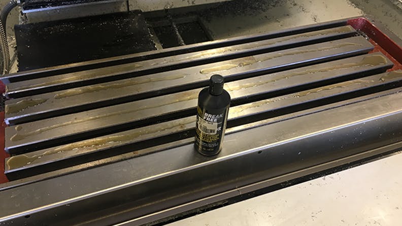

2. Clean your machine’s table so there’s no chips or debris.  Stone away any nicks and imperfections.  You want a good surface for the Fixture Plate to lay on.
3. Lay down some rust preventative on your machine table.  I like to use a product intended for firearms called “Break-Free.” It’s available inexpensively from Amazon–about $22 for a nice spray bottle as I write this. I use it constantly around the shop to rust proof my tools.  Put down a lot more than you think you need.  I made a virtual oil slick that made it easy to slide the Fixture Plate around until it was position perfectly.

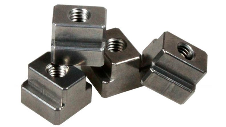

7. Install 3 T-Slot Nuts, one in each slot.  Position the top and bottom at the right end of the T-Slot.  Slide the middle one as close to the center as you can reach.
8. Pivot the other way to expose the T-Slots on the left side.
9. Install 2 T-Slot Nuts in the top and bottom T-Slots on the left. Position them at the end of the T-Slot.

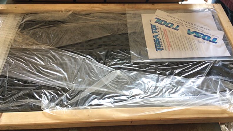

Packed in a Wooden Crate, not Cardboard
My Tosa Fixture Plate arrived in a nice wooden crate.  No cardboard here!  It’s a precision component, so I appreciate the extra protection afforded by the crate.

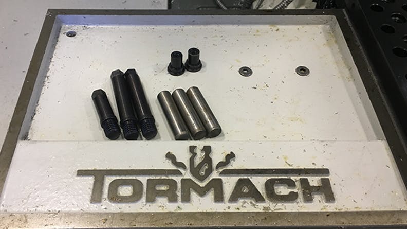

Keys for the T-Slots
I love the key system for aligning the Tosa Tool Fixture Plate to the machine’s T-Slots.

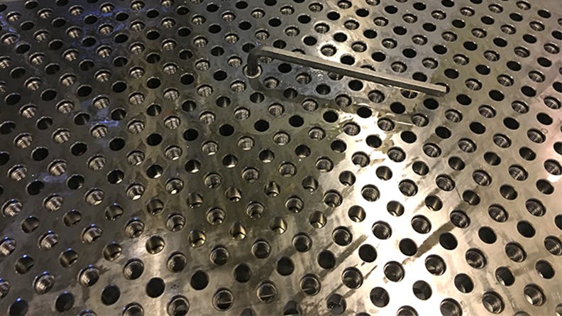

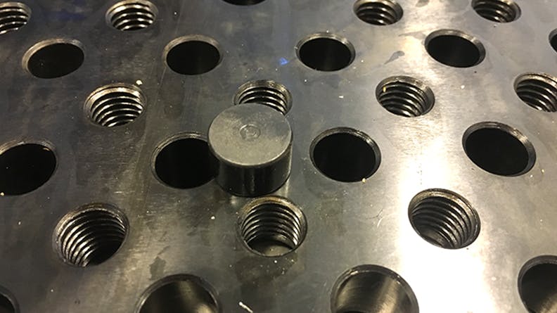

Mixture of Dowel Pin (Smooth) and Threaded Holes
The hole grid on a Tosa Tool Fixture Plate alternates smooth (dowel pin) and threaded holes.  The threaded holes take 1/2-13 bolts, and the dowel pin holes are 0.5005″ in diameter and finished smooth.
Why 2 kinds of holes?
Some vendors tap every single hole on the plate, but having both smooth bore and threaded holes is a better design.  When using a Fixture Plate, the holes perform 2 functions:
  • Location: This is the role of dowel pin (smooth) holes on the Tosa Fixture Plates.
  • Fastening:  This is the role of threaded holes.
If we make one hole perform both functions, we reduce the tolerance and repeatability with which we can perform the Location function. Imagine dropping a dowel pin down two bores.  One is half or even 1/3 as long as the other.  Remember, we’re talking 1/2″ diameters in bores that are 3/4 to maybe 0.8″ deep.  There’s a chamfer at the top and bottom so we have even less length available.  Which bore is going to hold the pin more accurately vertical and in position?
My money is on the full depth bore.  If you do go with a combination bore (threaded and smooth sections), make sure the smooth section is at least 1 diameter in depth so dowel pins are positioned with sufficient accuracy
In addition, if we have to thread a shorter length to make room for a Locating Dowel Pin, we reduce the amount of thread available for fastening.  What will that do to the strength and stability of our workholding solution?

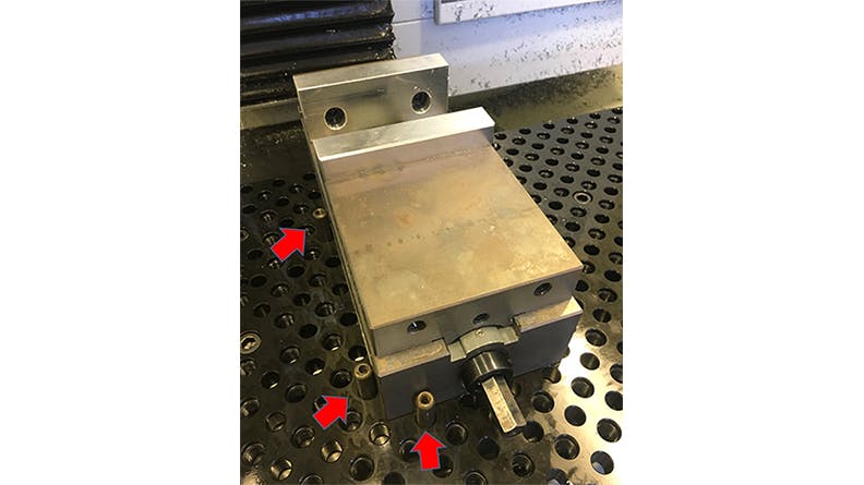

Now that you’ve got a Fixture Plate on your mill, let’s do something useful with it.  Consider setting up a vise on the Fixture Plate.  We’ll use our normal clamps to mount the vise, except that they’re screwed into the fixture plate instead of T-Slot Nuts.  I’m not going to bother showing that because it’s nothing new.
But here’s what is new:
We can ensure the vise is installed repeatably in the same location and perfectly trammed very easily.  Basically, the Fixture Plate locates your vise in the Z direction, so what we need to do is repeatably locate the rectangular base to an exact location and make sure it’s square.
Doing that requires us to locate 3 points, which are shown below. I’m using some dowel pins that are part of Tosa’s modular fixturing kit. It comes with a variety of gizmos.
Using dowel pins
To use the three pins, place the vise on the Fixture Plate and slide it up against the two side pins.  This locates the vise on the X-axis and ensures it is square (trammed) to the Fixture Plate.
Next, slide it back so the rear edge contacts the rear locating pin.  That locates the vise on the Y-axis.
We’ve now located the vise on all 3 axes and ensured it is square to the table.  If we take care while clamping to ensure the vise remains in contact with the three pins, we will have installed it ready to go in a very short time.  No tramming required!
We can set up a work offset on the machine for the left corner of the fixed jaw, and the g-code will also know exactly where to find the vise and can assume that corner is part zero.  Now if we design parts with that in mind, we save all sorts of time.
And, if we need to pull the vise off and use another fixture, we can put the vise back on when finished with the other fixture and not even have to change our work offset (assuming it still has the old value).

I would start by machining some keyed dowel pins that can be used to key the plate to the T-Slots.
Note that I’ll need 2 sets of these keys:
  • First set is extended reach.  It has to reach past the 1-2-3 blocks that will hold the plate off the table while I am machining through holes.
  • Second set is normal reach, and will be used once we’re done machining the plate supported on 1-2-3 blocks.
Making those keys is an easy job on a lathe.
