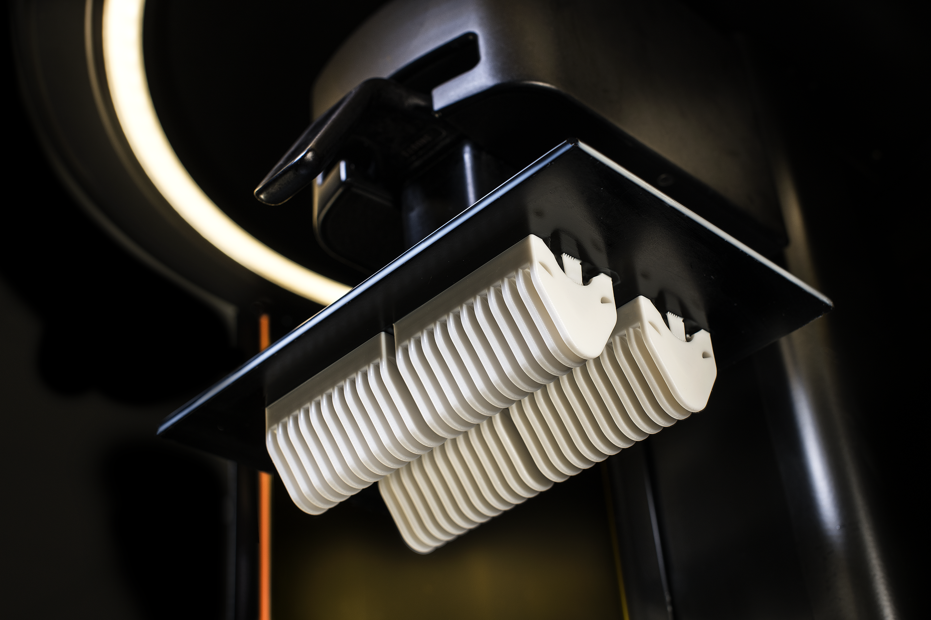

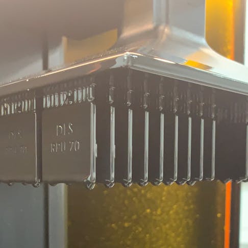

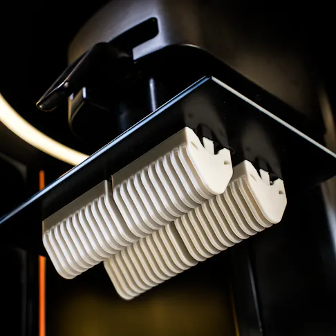

Carbon uses digital light projection, oxygen-permeable optics, and programmable liquid resins to produce products with end-use durability, resolution, and surface finish. This 3D printing technology is called Digital Light Synthesis™, or DLS for short. Another legacy term for the process is Continuous Liquid Interface Production (CLIP). Along with Carbon’s custom liquid resins, DLS unlocks new business opportunities and product designs previously impossible, including mass customization and on-demand inventory of end-use products.
Carbon bridges, and sometimes substitutes, for processes like Urethane Casting and Injection Molding service production, because the materials are urethane-based or epoxy-based, giving excellent mechanical properties. DLS elastomer and silicone resins outperform most other additive-manufactured rubber-like materials.
    Isometric illustration of the carbon DLS printing process.

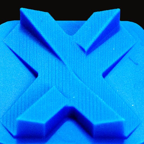

    Parts built with Carbon DLS technology will typically have a matte to semi-gloss surface finish depending on feature direction. Extended protrusions will show vertical lines in the part that are parallel to the direction of growth. Supports are removed and mitigated as required.

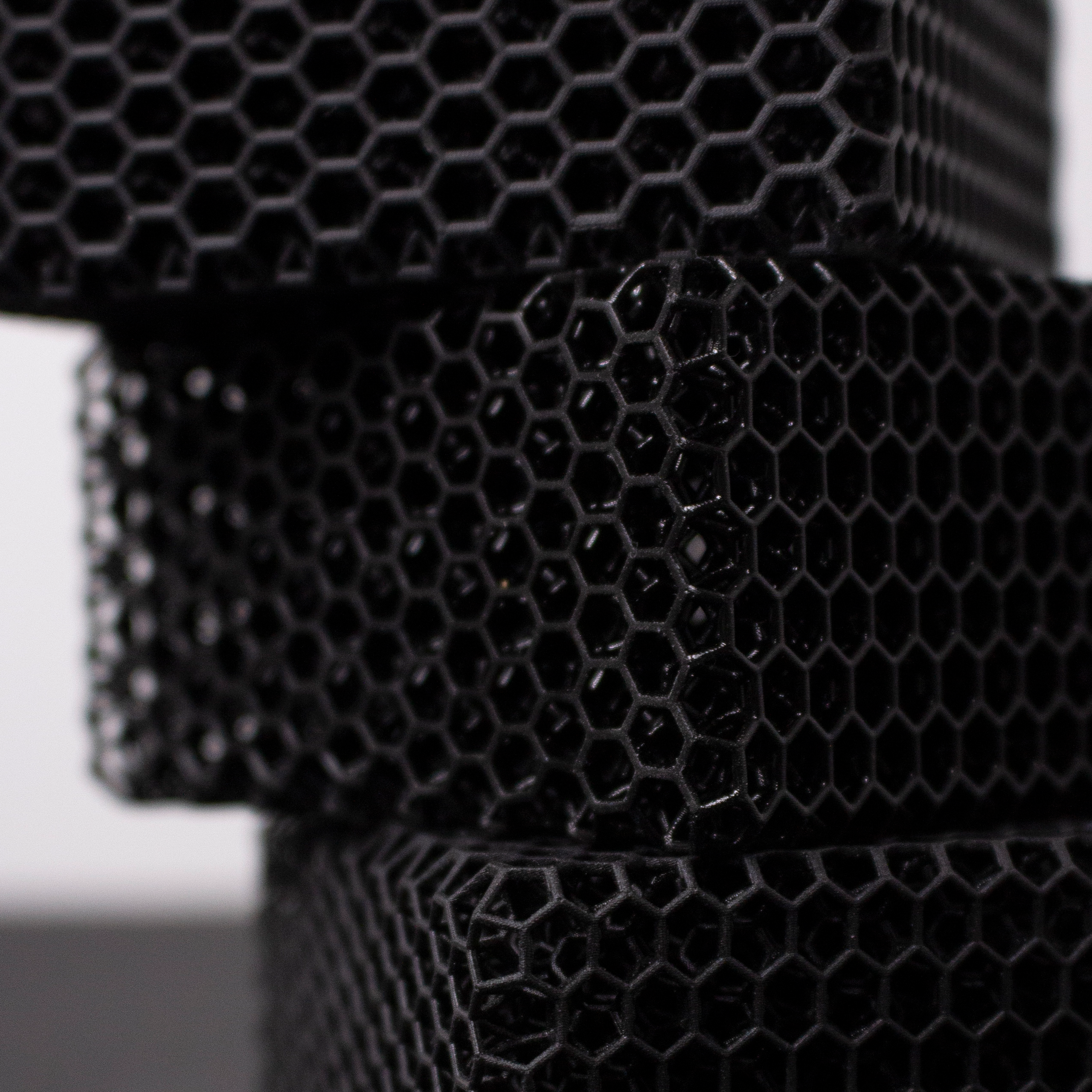

    Complex Shapes and Lattices

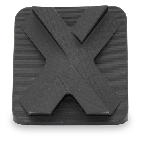

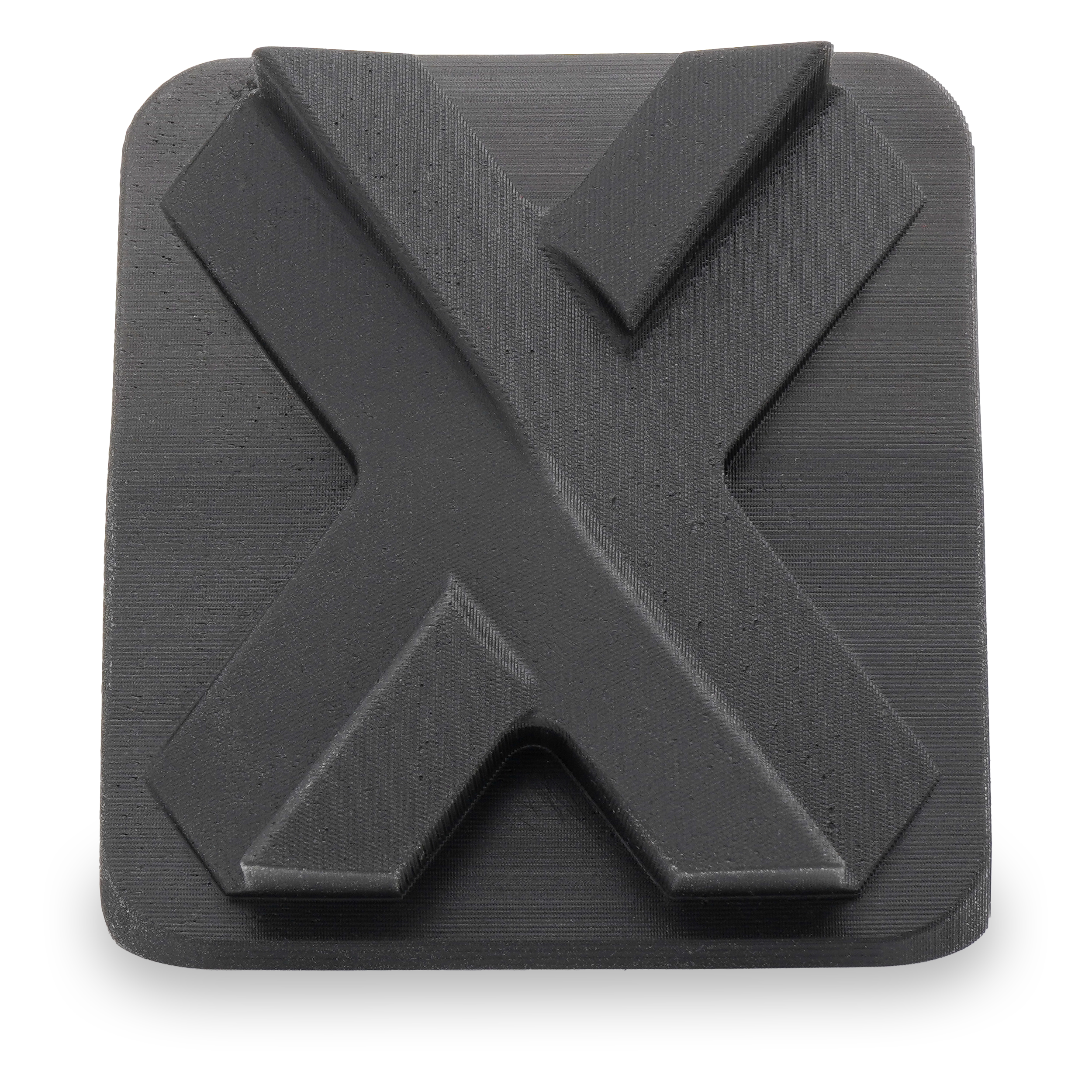

    What differentiates Xometry's Carbon DLS 3D printing service from similar resin-based processes like Stereolithography (SLA) or PolyJet is that the materials undergo a secondary thermal step, which activates dormant epoxies or urethanes, making parts much stronger than UV curing alone. Additionally, the digital light synthesis process is continuous, without stopping layer by layer as in most additive manufacturing processes. In addition to detailed, smooth surfaces, this gives the parts isotropic properties, meaning that their strength is the same regardless of orientation. This is a significant advantage over processes like Fused Deposition Modeling (FDM), where Z-direction features can be much weaker than similar features built in the XY-direction.
      Xometry tile in RPU 130 3D printed via Carbon DLS.
