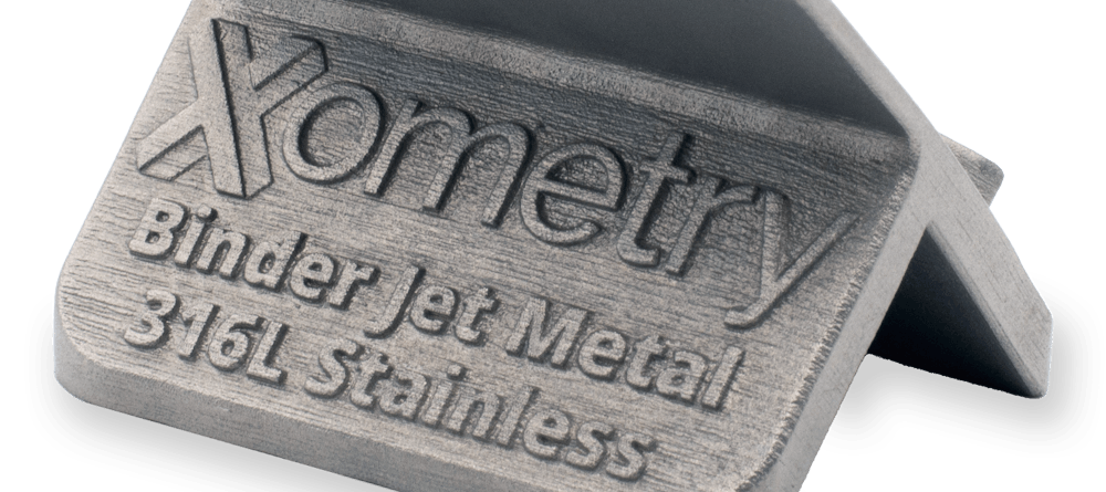

316L Stainless Steel is a single alloy, 98%+ dense stainless steel metal that offers superb corrosion resistance and excellent feature details. Zirblast finish.
316L SS exone printed gear binder jet
Applications for 316L Stainless Steel Metal 3D Printing
316L Stainless Steel from ExOne offers superb corrosion resistance and excellent feature details and cam be used in prototyping, R&D applications, serial and low volume production. See spec sheet.
