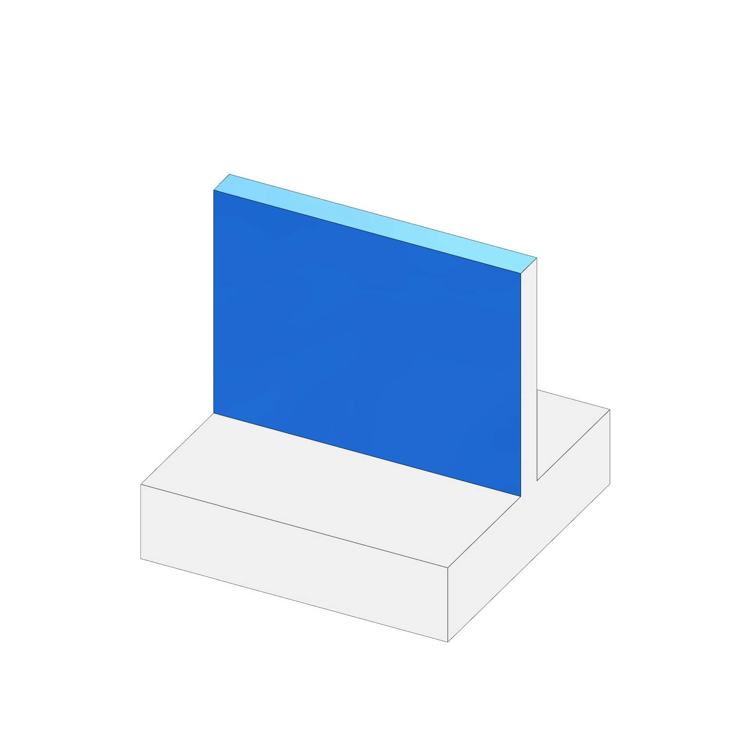

Feature | Recommended Size - Any Material (mm) | xPEEK | xABS, xPP | xFLEX (elastomers) |
Feature Wall Thickness | Recommended Size - Any Material (mm) 1-5 mm | xPEEK 0.3-25 mm | xABS, xPP 0.6-25 mm | xFLEX (elastomers) 0.5-50 mm |
Feature Gap Clearance | Recommended Size - Any Material (mm) 0.5 mm | xPEEK 0.5 mm | xABS, xPP 0.5 mm | xFLEX (elastomers) 0.5 mm |
Feature Minimum Features, Extrude | Recommended Size - Any Material (mm) 0.5 mm | xPEEK 0.3 mm | xABS, xPP 0.6 mm | xFLEX (elastomers) 0.8 mm |
Feature Minimum Features, Hole | Recommended Size - Any Material (mm) 1 mm | xPEEK 0.3 mm | xABS, xPP 0.5 mm | xFLEX (elastomers) 0.6 mm |
Feature Hole Depth | Recommended Size - Any Material (mm) <3x Diameter (blind), <8x Diameter (thru) | xPEEK <10x Diameter (blind), <25x Diameter (thru) | xABS, xPP <8x Diameter (blind), <25x Diameter (thru) | xFLEX (elastomers) <4x Diameter (blind), <12x Diameter (thru) |
Feature Text | Recommended Size - Any Material (mm) 0.4-0.8mm depth, >4mm height | xPEEK 0.2-1.5mm depth, 2.5mm height | xABS, xPP 0.2-1.5mm depth, 2.5mm text height | xFLEX (elastomers) 0.2-1.5mm depth, 2.5mm text height |
Feature Unsupported angle | Recommended Size - Any Material (mm) >30° | xPEEK >5° | xABS, xPP >10° | xFLEX (elastomers) >40° |
Feature Unsupported overhang | Recommended Size - Any Material (mm) <2mm | xPEEK <4mm | xABS, xPP <3mm | xFLEX (elastomers) <2mm |
Feature Unsupported span | Recommended Size - Any Material (mm) <5mm | xPEEK <20mm | xABS, xPP <15mm | xFLEX (elastomers) <8mm |
