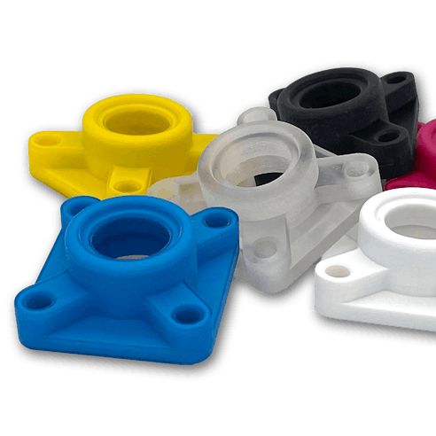

PolyJet printing is a 3D printing technology known for its customizable material properties, excellent surface finish, incredible precision and speed. Our PolyJet machines support the ability to simultaneously print multiple materials and simulate rubber materials of different durometers, multi-color 3D printing, transparent or translucent parts, and simulated overmolds.
  • Rigid and rubber-like options
  • Multi-material 3D printing
  • Color and transparency matched prototypes
  • Multi-color prints
  • 3D prints in as little as a business day
  • High resolution parts with a smooth finish

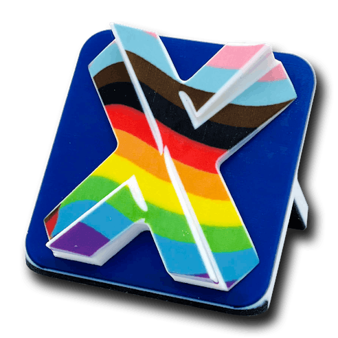

Full Color 3D Printing With PolyJet
Xometry offers a full-color, high quality 3D printing service in addition to black, white, translucent, and grayscale utilizing the latest generation of PolyJet equipment from Stratasys. With over 600,000 available colors, Xometry can print color 3MF and other 3D formats. Have a Pantone, RAL, HEX, CMYK, or other color input? Choose "Custom" and write in the combination in your notes for a Xometry quote!
