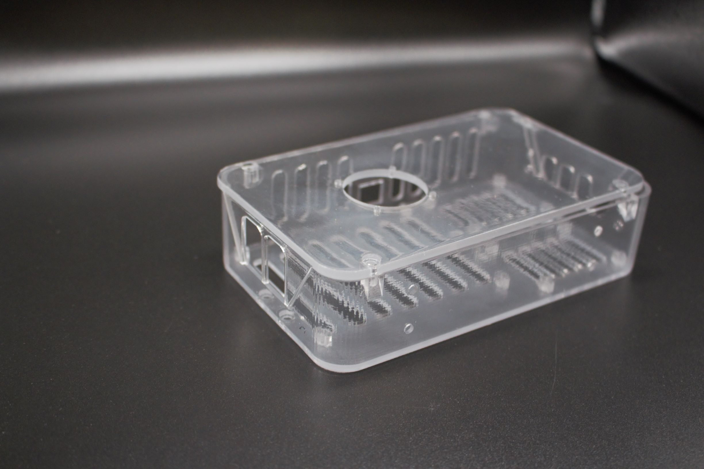

      Accura 60
      Short Description
      Clear, rigid, and strong
      Flexural Strength (MPa)
      87 MPa
      Elongation at Break (%)
      5.0%
      Notched Izod Impact (J/m)
      15 J/m
      HDT @ 0.45 MPa (°C)
      53°C
      Technical Datasheet

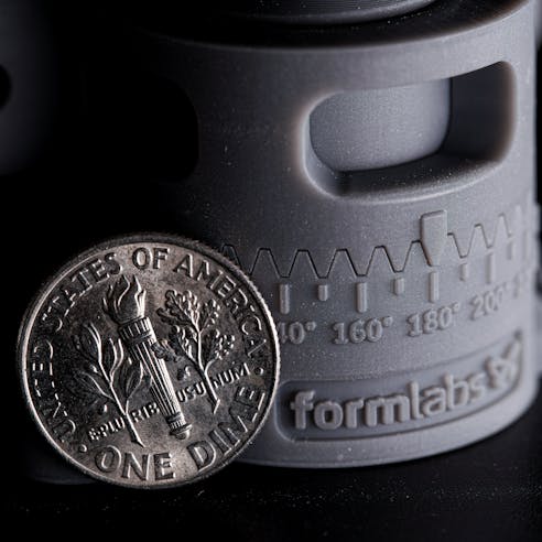

      Formlabs Grey Resin with a dime for detail reference

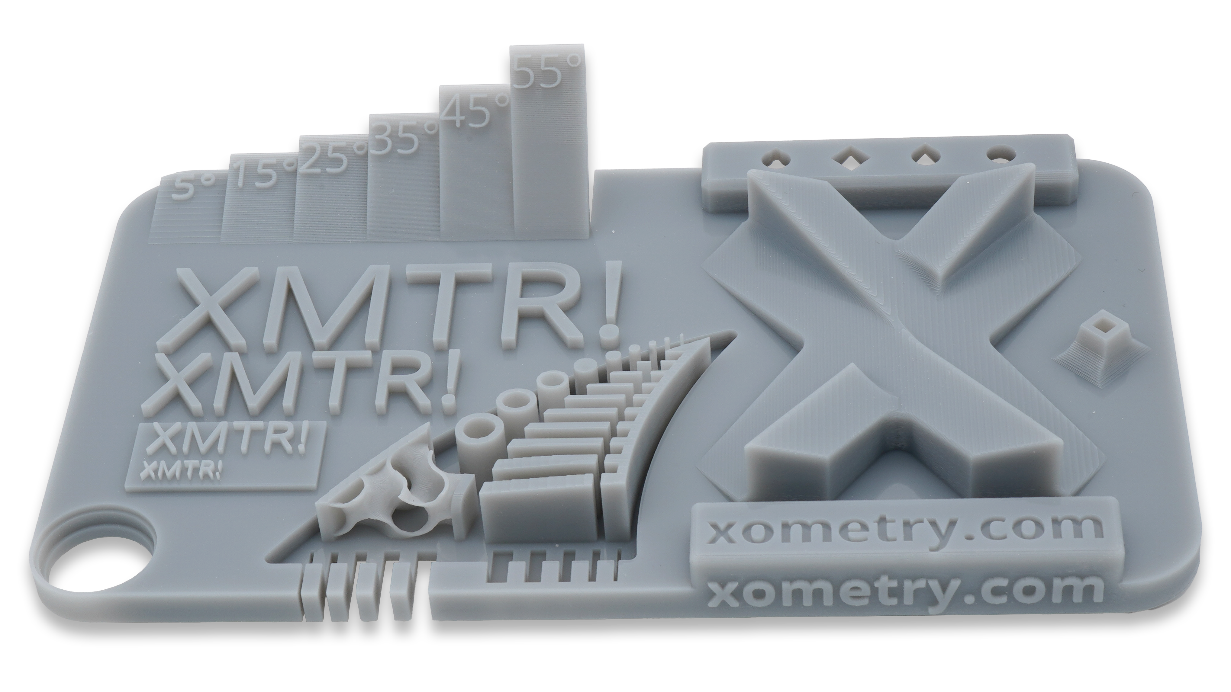

      SLA General Tolerances
      DescriptionStandard ResolutionHigh Resolution
      Description
      Build envelope
      Standard Resolution
      Up to 29” x 25” x 21” (13.5" x 7.5" x 7.5" for Formlabs)
      High Resolution
      10” x 10” x 10”
      Description
      Layer height
      Standard Resolution
      0.004"
      High Resolution
      0.002"
      Description
      Tolerance, XY Plane
      Standard Resolution
      +/- 0.005” for the first inch is typical, plus +/- 0.002” for every inch thereafter.
      High Resolution
      Description
      Tolerance, Z Plane
      Standard Resolution
      +/- 0.010” for the first inch is typical, plus +/- 0.002” for every inch thereafter.
      High Resolution
      Description
      Minimum linear feature size
      Standard Resolution
      Under 0.030” are at risk and under 0.020” will not build.
      High Resolution
      Under 0.020” are at risk and under 0.010” will not build.
      Description
      Minimum radial feature size
      Standard Resolution
      0.035"
      High Resolution
      0.030"
      The table depicts the general tolerances for industrial-grade stereolithography (SLA) services. Stresses during the build, support strategy, and other geometry considerations may cause deviation in tolerances and flatness. After completing a prototype build, improved tolerances may be possible with a manual quote review and must be approved on a case-by-case basis. General tolerances apply before secondary finishing or post-processing unless otherwise specified. Please check out Xometry's Manufacturing Standards for more information on tolerances per process.
