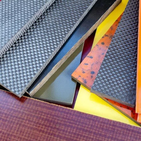

    Paper Reinforced Phenolic
    As its name suggests, paper reinforced phenolic is made using wood-fiber sheets layered in phenolic resin to create a strong, insulative, yet thin composite. While not typically suited for structural or weight-bearing components, paper phenolic is ideal for fireproof and insulative applications where a small profile counts. The National Electrical Manufacturers Association (NEMA) has several grades of general-use paper reinforced phenolics denoted by letter signifiers, where each signifier denotes a unique blend of mechanical, electrical, and chemical performance characteristics:
    • X = Paper Phenolic Resin – Mechanical Grade
    • XP = Paper Phenolic Resin – Mechanical Grade – Hot Punch-able Grade
    • XPC = Paper Phenolic Resin – Mechanical Grade – Cold Punch-able Grade
    • XX = Paper Phenolic – General Purpose Grade
    • XXP = Paper Phenolic Resin – Mechanical Grade – Hot Punch-able
    • XXX = Paper Phenolic Resin – Electrical Grade
    Electrical grade paper reinforced phenolic material is ideal for printed circuit boards (PCBs) and electrical insulative components, where it is often clad with copper for integrated circuit logic and other materials that improve its performance in electronic applications. NEMA also has signifiers for grades of phenolic manufactured with flame-retardant additives to improve safety in electronics, symbolized with the “FR” signifier:
    • FR-1 = Fire Retardant – Paper Phenolic – Mechanical Grade – Hot Punch-able
    • FR-2 = Fire Retardant – Paper Phenolic – Electrical Grade – Cold Punch-able
    There is also a paper-reinforced epoxy laminate similar to the above grades, but is technically not a phenolic material. Its NEMA designation is:
    • FR-3 = Fire Retardant – Paper Epoxy – Electrical Grade
