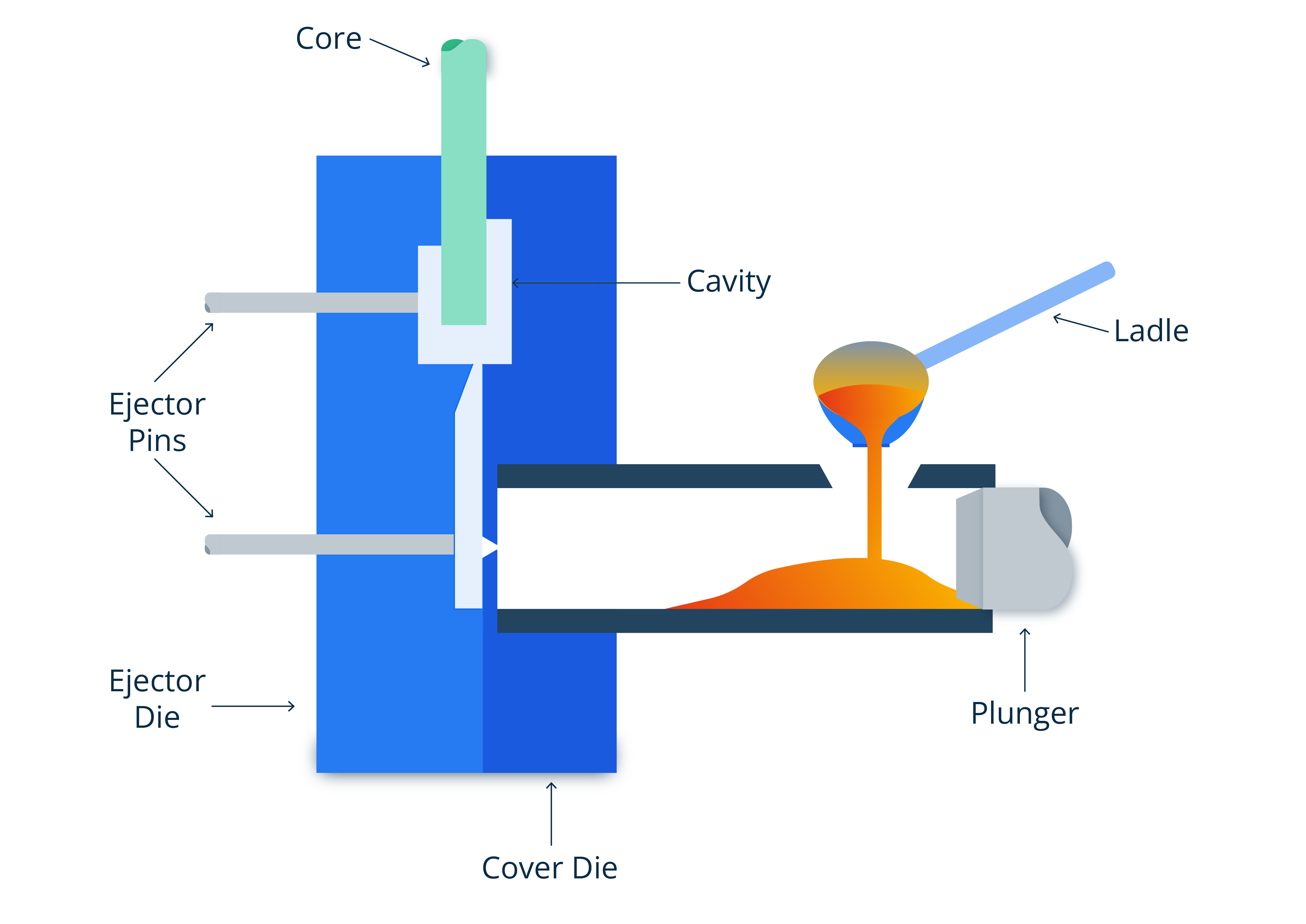

Cold Chamber Die Casting
With the cold chamber die casting process, the chamber remains at room temperature and does not have a holding pot of molten metal. Metal is melted in a separate furnace and deposited into the shot chamber through a pouring hole by hand with a ladle. In cold chamber die casting, the mold is connected directly to the shot chamber and does not utilize a plunger system. Instead, a ram forces molten metal into the mold and held under high pressure while the metal solidifies. This type of die casting is suitable for comparatively higher melting temperature materials such as aluminum.

Isometric illustration of the die casting process.

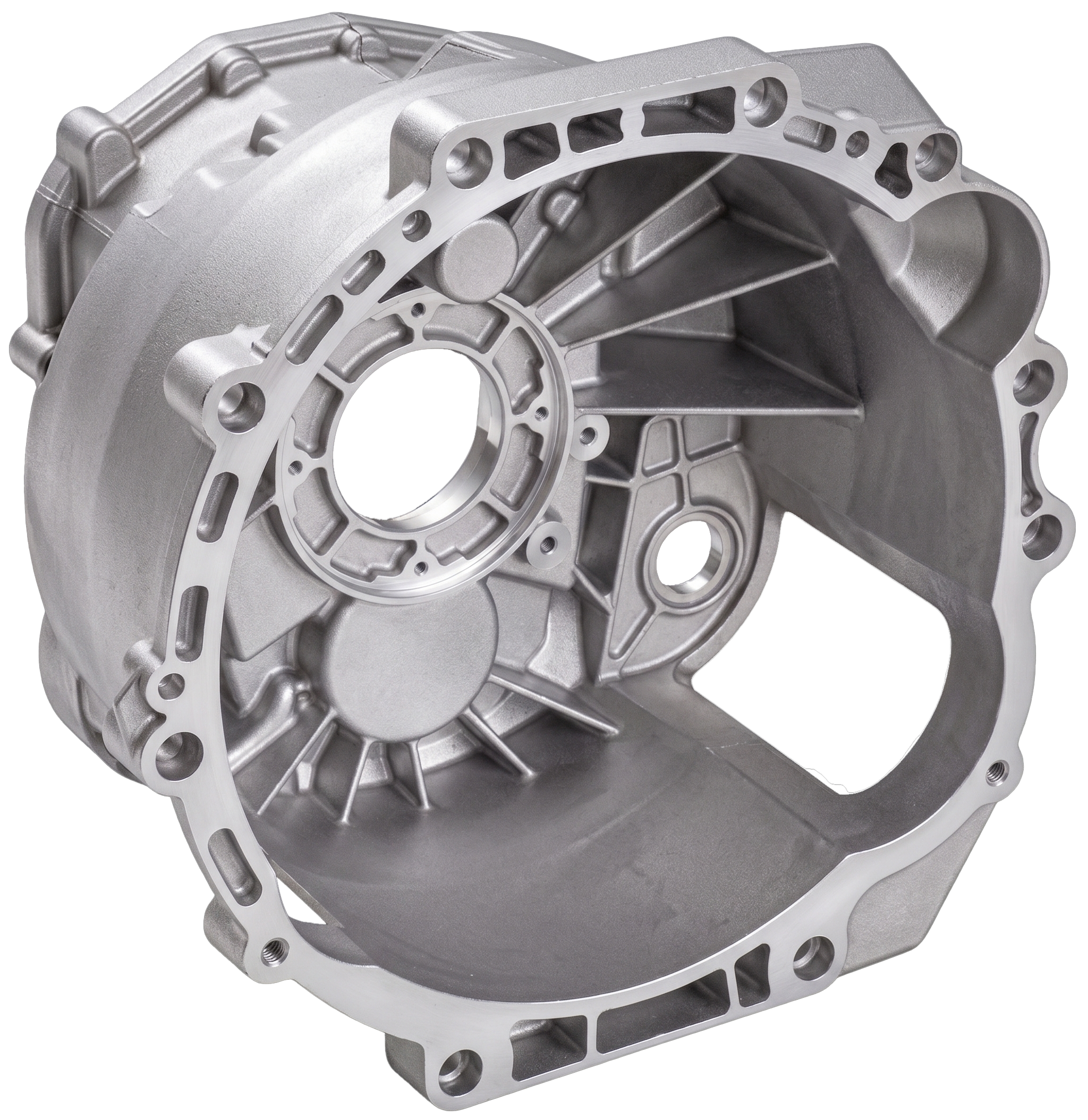

The versatility and high production potential of die casting enable it for various applications and industries. Die casting products that are small to medium in size with complex features are typically well suited for the process. Examples include consumer and industrial products, automotive parts, aerospace components, and parts for medical devices. Die casting products is a great option when you need high-volume metal parts that may be too large for similar high-volume processes such as Metal Injection Molding (MIM).

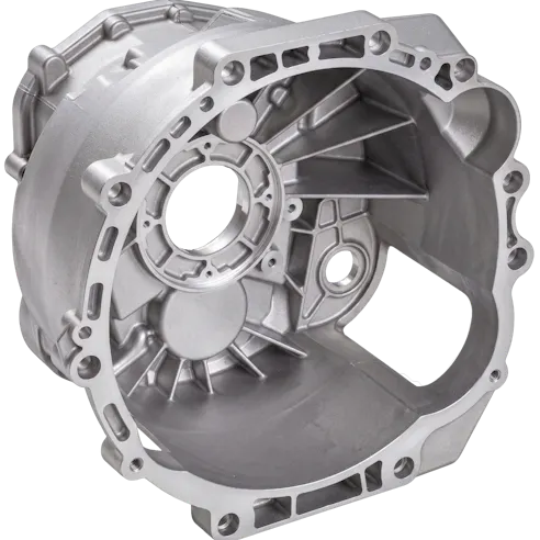

  • Aerospace & Automotive Components
  • Connector Housings
  • Pumps and Plumbing Fixtures
  • Outdoor lighting
  • Gears
  • Appliances and Lighting

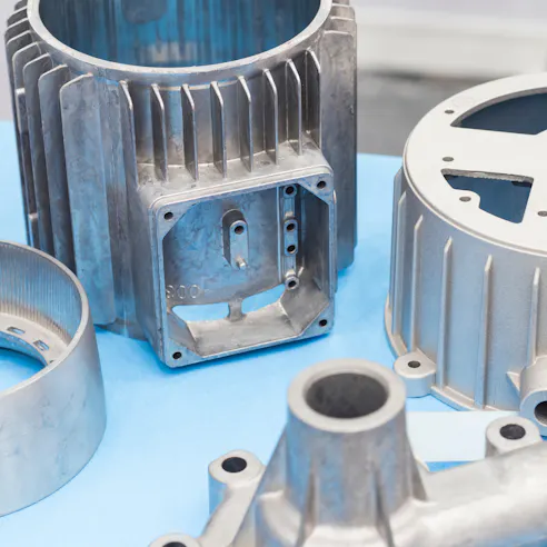

Die cast metal parts
