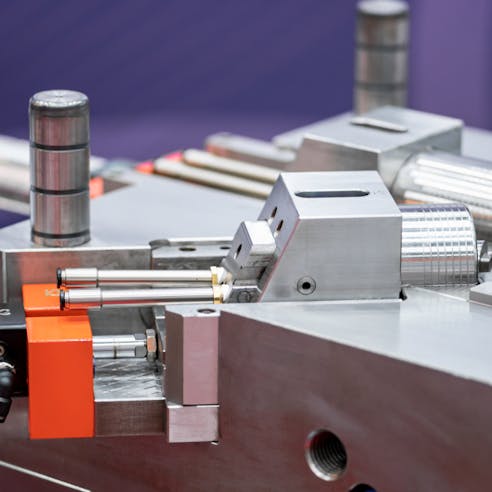

Zinc Die-Casting Process

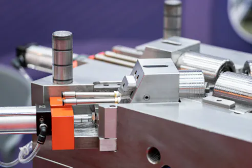

The most common die-casting method applied to zinc is gooseneck die casting, also known as hot chamber die casting. Die casting requires the fabrication of a mold tool or die. The molten metal injected into the die cavity takes the shape of the cavity and cools in place before removal.
The molten charge is stored in a holding pot. It is kept at the right temperature for casting either by internal or external heating. The gooseneck feeds fill from the holding chamber to the injection port of the cavity tool. A plunger on top of the chamber allows it to fill with molten metal from the holding pot. When the chamber is filled, molten material is forced up the gooseneck into the die cavity using the plunger. The mold is pressed closed under high hydraulic pressure during fill and solidification. Once the metal is cool enough, the dies open, and the casted piece is ejected.
In hot chamber die casting, the injection system is immersed in a pool of molten metal, which simplifies the equipment by eliminating the need for a separate heating stage. The stages of hot chamber die casting are: die preparation, melt preparation, injection, recharge, cooling and solidification, die opening and ejection, and trimming and finishing.

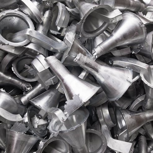

- Recyclability: As alloys of various metals, zinc die-cast parts can be recycled indefinitely. However, some issues prevent this from being the norm. The raw materials are inexpensive, so the cost-benefit of recycling is small. The alloys are hard to identify, so a batch of recycled die-cast parts will have unknown constituents. While they can be tested, this is not a cost-practical step in a low-value recycling process. Die-cast volumes are large overall, but the typical parts are small and too sparsely distributed for the waste-collection process. On this basis, the economic separation and sorting of die-cast components are rarely performed. One exception is the automotive sector, particularly in Europe, where use-to-re-use closed-loop materials management is being developed by more advanced brands.

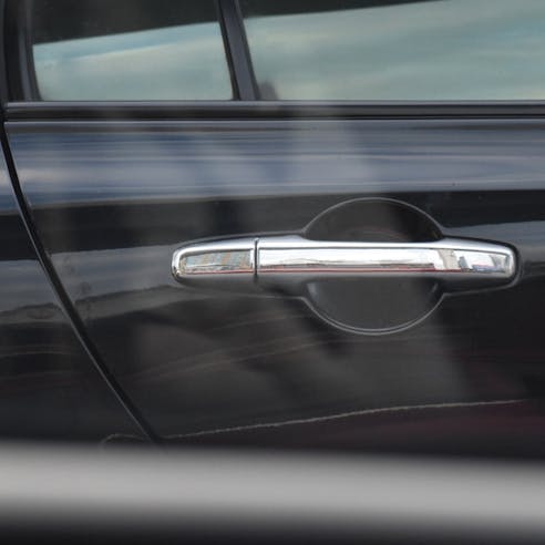

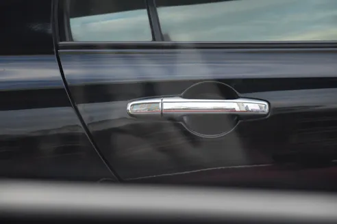

![Auto door handle. Image Credit: Shutterstock.com/Omkoi](https://images.prismic.io/xometry-marketing/744d8da4-862f-4b57-8ab4-e440a95f0794_auto-door-handle.jpg?auto=compress%2Cformat&rect=167%2C0%2C667%2C667&w=492&h=492&fit=max)
Auto Components
Zinc die casting is key to many aspects of the automotive sector, for a wide range of components, due to its unique properties and various advantages. The process provides excellent surface finish, dimensional accuracy, high strength-to-weight ratio, and good thermal conductivity. Some examples of its applications are:
- Door handles and knobs
- Seat adjusters
- Decorative trim pieces
- Oil pump housings
- Sensor components and housings
- Thermostat housings
- Steering wheel frames
- Valve bodies
- Shift forks
- Clutch and airbag components

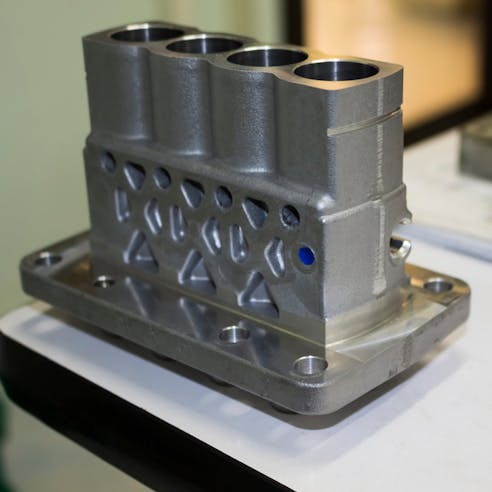

Alternatives to Zinc Die Casting
Xometry offers various alternative materials and processes that can compete in some regards with zinc die casting, depending on the specifics of the application:
- Aluminum Die Casting
- Magnesium Die Casting
- Plastic Injection Molding
- Investment, or Lost Wax Casting
- Sand Casting
- Metal Injection Molding (MIM)
- CNC Machining
![Xometry Image](https://images.prismic.io/xometry-marketing/2f3d58fb-b647-494c-9f32-d69c45a9ad9d_aluminum-die-casting.jpg?auto=compress%2Cformat&rect=64%2C0%2C667%2C667&w=492&h=492&fit=max)
- Aluminum Die Casting: Offers many of the advantages of zinc die casting. Aluminum offers excellent strength-to-weight ratio, high thermal conductivity, and good corrosion resistance. Minor material property differences and much-reduced tool life influence the selection.
- Magnesium Die Casting: This is another practical alternative to zinc. The parts are much lighter, making this a preferred option in weight-sensitive equipment such as aerospace and sports equipment.
- Plastic Injection Molding: This is a versatile alternative to die casting. Plastic injection molding offers equal design flexibility, cost-effectiveness, and the ability to produce complex shapes and features, though the strength of equivalent parts is generally considerably lower.
- Investment, or Lost Wax Casting: This uses a wax pattern, coated with a ceramic shell and then melted out to create a mold cavity. Molten metal is then poured into the cavity to produce the final component. Investment casting is suitable for producing complex and high-precision parts in various metals, including stainless steel and bronze. However, it is not suited to mass production, unless the product value is very high.
- Sand Casting: This is a traditional casting process that involves creating a mold cavity by compacting sand around a pattern, which is charged with molten metal to form the part. Sand casting services are suitable for producing larger and more complex parts in almost all metals, but production is labor-intensive and slow unless very expensive automation is used.
- Metal Injection Molding (MIM): this combines elements of plastic injection molding and powdered metallurgy. It involves mixing metal powders with a polymer binder, injecting the mixture into a mold, and then burning out the binder and sintering the part to achieve the final metal component. MIM is suitable for producing small, intricate, and high-precision parts in various metals, including stainless steel and titanium.
- CNC Machining: this involves the use of computer-controlled machines to shape and cut almost any material. It is a versatile alternative that offers high precision, design flexibility, and the ability to produce complex parts. CNC machining is suitable for both prototype development and moderate-volume production.
