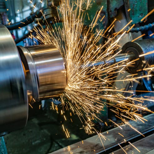

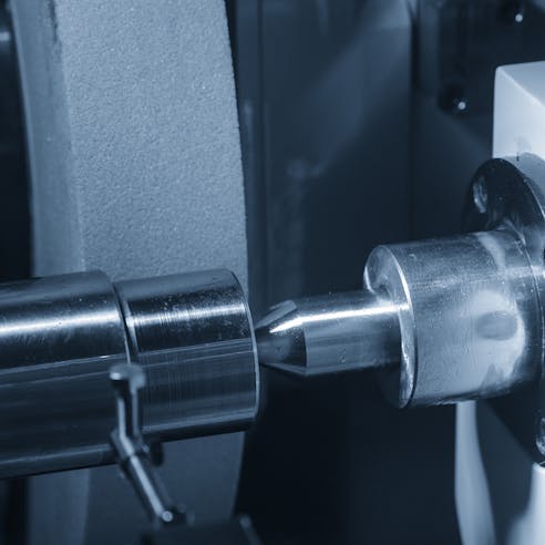

External cylindrical grinding perfects the outer dimensions and surface finish of a round part. This grinding is accomplished with a relatively large rotating grinding wheel. The workpiece is rotated while the grinding wheel rotates in the opposite direction. In this way, it looks similar to a lathe, except that the machine has a grinding wheel in place of a cutting tool.
The grinding wheel can move relative to the workpiece in a number of different ways. For plunge grinding, the centers of the workpiece and grinding wheel move gradually inwards towards each other, the grinding wheel “plunging” into the workpiece. In traverse grinding, the movement of the grinding wheel is axial, moving along the length of the workpiece.
Various grinding wheels are available for different materials and different surface finishes. The diameters and thicknesses depend on the workpiece’s geometry. The abrasive material in the grinding wheel must also be carefully selected, with common choices being diamond or cubic boron nitride. Grinding wheels vary in terms of how open, or rough, their surface is. Dressing a grinding wheel reveals a fresh abrasive surface on the wheel, and the details of how this is done will affect the final surface finish of the workpiece.
