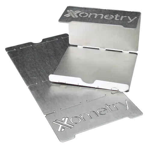

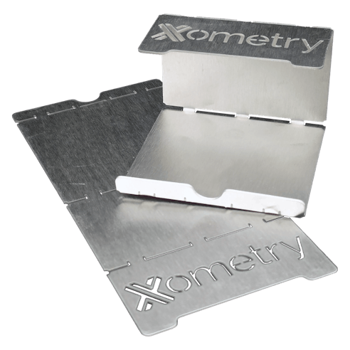

    Sheet metal phone stand made by Xometry.

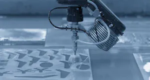

    Waterjet Cutting
    Online Waterjet Cutting Service
    Cost-effective waterjet cut parts in days | Free standard shipping on U.S. and international orders | International prototype pricing includes tariffs

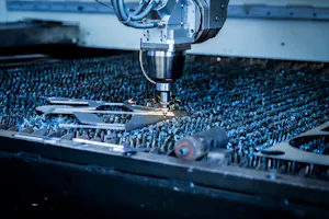

        Laser cutting metal sheet
        Rapid Tooling
        Sheet metal can be quickly cut into 2D profile shapes and formed out of a variety of high-strength materials, making it perfect for rapid tooling.
