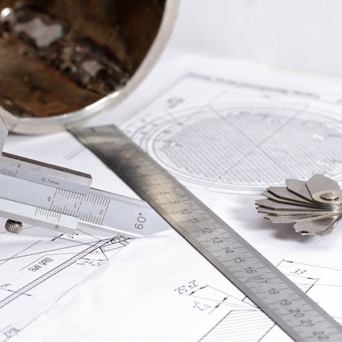

Templates for measuring the bevel edge. Image Credit: Shutterstock.com/shinobi

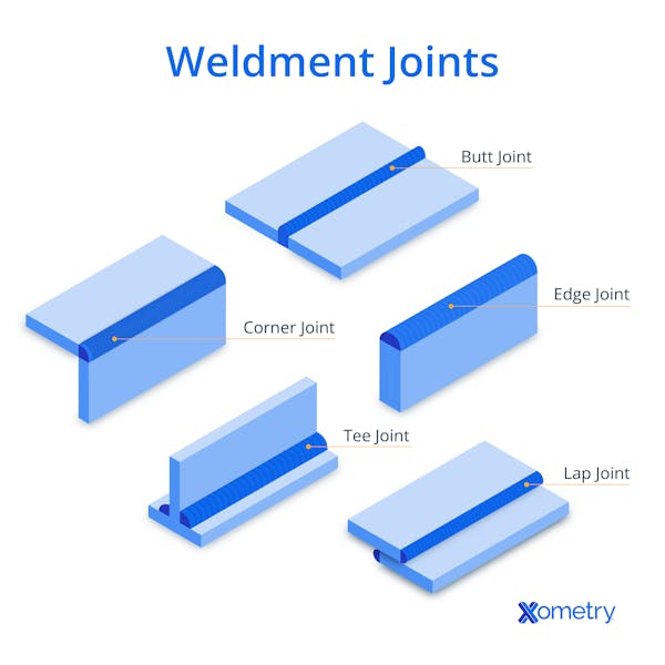

Choose Appropriate Weld Joints:

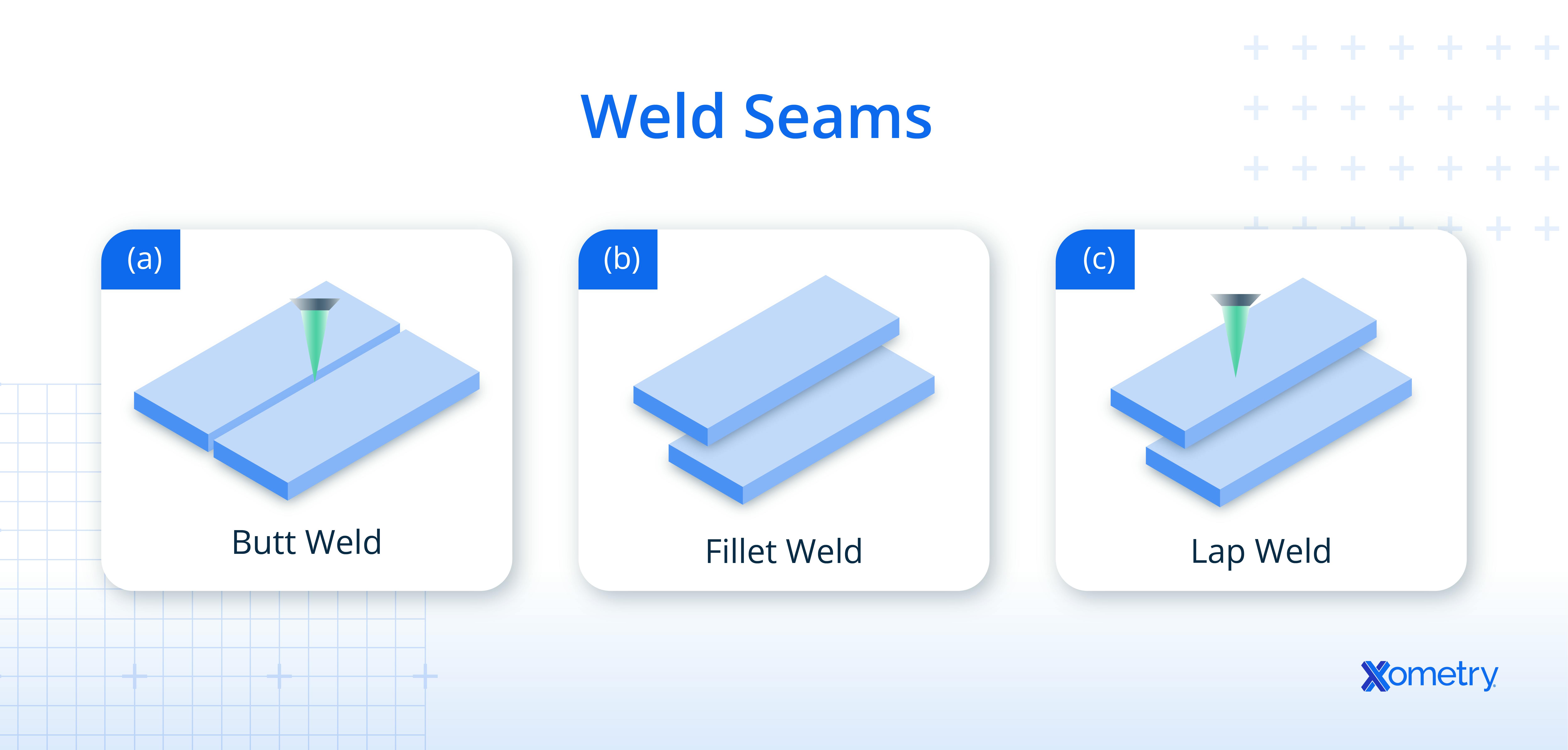

  • Butt Joint: Joins parts in the same plane, offers a clean and flush finish.
  • Edge Joint: Best for joining thin materials where edge reinforcement is needed without adding bulk.
  • Lap Joint: Can join pieces with different thicknesses, provides excellent shear strength, and is more forgiving for minor misalignments.
  • Tee Joint: For strong perpendicular connections, allows easy access to fillet welding from both sides.
  • Corner Joint: Perfect for forming 90° angles in frames or boxes, enabling neat, strong external edges.
An illustration of different weld joints, including butt joint, corner joint, edge joint, tee joint, and lap joint.
An illustration of different weld seams.

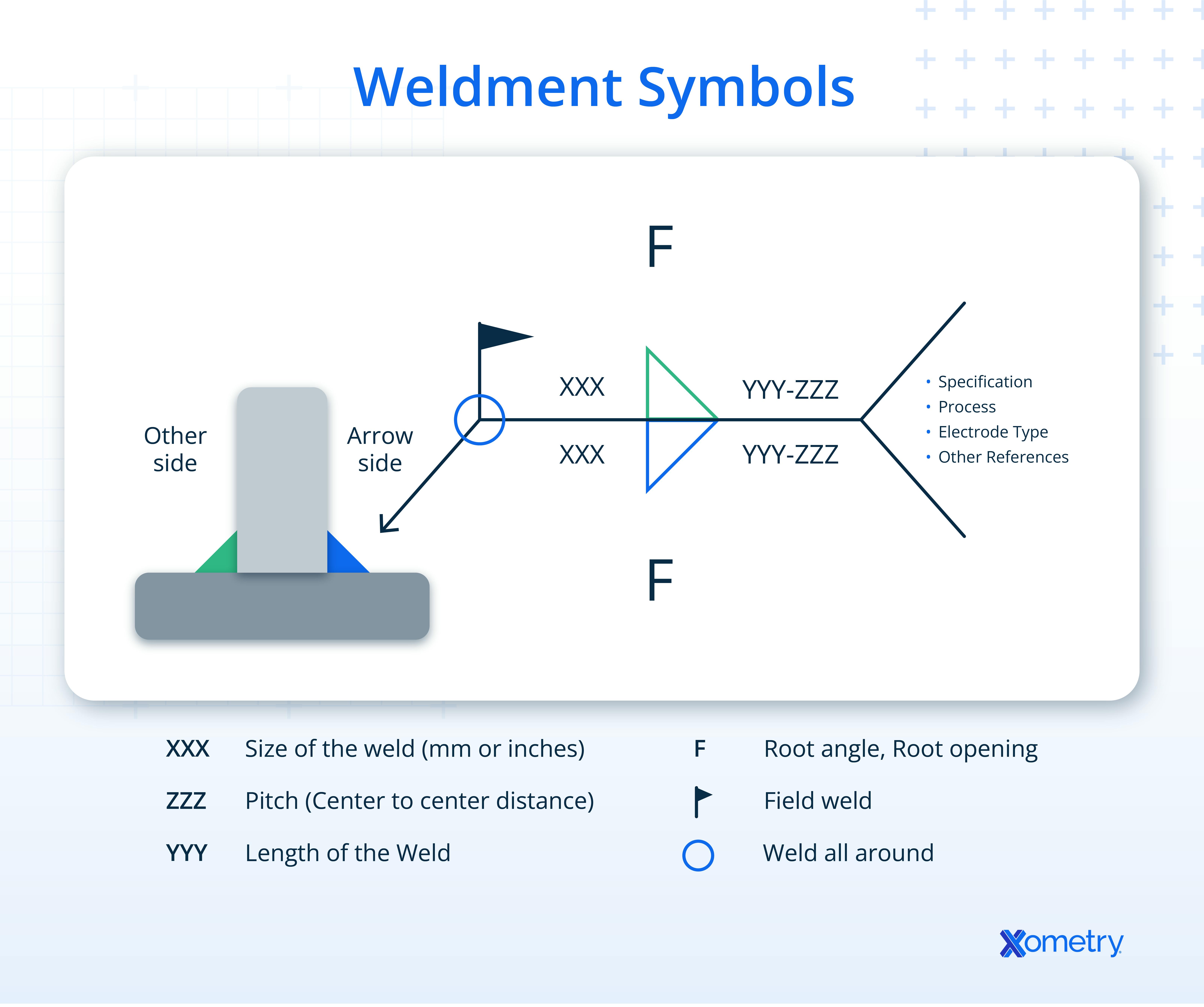

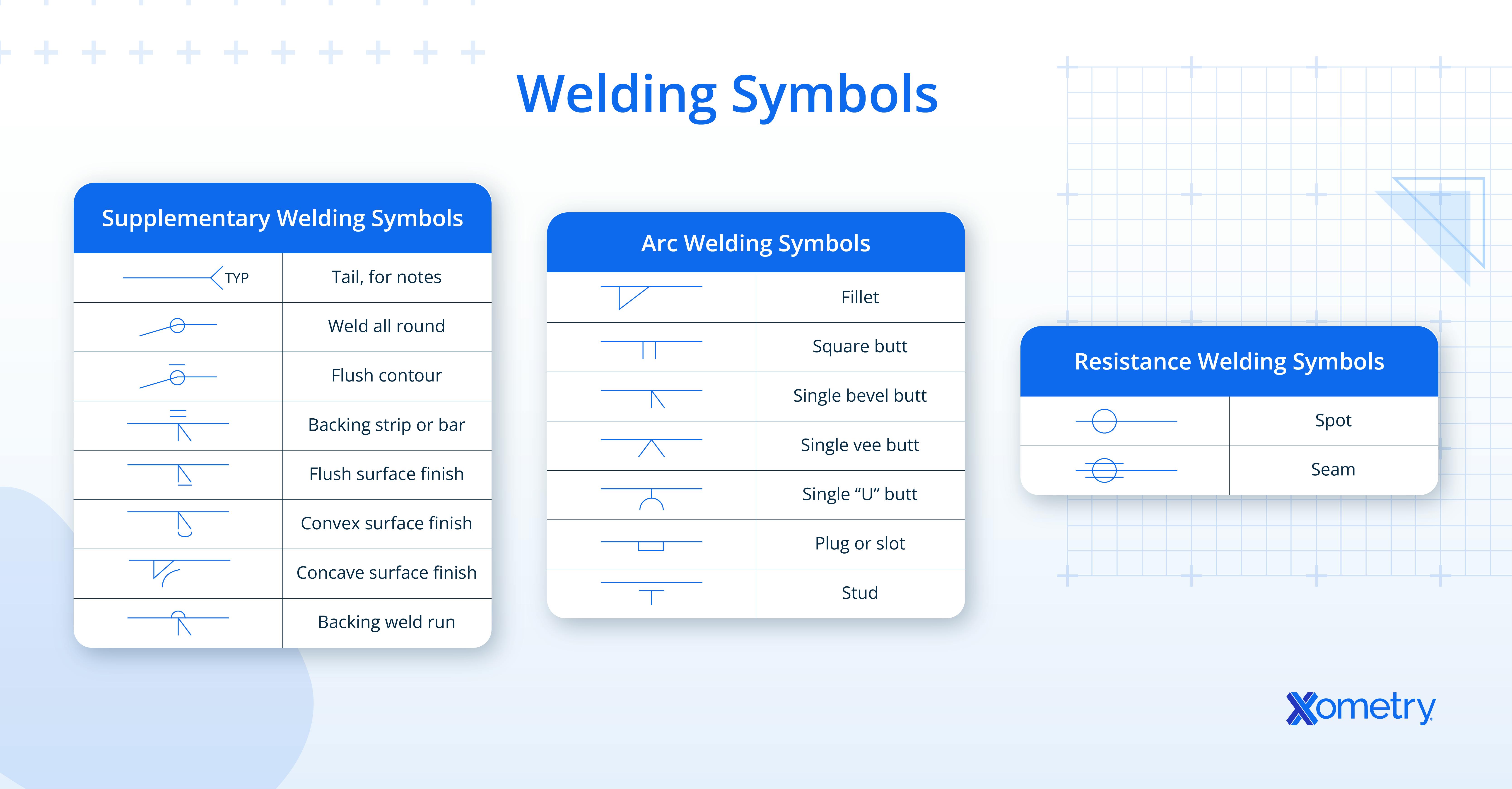

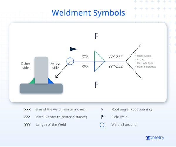

Use Standard Weld Symbols: Proper use of weld callouts and symbols in your CAD files ensures clear communication between design and fabrication teams, minimizing misinterpretations.
Welding Symbols
Three charts showing supplementary, arc, and resistance welding symbols.
An illustration of a weldment example with callouts.
An illustration of weldment symbols.

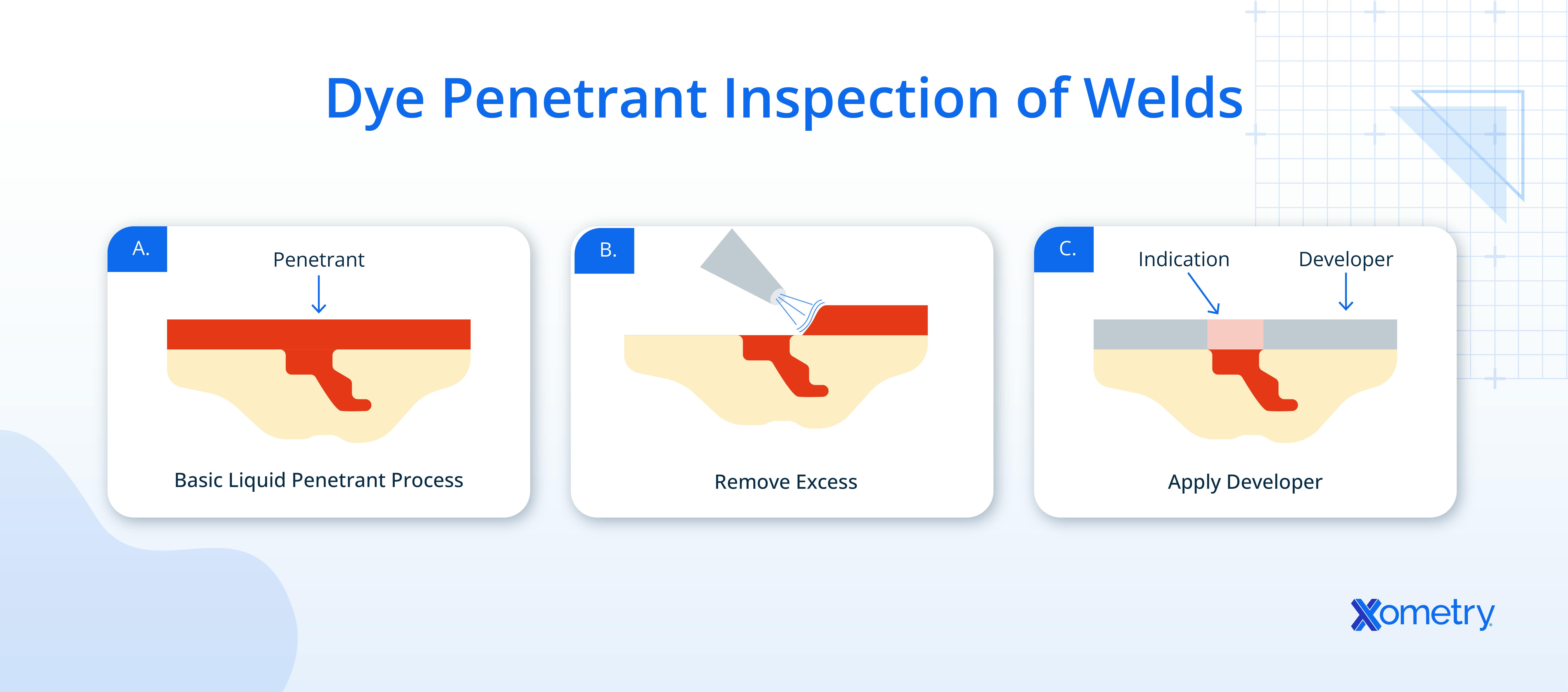

  • Advanced Testing Options: Includes dye penetrant (shown below), ultrasonic testing, and radiography, ideal for high-integrity applications.
Inspection and QA of a weldment job
Our team ensures 100% quality control, supported by detailed inspection records and certifications to meet your project’s needs.
An illustration showing the dye penetrant inspection of welds.
