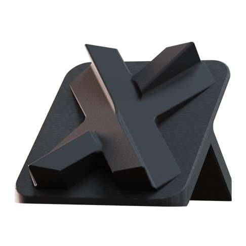

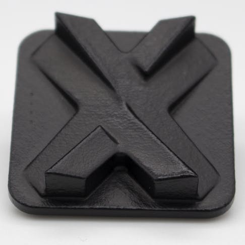

![Machined Aluminum Xometry X Stand](https://images.prismic.io/xometry-marketing/9d5a3eec-e395-4f83-8b61-f1935f975934_Xometry+X+Stand.png?auto=compress%2Cformat&rect=0%2C0%2C1000%2C1000&w=486&h=486&fit=max)
Part is cleaned and deburred. No surface finishes are applied.

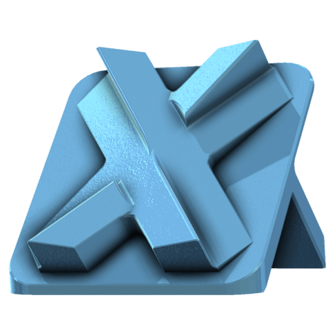

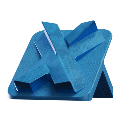

![Image of an aluminum stand with a type ii blue anodized finish.](https://images.prismic.io/xometry-marketing/ab26b8d5-86fa-4d8f-8f5e-d2b40e54a115_Type+II+Blue_v2.png?auto=compress%2Cformat&rect=0%2C0%2C1000%2C1000&w=486&h=486&fit=max)
Type II anodize provides increased corrosion resistance and can be used as a base for paint and other finishes. Thickness ranges from .0002”-.0012”. Will conform to MIL-A-8625/MIL-PRF-8625 Type II, Class 2.
Color anodizing involves using dyes to affect the part’s surface color. Anodized colors cannot be matched to specific Pantone or RAL colors. Type II coatings are susceptible to wear and may bleach or fade under prolonged direct sunlight.

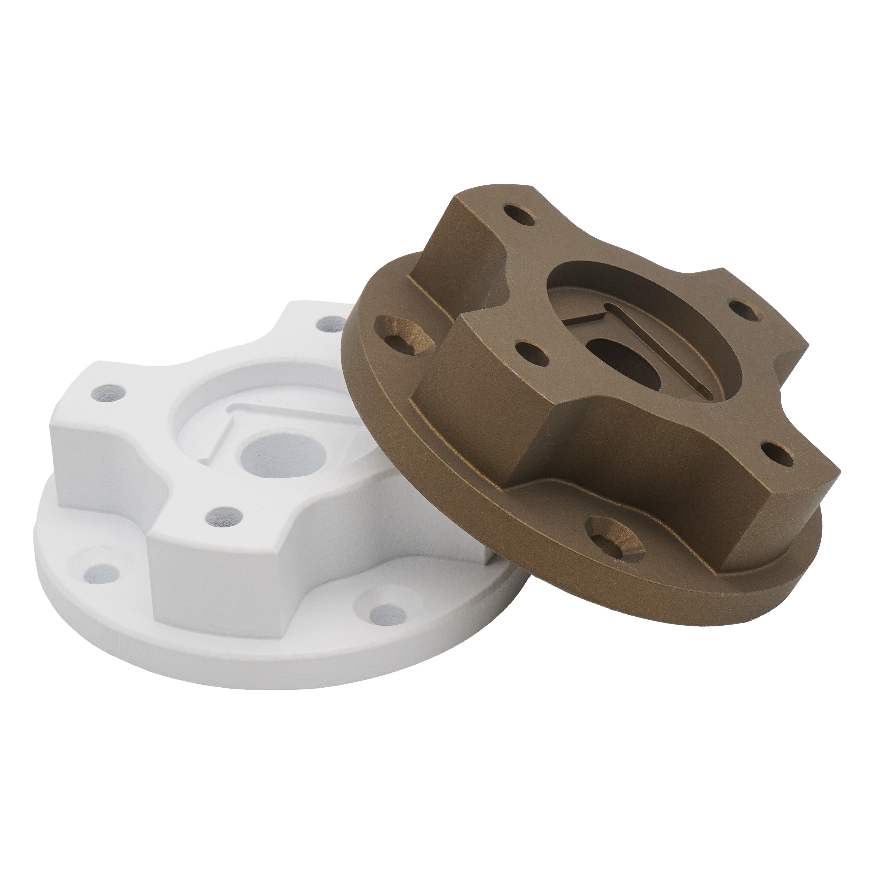

![Image of an aluminum stand with a gold chromate conversion finish.](https://images.prismic.io/xometry-marketing/11d10d55-9074-47ca-a85c-23ab31ae9499_Gold+Chromate.png?auto=compress%2Cformat&rect=0%2C0%2C1000%2C1000&w=486&h=486&fit=max)
Chromate conversion coatings, also known as chem-film, enhance corrosion resistance and conductivity properties and can be used as a base for paint. Chem-film coatings add very little thickness, about 0.00001”-0.00004”. Chem-film will conform to MIL-DTL-5541, TYPE I/II CLASS 1A or CLASS 3 as specified. If other specifications, such as MIL-DTL-81706, are required, they should be specified in a supplied drawing.
Type I chromate conversion coatings contain hexavalent chromium, which causes the coating to appear gold or brown in color typically. Type II lacks hexavalent chromium, thus the coating will appear clear and not affect surface coloration.

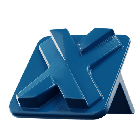

![Metal part powder coated with a RAL 5017 traffic blue paint in a glossy sheen.](https://images.prismic.io/xometry-marketing/a3fc7223-52f4-474d-bf69-97b744e3b7f3_RAL+5017+-+Traffic+Blue.png?auto=compress%2Cformat&rect=0%2C0%2C1000%2C1000&w=486&h=486&fit=max)
Provides a continuous, protective color finish on parts using evenly applied, heat-cured paint. Thickness is usually .006”-.012” and conforms to ASTM D7803 and various MIL and FDE specifications. Various colors and sheens can be chosen.
See all of our powder coating finishes in our powder coat finishes gallery.

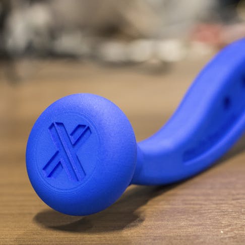

![SLS selective laser sinter nylon dyed blue part](https://images.prismic.io/xometry-marketing/0a394100-cca4-4ea9-95e4-3c50beb637de_SLS+nylon+dyed+blue+gear+shift+lever.jpg?auto=compress%2Cformat&rect=158%2C0%2C2971%2C2971&w=486&h=486&fit=max)
Parts are submerged in a dye solution that penetrates roughly ~0.010” into the surface, altering the surface’s color. Coloration may vary slightly from batch to batch.

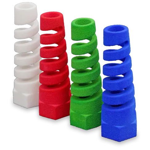

Color Dyeing
Parts are submerged in a dye solution that penetrates roughly ~0.010” into the surface, altering the surface’s color. There is potential for slight batch-to-batch color variation with all color options, including black.

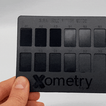

![Animated gif of an injection molded finish sample card reflecting light at different angles](https://images.prismic.io/xometry-marketing/f1dd3b85-a78d-458e-80e7-91ff9c1e6377_SPI-Finishes-light.gif?auto=compress%2Cformat&rect=131%2C0%2C338%2C338&w=492&h=492&fit=max)
Injection Molding Finishes In Detail
SPI A Finishes
SPI A-1
Diamond buffed with grade #3, 6000 grit for a highly polished finish. Also suitable for producing optically clear parts. Has an average surface roughness of 0.012-0.025µm Ra.
SPI A-2
Diamond buffed with grade #6, 3000 grit for a high polish finish. Also suitable for producing transparent parts. Has an average surface roughness of 0.025-0.050µm Ra.
SPI A-3
Diamond buffed with grade #15, 1200 grit for a high-to-medium polished finish. Also suitable for producing non-optical transparent parts. Has an average surface roughness of 0.050-0.100µm Ra.
SPI B Finishes
SPI B-1
A 600-grit sanded finish for a medium polish with a surface roughness of 0.05-0.10µm Ra.
SPI B-2
A 400-grit sanded finish for a medium polish with a surface roughness of 0.10-0.15µm Ra.
SPI B-3
A 320-grit sanded finish for a medium-to-low polish with a surface roughness of 0.28-0.32µm Ra.
SPI C Finishes
SPI C-1
A 600 stone finish for a low polish with a surface roughness of 0.35-.40µm Ra.
SPI C-2
A 400 stone finish for a low polish with a surface roughness of 0.45-.55µm Ra.
SPI C-3
A 320 stone finish for a low polish with a surface roughness of 0.63-.70µm Ra.
SPI D Finishes
SPI D-1
Dry blasted with glass bead for a satin finish with a surface roughness of 0.80-1.00µm Ra.
SPI D-2
Dry blasted with #240 oxide for a dull finish with a surface roughness of 1.00-2.80µm Ra.
SPI D-3
Dry blasted with #24 oxide for a dull finish with a surface roughness of 3.20-18.00µm Ra.

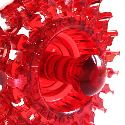

Urethane and Silicone Casting Finishes
Urethane-Casted parts can be either rigid, flexible, or even rubber-like depending on the composition of the Urethane used. We offer Urethane in a wide variety of color options such as transparent (standard), black, and color matching. Parts may also be applied with a standard, smooth finish, or a custom finish, which includes adding hardware installations and painting.
![Image of a red urethane cast part with a glossy finish.](https://images.prismic.io/xometry-marketing/10e77592-d452-45f8-9e69-99c6dc87e1d7_20210428_Edit2_+ISOLAB+TECHNOLOGIES+LLC+-+Urethane+Cast+Carousel.jpg?auto=compress%2Cformat&rect=816%2C0%2C2448%2C2448&w=492&h=492&fit=max)

Textured
A selection of SPI and Mold-Tech mold finishes which mimic those of injection molded parts.
