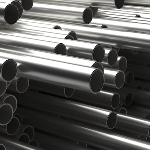

Round Tube Stock
Xometry uses a variety of round tube stock for its on-demand manufacturing services. The information below separates the metals and sizes by their availability for tube bending and laser tube cutting.
Stainless Steel Round Stock
Stainless 304 and 316 tubes can be bent and cut in a variety of geometries. 304 is typically a general purpose stainless steel and 316 has increased corrosion resistance.
