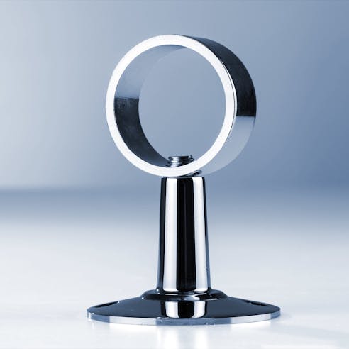

Nickel plating: Carbon steels can be uniformly nickel-plated to improve their corrosion and wear resistance. This process deposits a 0.1mm layer of nickel on the surface of the part.
Powder coat: Powder coating creates a robust surface finish that is typically between 0.006” (0.1524 mm) and 0.012” (0.3048 mm) thick. Since bare steel rusts easily, it can benefit from powder coating.
Carburizing: Some steels can have their properties significantly improved through carburizing. This process infuses the surface with additional carbon that improves its hardness and wear-resistance.
    CNC machining nickel plated finish
