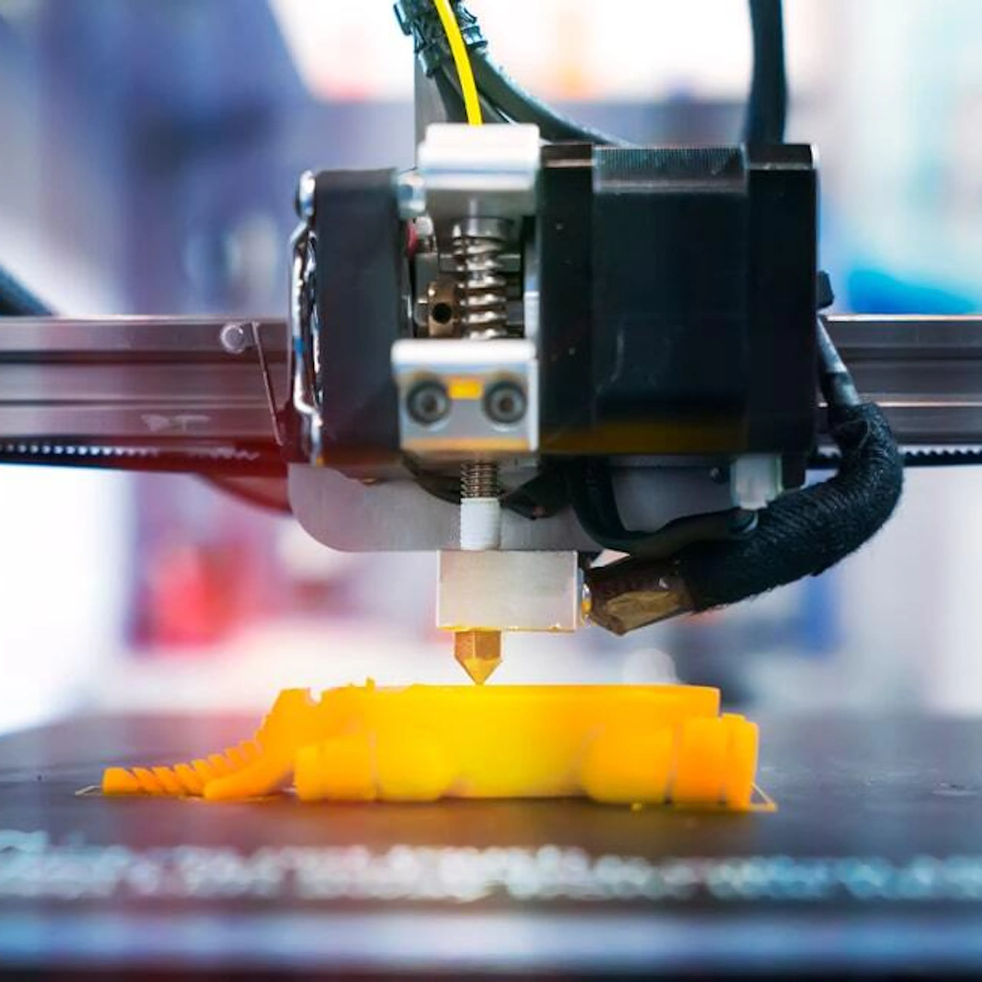

Yellow 3D printed object. Image Credit: Shutterstock.com/asharkyu
CNC machining and 3D printing are extremely prominent manufacturing methods today, not only here at Xometry but globally. While they differ in almost every way, they’re direct competitors for the creation of solid parts, and among their biggest differences is that one method works by removing material, while the other adds it layer by layer. Let’s find out more.

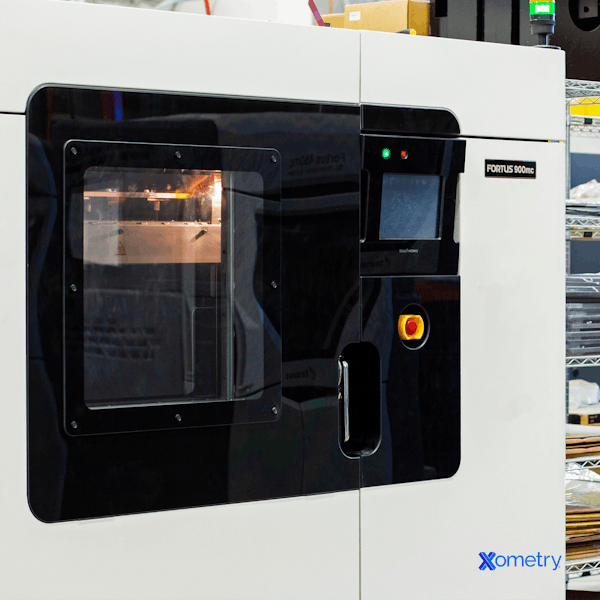

fdm 3d printer
An FDM 3D printer.
There are several reasons why 3D printing is so popular, starting with the fact that it’s relatively quick to set up and doesn’t cost crazy amounts of money to make complex shapes. It also doesn’t require any intervention during the process—you can just let it do its thing until it’s finished. Also, many 3D printers are office- and beginner-friendly.
Some potential drawbacks, though, are that 3D-printed parts can vary significantly in strength, especially when compared to the strength of the original material. For example, if you were to use FFF (fused filament fabrication) to print an ABS (acrylonitrile butadiene styrene) part, it might only be about 10% as strong as solid ABS. But something like SLS (selective laser sintering) using nylon can result in close to 100% as strong as solid nylon. Also, 3D printing is good for dimensional accuracy but can be tricky when it comes to extremely precise parts and features, and it struggles with smooth surfaces, especially when it comes to the Z-resolution (the layer height), which can create visible steps on sloped or curved surfaces.

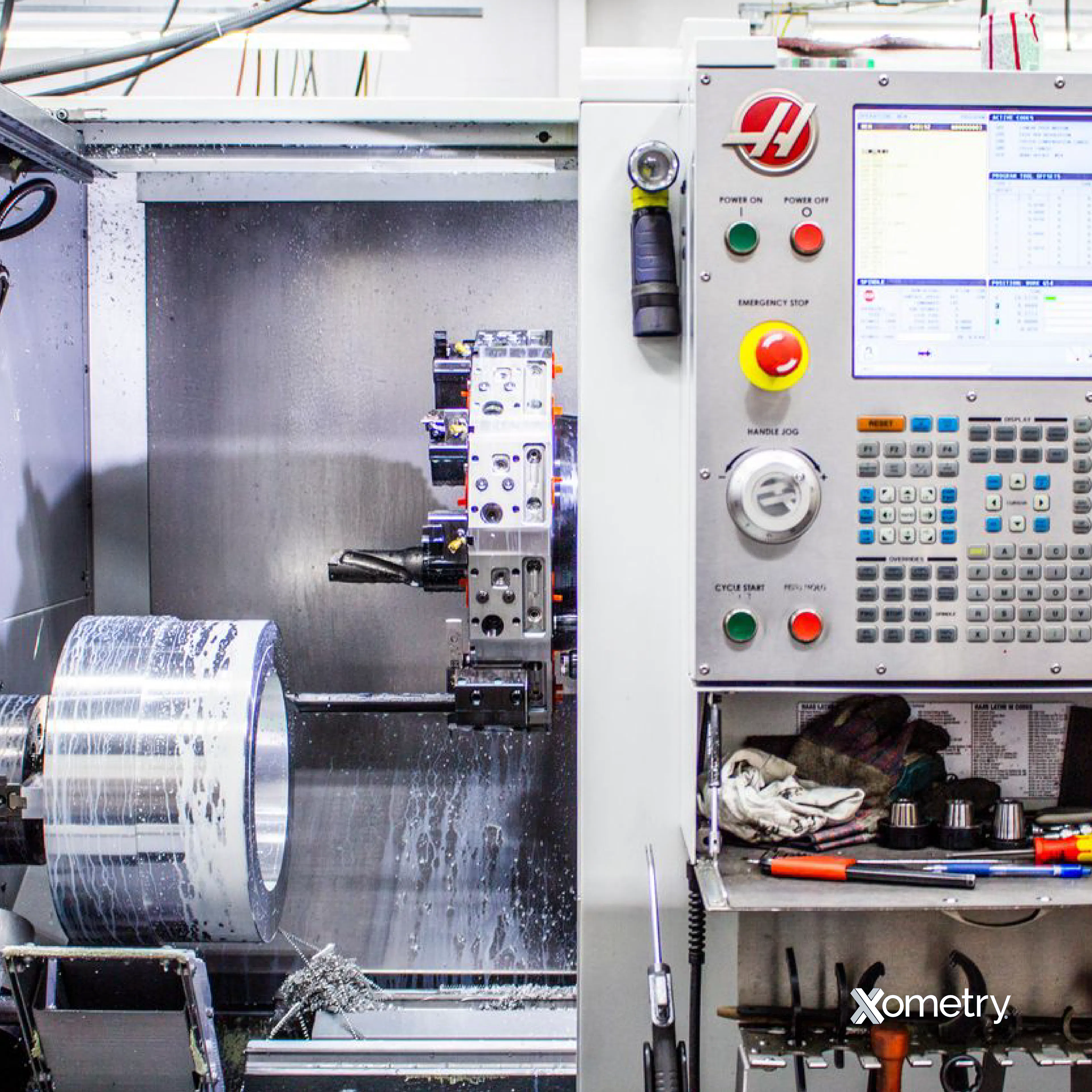

a CNC machine
A CNC machine
Aside from producing parts that are more precise, CNC machining uses engineering materials that maintain their full properties with no disruptions by the process. As with anything, though, there are a couple of potential downsides to this method. It usually needs fixtures or mounts to hold the workpiece in place securely, and designing and setting up these mounting tools—also called jigs—can be tricky and require both time and money. This is much more complicated than 3D printing, which simply prints on a moving bed. Also, CNC machining cuts away material that’s no longer needed, ultimately creating waste. This doesn’t happen in 3D printing.
