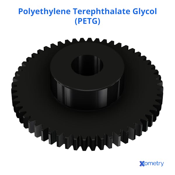

PETG Definition and Comparison to ABS
PETG (Polyethylene Terephthalate Glycol) is a thermoplastic polyester known for its strength, flexibility, and resistance to impact. The material is a popular choice in 3D printing due to its ease of use, minimal warping, and durability. PETG offers excellent chemical resistance and high moisture resistance, making it suitable for applications involving exposure to water or various chemicals. PETG has a lower tendency to warp during printing, making it easier to work with compared to ABS. PETG offers superior flexibility, transparency, and better resistance to environmental factors like moisture, while ABS is stronger in terms of impact resistance and high-temperature performance. PETG is used in medical devices, food packaging, and structural parts for its clarity and chemical stability. ABS is preferred for automotive parts, electronics, and toys requiring higher strength and heat resistance.
What are the Advantages of PETG Compared to ABS?
The advantages of PETG compared to ABS are listed below.
  • Ease of Printing: PETG is easier to print than ABS, with less warping and fewer adhesion issues. The lower printing temperatures and heated bed make it more suitable for 3D printing.
  • Chemical Resistance: PETG offers better chemical resistance than ABS in specific environments, especially to oils, moisture, and some chemicals, increasing its durability in specific industrial applications.
  • Flexibility: PETG is more flexible and ductile but typically has lower impact resistance than ABS.
  • Transparency: PETG provides excellent clarity, making it ideal for applications requiring transparency (food packaging or medical device components), where visibility and cleanliness are essential.
  • Environmental Resistance: PETG is more resistant to moisture and UV degradation compared to ABS, making it a better choice for outdoor applications or parts exposed to humid environments.
What are the Disadvantages of PETG Compared to ABS?
The disadvantages of PETG compared to ABS are listed below.
  • Lower Heat Resistance: PETG has lower heat resistance compared to ABS, withstanding temperatures up to 70-80°C, which makes it less suitable for applications exposed to higher temperatures. PETG  is ideal for moderate heat environments (some electronics and consumer products).
  • Surface Scratching: PETG is more prone to surface scratches than ABS when used in high-contact applications. The material lacks the same level of hardness as ABS, which limits its durability for items subjected to rough handling or wear.
  • Lower Strength: PETG's flexibility is not matched by its mechanical strength or rigidity, as with ABS. Applications requiring high structural integrity or impact resistance may suffer from a disadvantage under heavy loads.
  • Overheating During Printing: PETG has a higher tendency to overheat and produce stringing during the 3D printing process. The issue can lead to messy prints, requiring careful temperature control and fine-tuning during the printing process to avoid excessive oozing.
  • Difficulty in Post-Processing: PETG is more challenging to post-process than ABS when it comes to sanding and painting. The material’s smooth surface can be more rigid to work with, which may limit its ability to be easily modified for specific applications.
