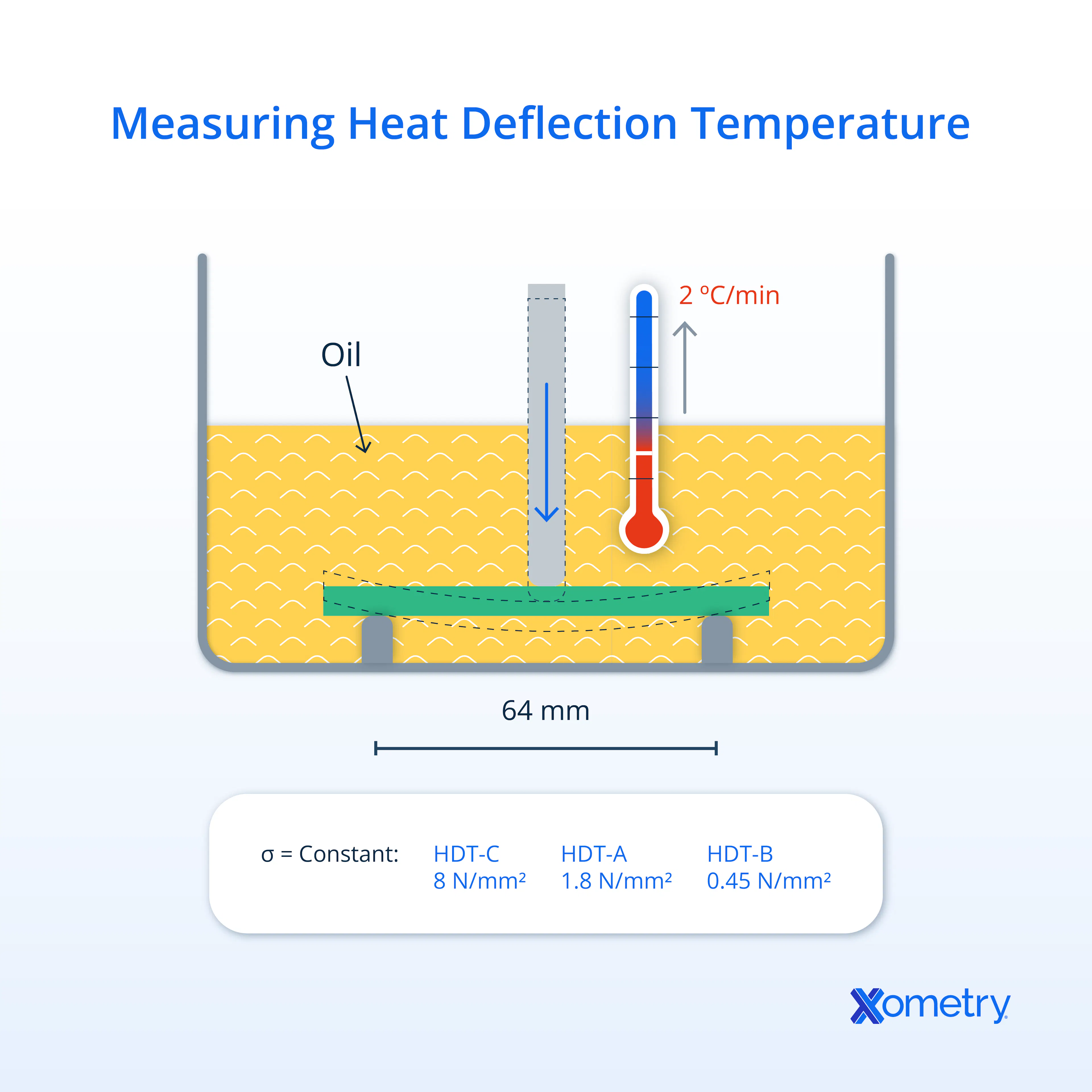

How To Measure Heat Deflection Temperature (HDT)?
To work out a material’s HDT, we need heating, loading, and measuring systems—all of which are provided by the HDT test equipment/apparatus (pictured below). The standard measuring system for HDT is the American Society for Testing and Materials (ASTM) D 648—which is comparable to the ISO 75 international standard.
The HDT measuring process consists of the following 4 steps:
  1. The sample is prepped and loaded on the machine in a three-point bending configuration, meaning it’s supported at its two ends so that pressure can be applied in the middle.
  2. A constant bending stress (either 0.46 or 1.8 MPa, depending on what you’re testing) is applied to said middle.
  3. A mineral or silicone oil that won’t affect the plastic is used as the heat transfer, and its temperature is gradually increased at a controlled rate of 2°C/min (±0.2°C/min).
  4. The sample is monitored throughout all stages and temps, and when it deforms by 0.25 mm, we have the HDT.
Heat deflection temperature
What Are the Common Loads Used in Heat Deflection Temperature (HDT)?
To get a little more technical, the standard states that a material’s HDT is the temperature at which a bar measuring 127 x 13 x 12 mm (we’ll call this the “sample”) deflects by 0.25 mm when put under a centered standard flexural stress of either:
  • 0.46 MPa (67 psi): This is used on soft plastics, like polyethylene (PE), or low-density PE, and other polymers for general use.
  • 1.8 MPa (264 psi): For stronger and more durable thermoplastics/thermosetting materials for heavy-duty use, such as polyether ether ketone (PEEK), polycarbonate (PC), and epoxy resins.
The testing method for both of these is exactly the same, apart from the load amount. The higher 1.8 MPa load will make the material deform at a lower temperature than the 0.46 MPa one. Sometimes, higher 5.0 MPa (725 psi) or 8.0 MPa (1160 psi) loads are tested but as this is rare, we’ll just stick to the two common ones.
